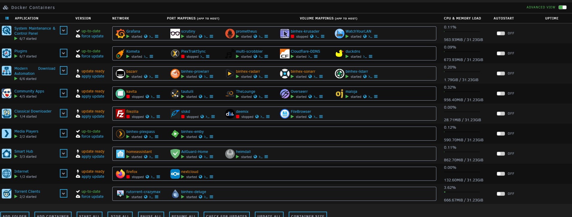

Couldn't start more so what I did is I've disabled AUTOSTART in every docker folder, and made a poweroff procedure.
Right after the system started, I could manually start every docker without any problems.
Even if I click on every folder of my containers to run, the just start properly.

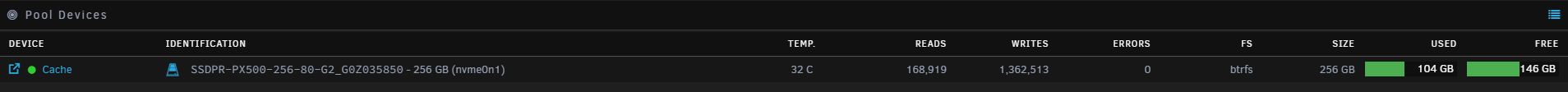

My whole appdata share is on NVME drive. Yes I know its not the fastest one, but still should manage to start docker's even after few minutes right?
Maybe I have something not properly set. Also seems like the "wait" feature doesn't make anything better.

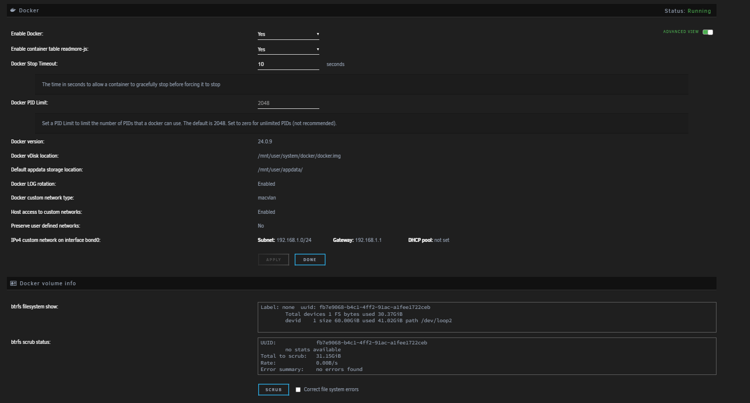

click container size. This sound more like your docker image has been hit. and there is no more free space with due to volume or logs in the other dockers...
You can try running this script with will delete the logs of the first 60 with highest to see if they start after...

and here is my NVME drive where /appdata and /system are stored:
Is there possibility to repair my issue?

OK, I'm still reviewing your diag file...

The images and the shared context indicate that you’re dealing with an Unraid Docker issue where only some containers start on reboot, while others hang with a "Please wait... starting up containers" message. Here are some steps to troubleshoot:

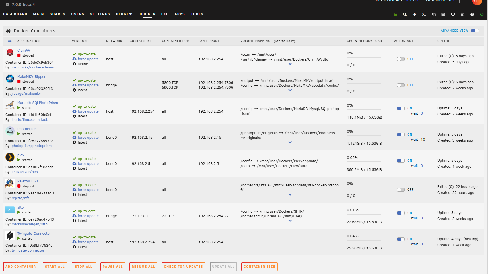

Review:
2. auto start with delay
Docker web ui toggle at top right advance view:
As you can see I'm running a 2 docker system for photoprism mysql and the docker photoprism with autostart there is a wait option. I have set my photo prism to wait 10 sec so mysql is up before photo prism to start.
You can setup your dockers with similar autostart to help initial resource load or fix some start issues.

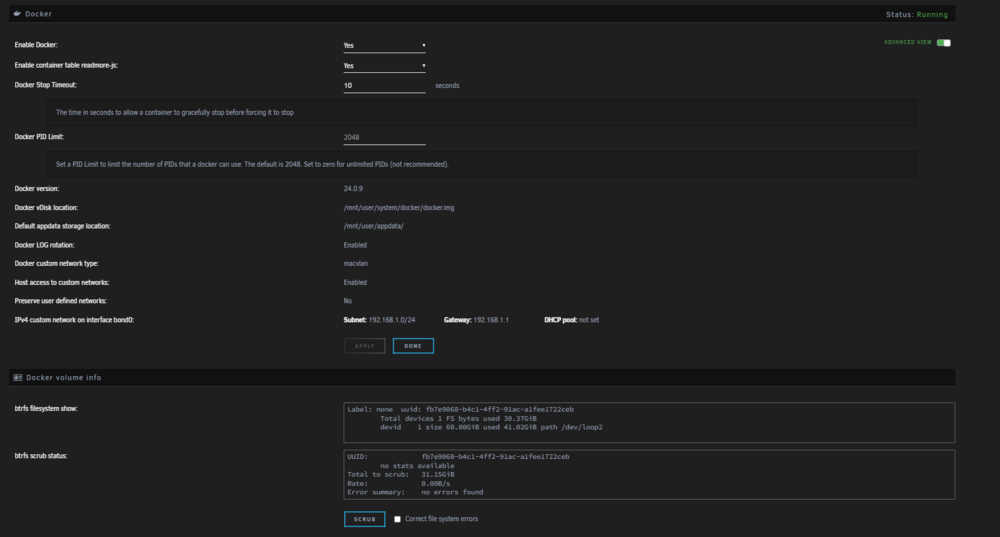

I did not delete my docker.img file. But what I did first is that I checked my btrfs scrub status. Ther were no errors.
Next thing was to add wait variable to my docker. Some of them (small ones) wasn't, some of them are with 5,10,15 and even 30 seconds timeout.
And I must admit, that after stopping DOCKER in settings, and relaunching it; every docker started, as it should. Of course it took longer that usualy - but it works.
So at this moment, when nothing is broken, crashed, there are no errors, I won't change it for now.
BUT if there will be a problem in the future, I know which steps should I take to properly deal with this issue. So for now, I would like to thank You for Your time, explanation, and seems without a doubt, that You have a lot of selfless help and empathy.
