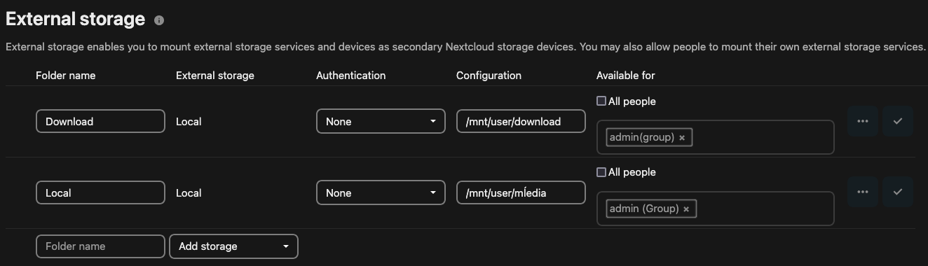

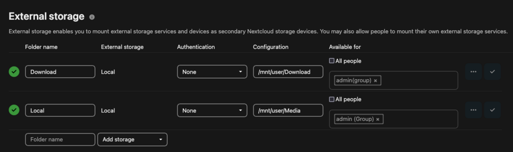

I've managed to get this working today after following the excellent @SpaceInvaderOne tutorial on nextcloud AIO.
Add the variable to the nextcloud-aio-mastercontainer save and apply to the container.

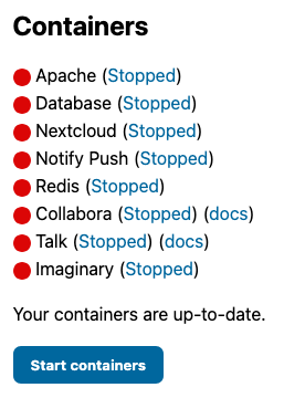

Go to the Nextcloud AIO control page IP:7282 and click stop all containers.
Click start containers.
In nextcloud go to apps and enable "External Storage Support"

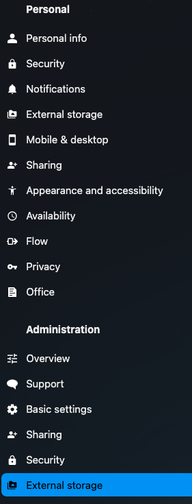

Then go to "Aministration Settings" and select External storage from that lower list. [NOT THE ONE UNDER PERSONAL]

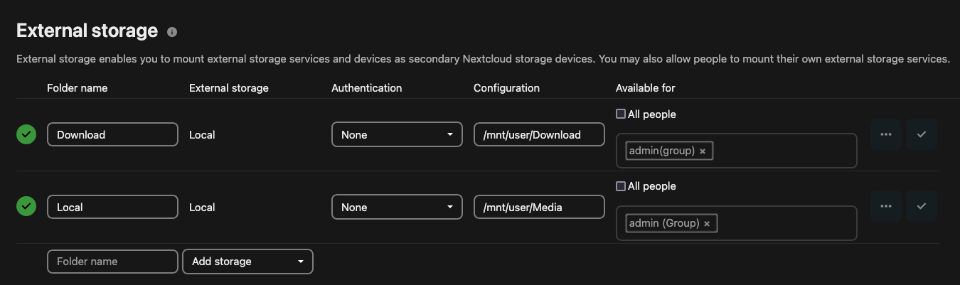

Here you can now configure your local mappings, be sure to click the tick to the far right on each entry.  It will give you a red x if you cant get to the folder.
Green ticks for the win!
I hope this helps someone.

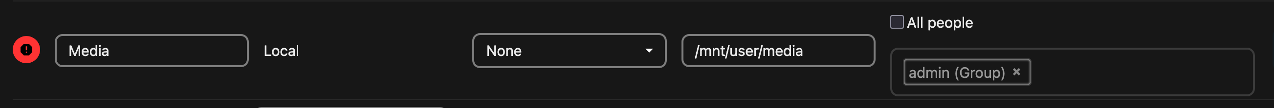

Doesn't work for me, i get a red x bei clicking on the tip.
Error:
Local storage path does not exist "/mnt/user/Share".
Any other tip to get external storage working?

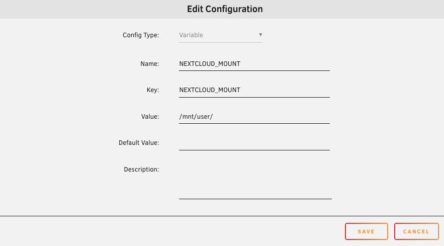

Hi
Double check that your nextcloud master container has the NEXTCLOUD_MOUNT variable set as /mnt/user/
The example of Share is case sensitve.  e.g if you have a share called Media it should be set as /mnt/user/Media under the external storage configuration box.
The variable exists:
Example for a share:
Error:
Other ideas?
Hylli

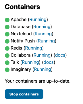

Did you restart all the containers from the AIO admin panel?  If you did have a look here: https://github.com/nextcloud/all-in-one#how-to-allow-the-nextcloud-container-to-access-directories-on-the-host

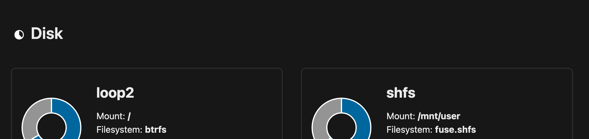

Try going into nextcloud administration and scroll down to the very bottom system tab.
On there it should show you if the share has mounted, mine is showing as SHFS... I wonder if you can see this on yours, if so then I would guess there is a permissions issue that may need dealing with (chmod)
Sorry but I'm clutching at straws here!
Sorry, can't upload screenshots here anymore. Don't know why?
The share is mounted / showing as shfs in the system tab.
I can also see the share directory "Filme" in the file manager, but can't open it.
