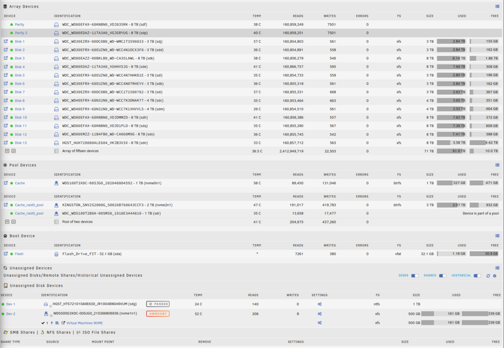

Here's a screenshot of my main page:

Just to add, the docker started fine initially and operated fine for at least 15mins. When it around 7% through doing a parity check it failed.
Cache device dropped offline:
Nov  3 09:51:17 Tower kernel: nvme nvme0: controller is down; will reset: CSTS=0xffffffff, PCI_STATUS=0x10
Nov  3 09:51:17 Tower kernel: nvme nvme0: Does your device have a faulty power saving mode enabled?
Some NVMe devices have issues with power states on Linux, try this, on the main GUI page click on the flash drive, scroll down to "Syslinux Configuration", make sure it's set to "menu view" (top right) and add this to your default boot option, after "append initrd=/bzroot"
nvme_core.default_ps_max_latency_us=0 pcie_aspm=off pcie_port_pm=off
e.g.:
append initrd=/bzroot nvme_core.default_ps_max_latency_us=0 pcie_aspm=off pcie_port_pm=off
Reboot and see if it makes a difference.
