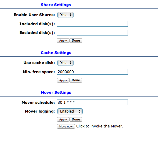

I'm at my wits end. I don't know why a test file I have downloaded to the Cache Drive via Sabnzbd is not being moved. My issue is that I get this error message in the log when the Mover Script on is initialized at the time I set it. Here is what the log states:
Mar  1 01:30:01 Tower logger: mover started
Mar  1 01:30:01 Tower logger: skipping */
Mar  1 01:30:01 Tower logger: mover finished

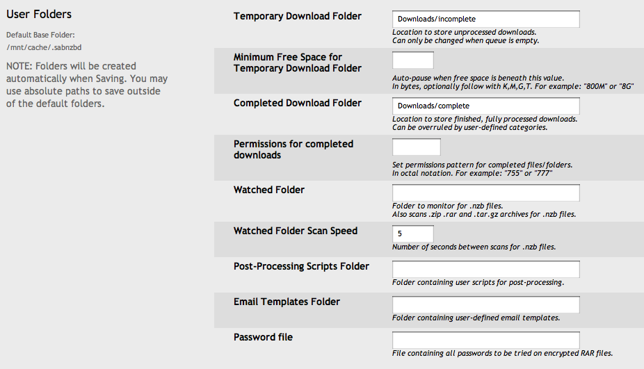

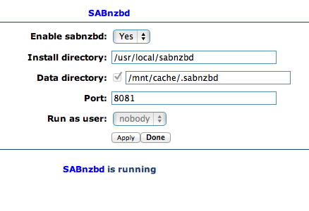

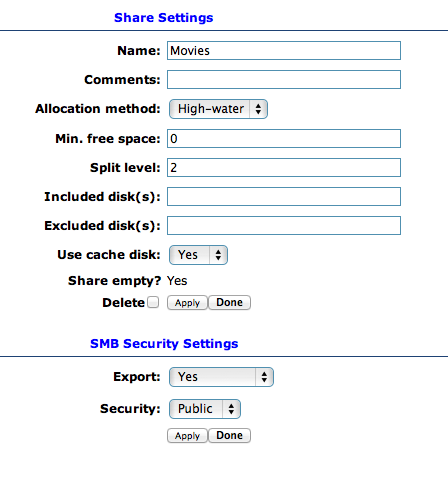

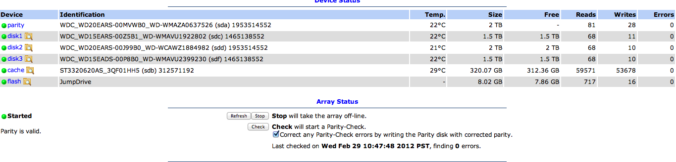

I have followed, or at least I think I have, the directions on how to setup Sabnzbd and the Cache Drive. I have included my syslog, and screenshots of how I have things setup. I'm only using Sabnzbd and don't plan on using SB or CP. I also have only one User Share which is Movies. I haven't enabled  the 'Enabled Movie Sorting' option on Sabnzbd, is that necessary to move the file to the array? My understanding is that the Cache drive looks for the downloaded folder in Sabnzbd and moves whatever is there to the array, more specifically the User Share (in my case Movies). Can anyone help?

Sorry I also wanted to include my Sabnzbd config in the settings section of 5.0b14 and on the app itself. I just want to get this issue solved so I can start enjoying my setup. Thanks.

Mover won't "see" the Downloads folder because the /mnt/cache/.sabnzbd folder is "hidden" to mover (i.e., the period in front of sabnzbd makes it a hidden folder).

Doing this by memory (I'm out of town this week).  On the Sabnzbd "User Folders" page, set the value for "Completed Download Folder" to "/mnt/user/Movies" to point to your Movies share.  Also, set the value for "Permissions for complete downloads" to "755".  After sabnzbd downloads the movie and completes its processing, the movie should end up in the Movies share (note: it may be in a sub-folder with the movie name, just can't remember for sure).

Do I also have to change  /mnt/cache/.sabnzbd  to  /mnt/user/Movies under the 'Data Directory:' in the plugin settings (or in your case cause you're on 4.7) 'complete-dir:' OR just as you stated in the Sabnzbd - Completed Download Folder?
No, that's the install and working folder and you want it to be different than the Movies share and also to have the . so it doesn't move. Well, you could get rid of the . and set-up a sabnzbd share that is cache drive only since you're on the new beta.

In Sabnzbd I kept the download folders as
/mnt/cache/.sabnzbd/Downloads/complete and /mnt/cache/.sabnzbd/Downloads/incomplete

The mover doesn't care what program puts the files into the user share. As long as it gets there then the mover will move it.
