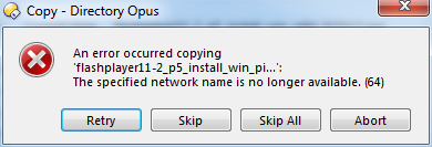

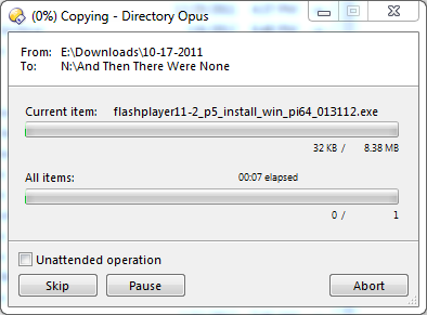

I'm not sure if this is an unRAID issue or an issue with my computer, but I'm hoping someone can point in the right direction if it's not unRAID.  I have 3 computers on the same network as the unRAID box.  Two of them and read and write just fine, but my computer cannot.  It can read (although the reads seem to be slower than on the other systems - around 14 MB/s), but if I try to write something, it waits around 30 seconds and just fails (I'll attach a screen shot of the error).  I think it may be something with my Windows 7 installation because if I boot into my Arch Linux installation on the same machine, I have no problems.  This issue just started a couple days ago.  Before that, I had no problems reading or writing with the win7 installation.  Anything to shed some light on what might be the issue would be greatly appreciated.  Thanks!
P.S. - unRAID is 5.0 beta 14, the other machines that have no problem accessing are both win7.
P.P.S - The first screenshot is what comes up when the transfer first starts, and the second is the error that I get after around 30 seconds.
Sounds like your computer to me, not unraid . What security software are you running ?
I use Microsoft Security Essentials.
How is this computer connected to the network cat cable or wifi? Try to give us as much information as possible. Did you already try to shutdown all computers and servers  on your network? Did you try to ping the machine having problems?
The computer is connected via gigabit Ethernet.  All the computers and the unRAID box have been restarted multiple times.  I can successfully ping this computer from the unRAID box.
I had Micro. Security Essentials too, and I had to remove it.  My second media player was able to connect to my shares.  That's when I had my shares in my W7 PC.  I never installed it back again, and I've never had any issues after that.
Try turning it off and see if that does anything.  Have you tried turning on / off your router?  I had one occasion when power went out.  Everything turn back on after 5 min., but I wasn't able to access my server from any of my computers.  I've got IP's reserved for all my individual gadgets, and for some reason or another everything got erased from my router LAN.  I turned the router off / on and everything came back to normal.
Neither turning off Security Essentials nor restarting the router made any difference, unfortunately.
