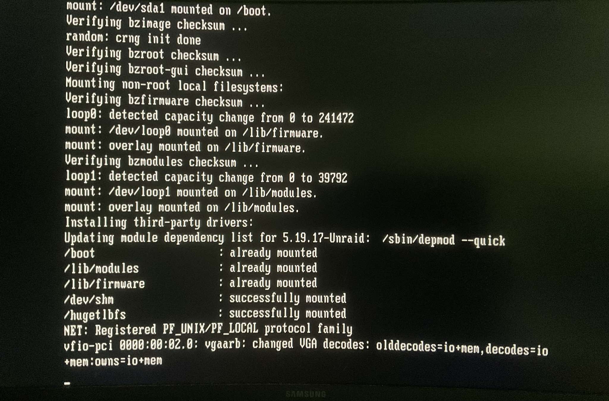

November 3, 20242 yr Author it stuck at this line. I think license is not expired becasue I already buy the license. Edited November 3, 20242 yr by jiro

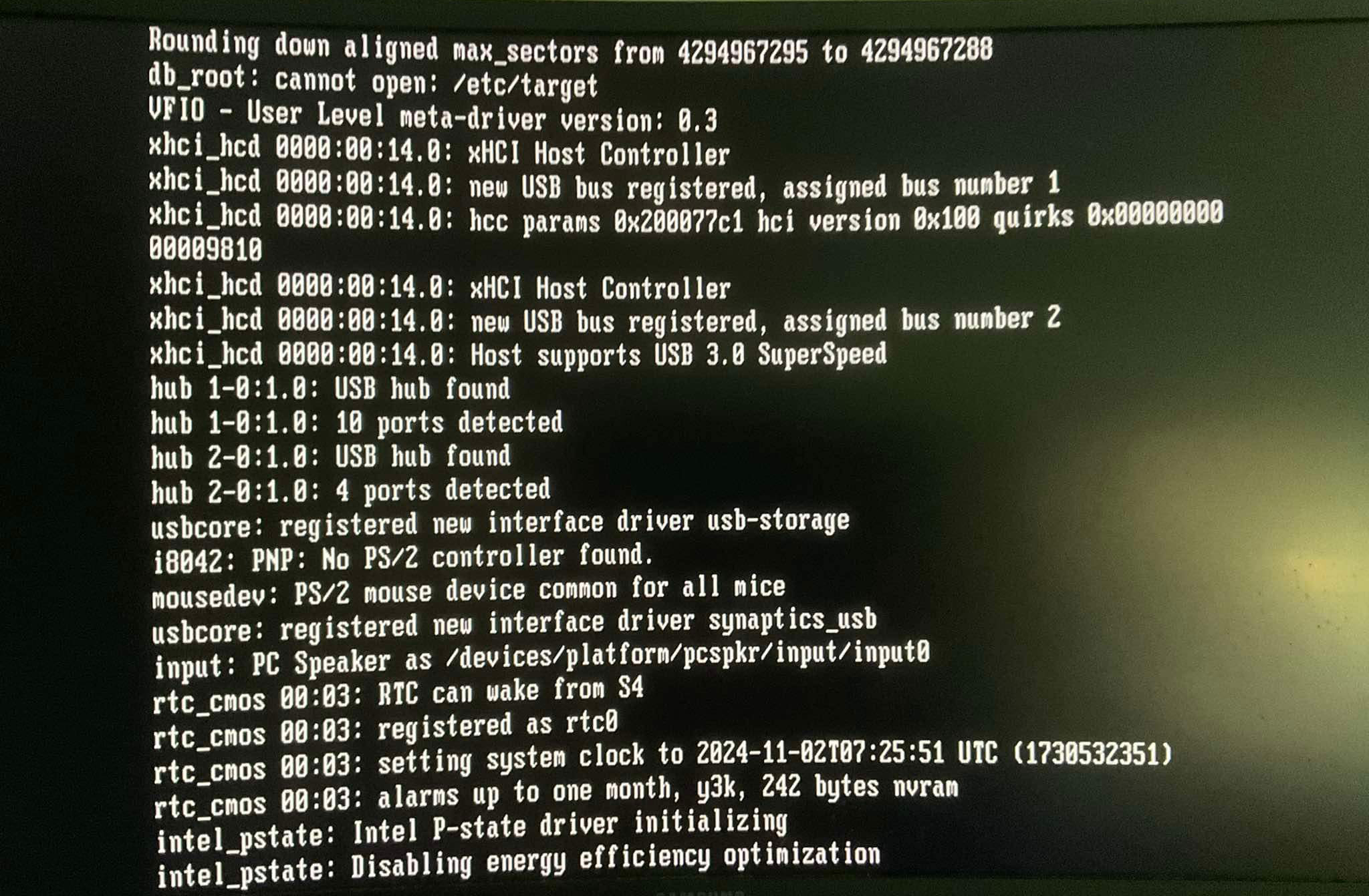

November 3, 20242 yr Author 12 minutes ago, JorgeB said: You can try redoing the flash drive, backup the current one first and then redo it using the USB tool, confirm it boots, and if restore the complete /config folder from the backup and retest, if there are issues again it will be a config problem. Im try method and it also stuck but in different line. Edited November 3, 20242 yr by jiro
November 3, 20242 yr Author 2 minutes ago, JorgeB said: Is this with the stock install or after restoring the backup? everything is working before restore config file. am i understand correctly after install unraid and just replace the new config file with the backup one right?
November 3, 20242 yr 1 minute ago, jiro said: everything is working before restore config file. am i understand correctly after install unraid and just replace the new config file with the backup one right? Looks like you had devices bound to vfio like the igpu hence why details stop on screen. Have a look a vfio-pci.cfg either delete or remove entries. It is in /boot/config

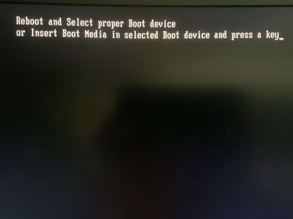

November 3, 20242 yr Author 8 minutes ago, JorgeB said: Yes, but that confirms there's a config problem, try deleting /config/vfio-pci.cfg this is after detete vfio-pci.cfg.

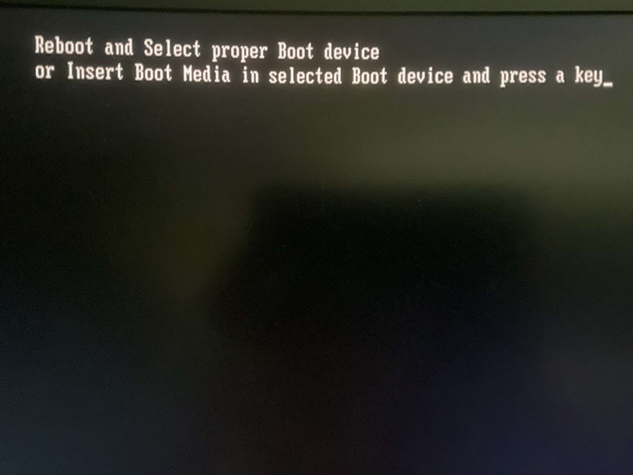

November 3, 20242 yr Select proper boot device as it says. It isn't even trying to boot your Unraid flash drive.
November 3, 20242 yr Author 3 minutes ago, trurl said: Select proper boot device as it says. It isn't even trying to boot your Unraid flash drive. im already try to fix it in bio and everything is already set correctly im so confuse.
