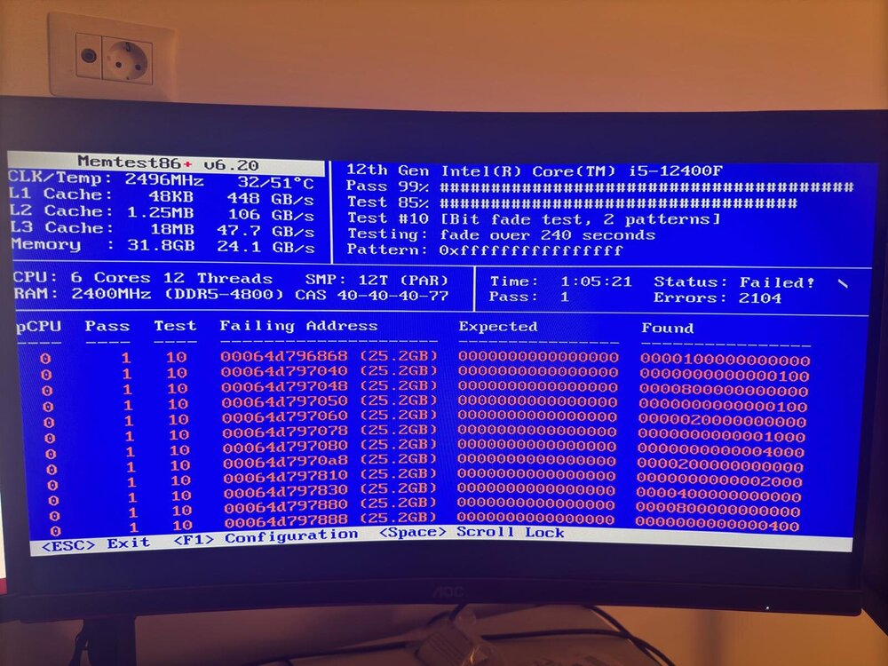

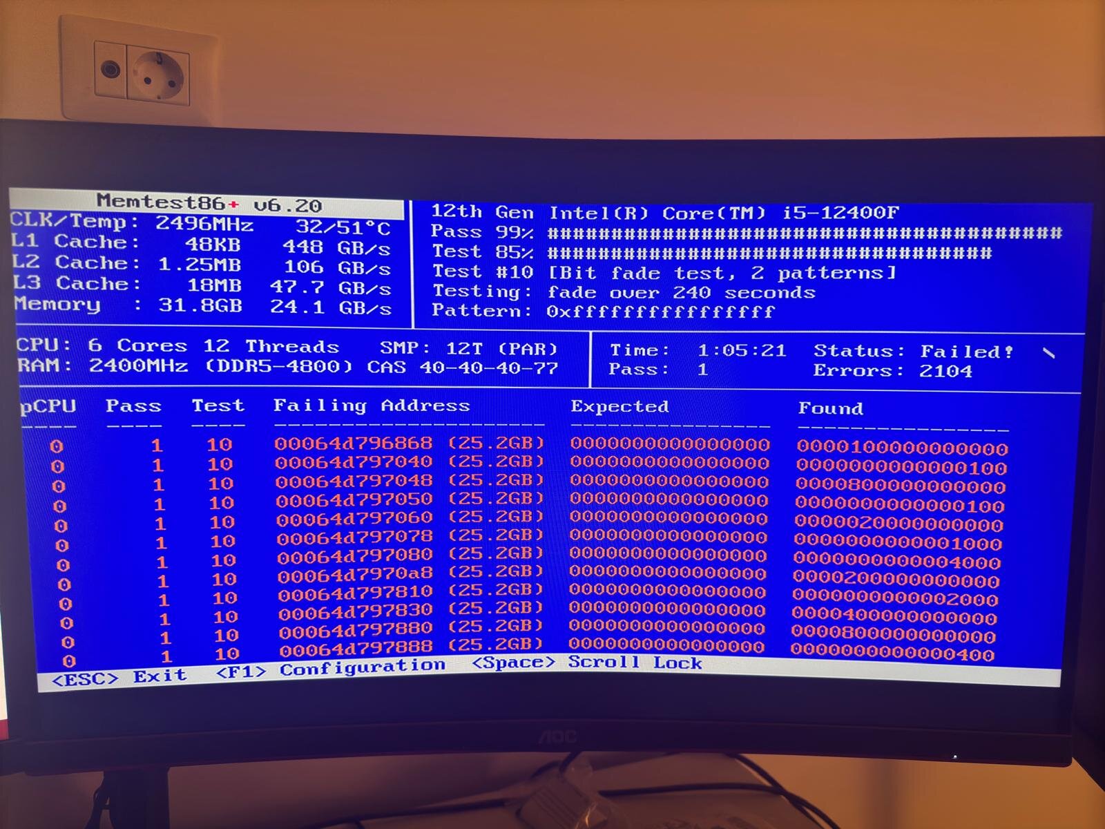

I ran memtest and received many errors from the last test (bit fade test, 2 patterns - see the attached screenshot).
The Corsair DDR5 RAM has a lifetime warranty, so I sent them back for replacement.

If I remember correctly - since this was a year ago - I left Memtest running for an hour or so, and only then some errors started showing up.
So, run it multiple times in a row, not only once.
