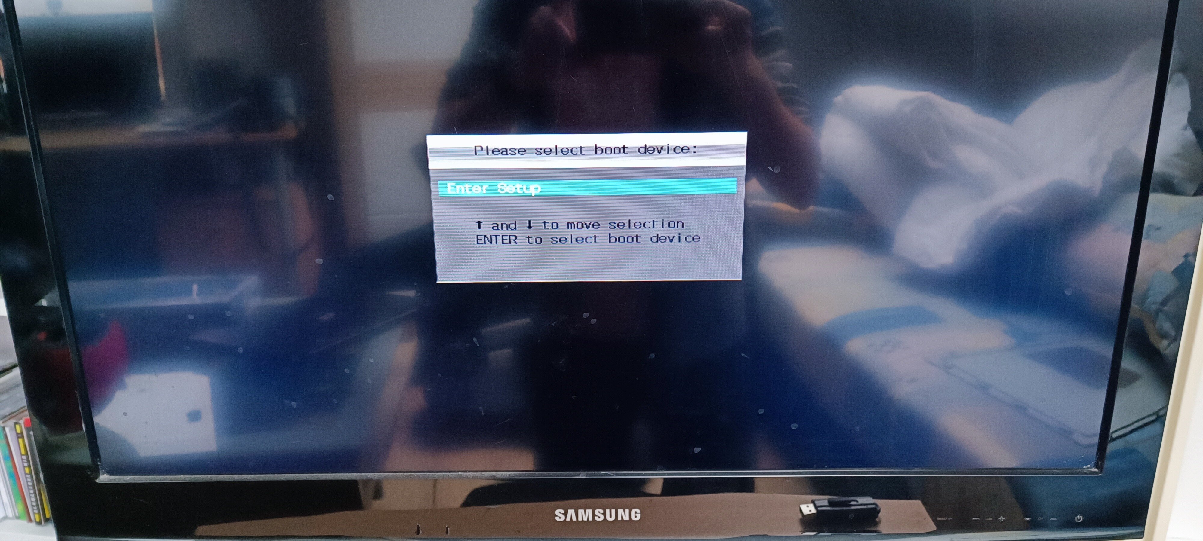

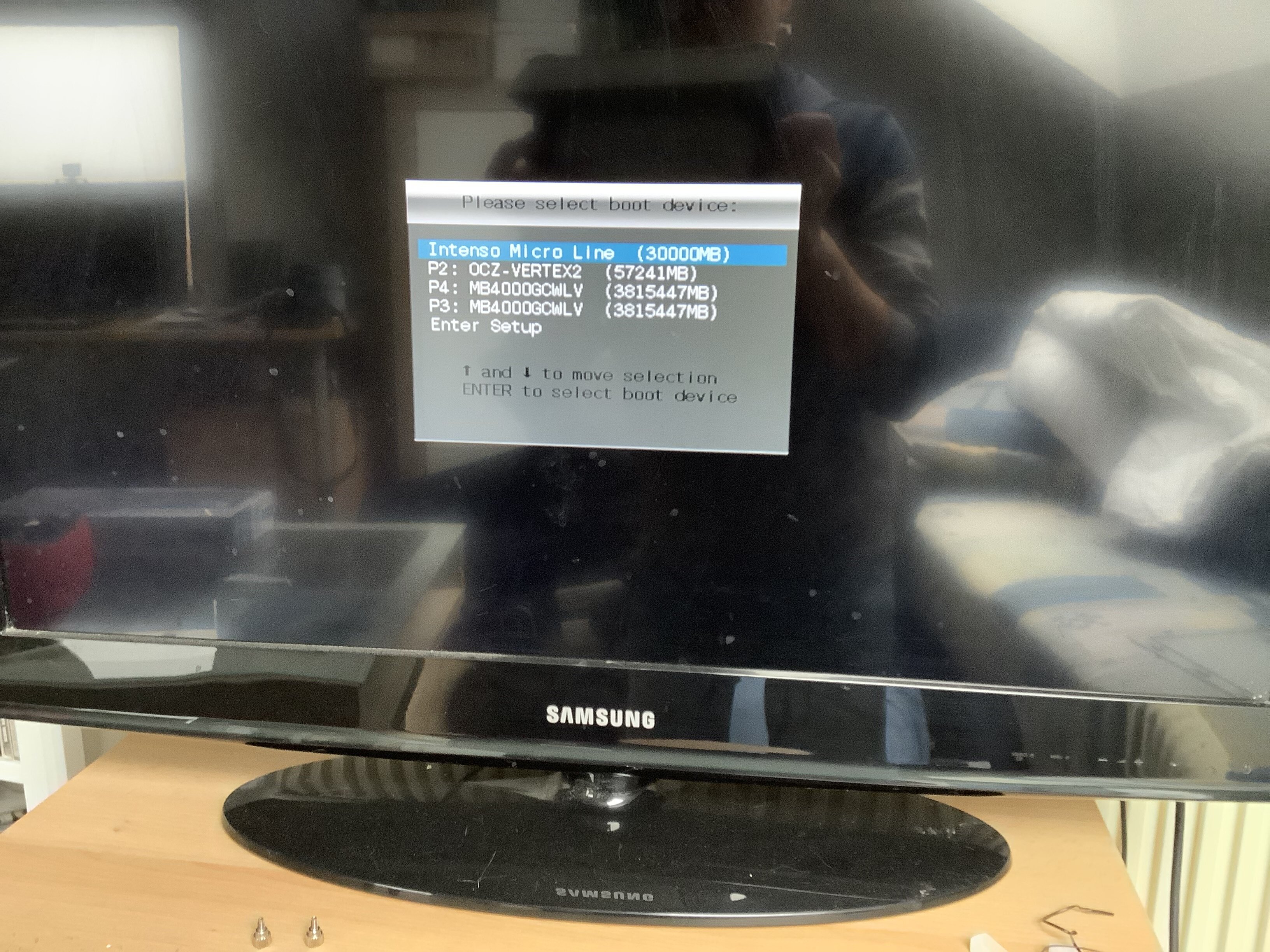

Post a photo from the boot menu (press F8 during post)
Boot menu looks like this

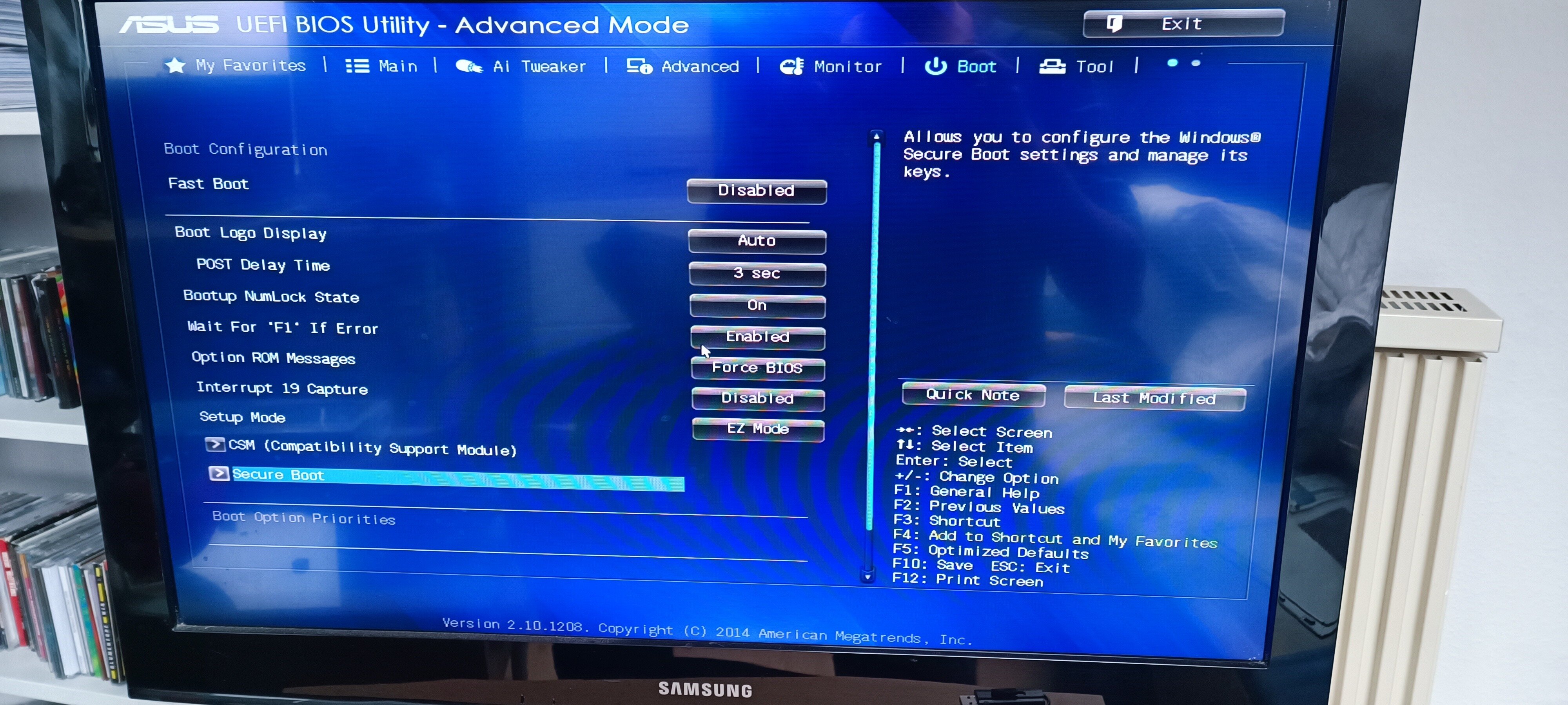

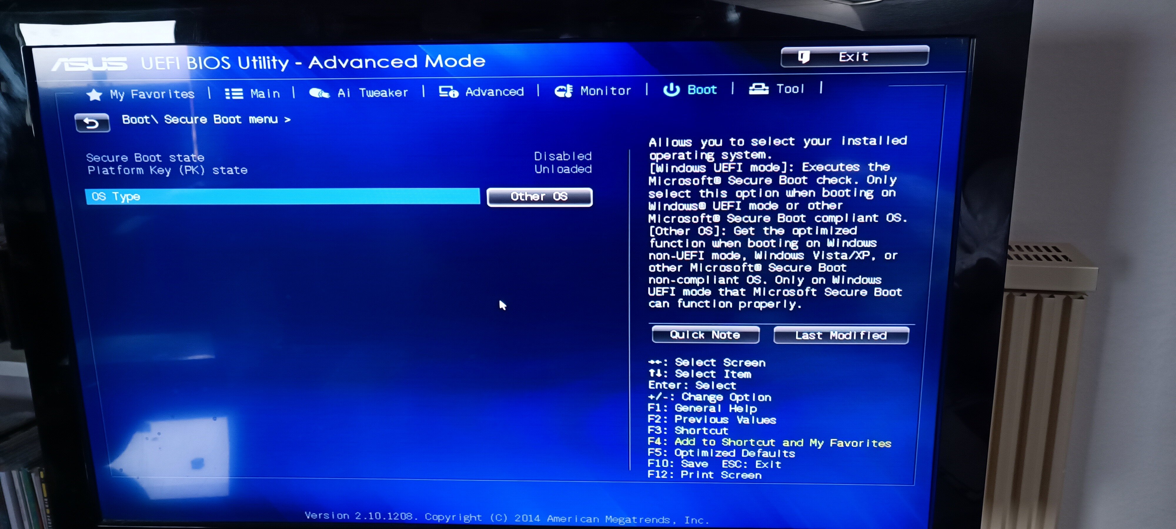

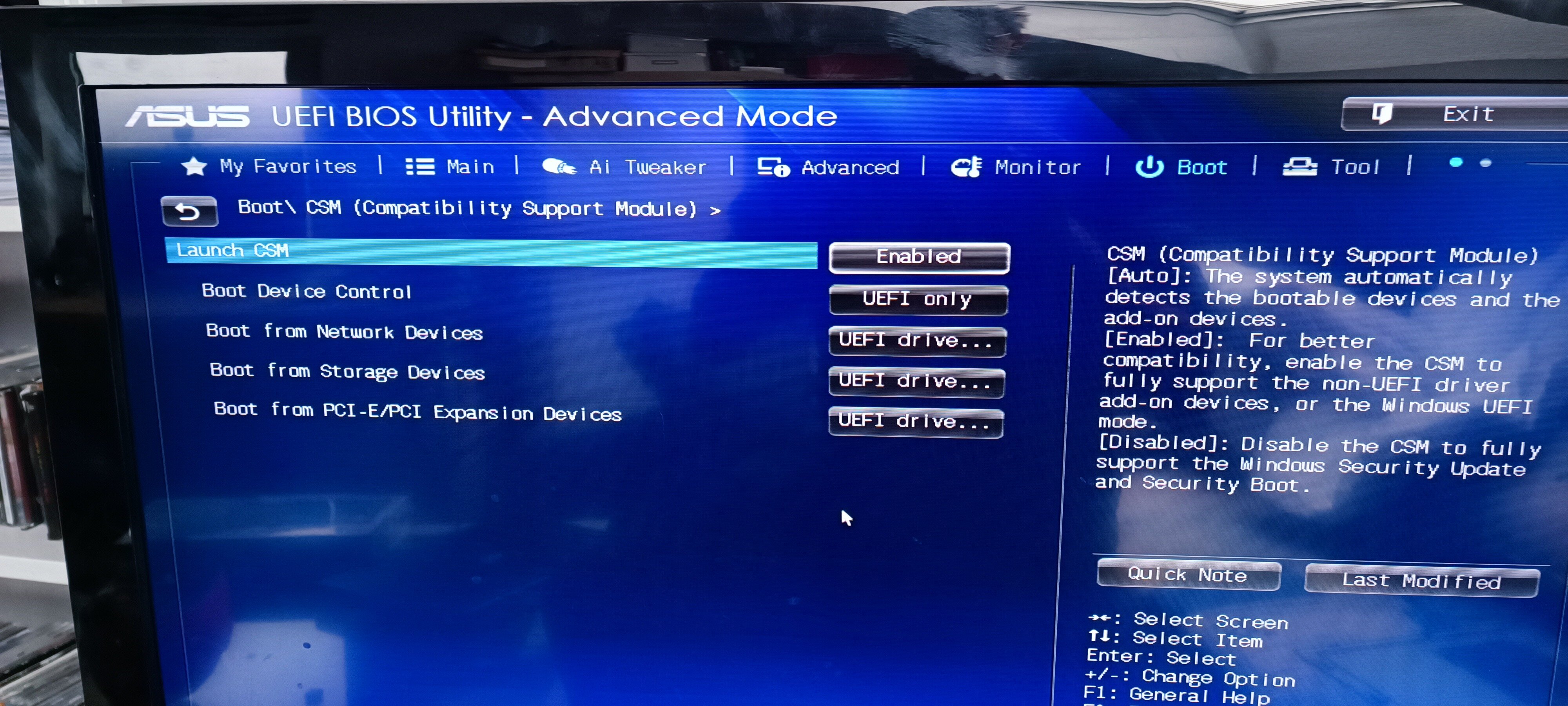

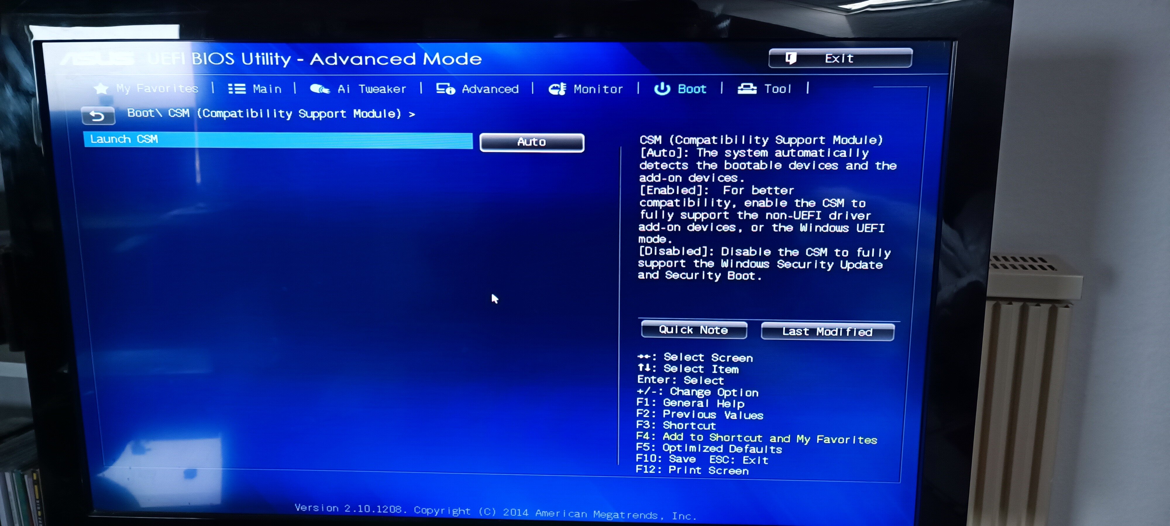

There's no UEFI option, make sure UEFI boot is enabled in the board BIOS, and that a folder named EFI (not EFI-) exists on the flash drive.

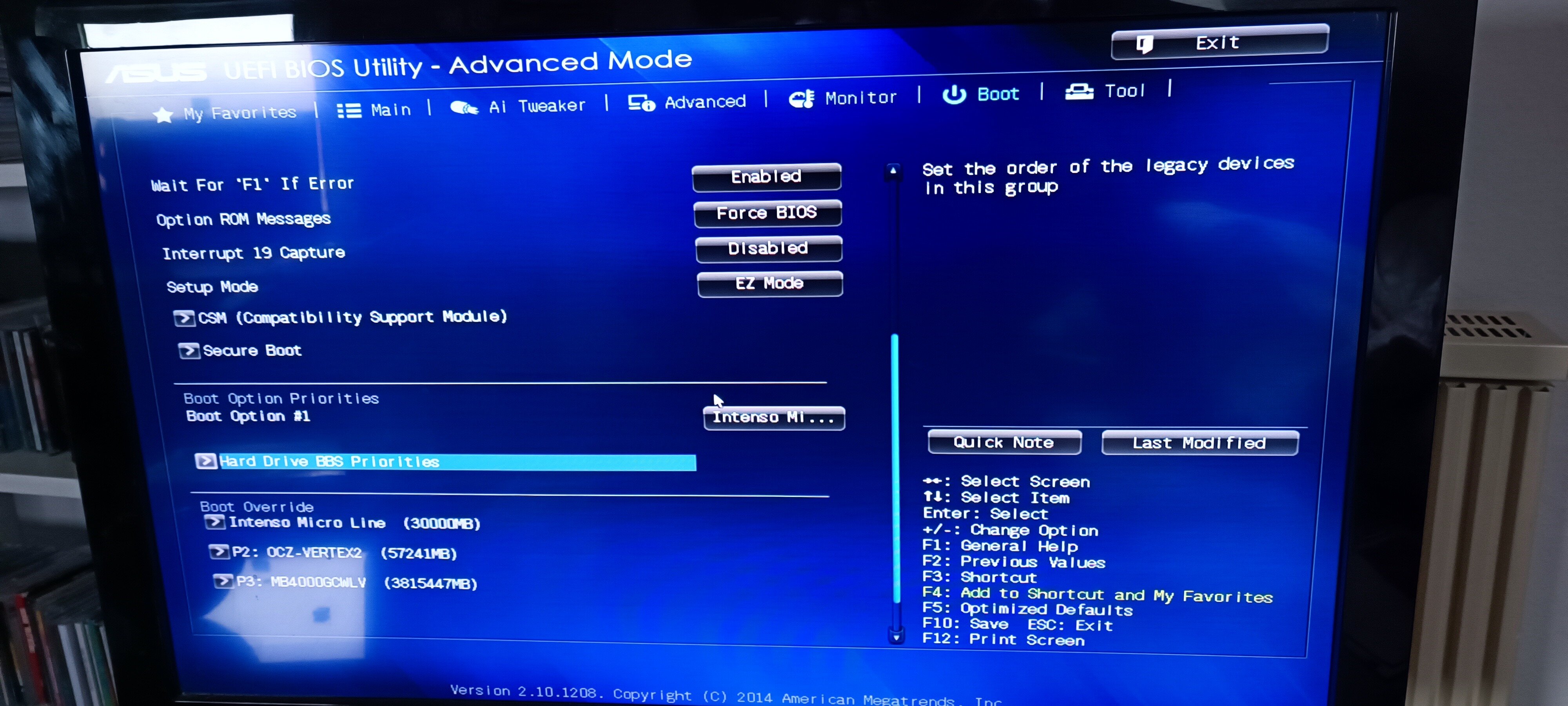

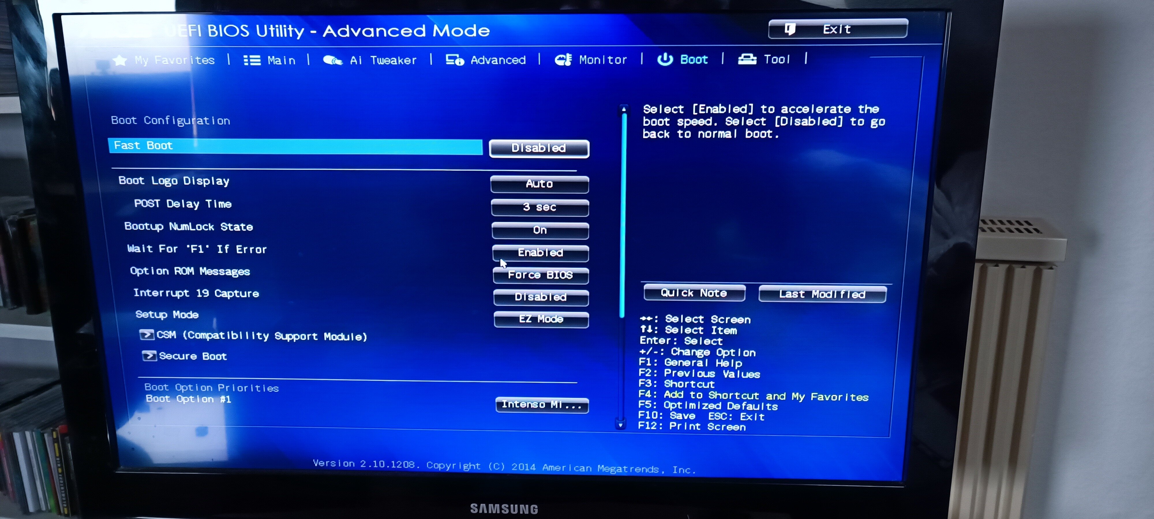

To me it looks like UEFI is enabled, but now I don’t see anything in the boot menu.
The EFI folder is present on the stick.
Edited by Skyways016

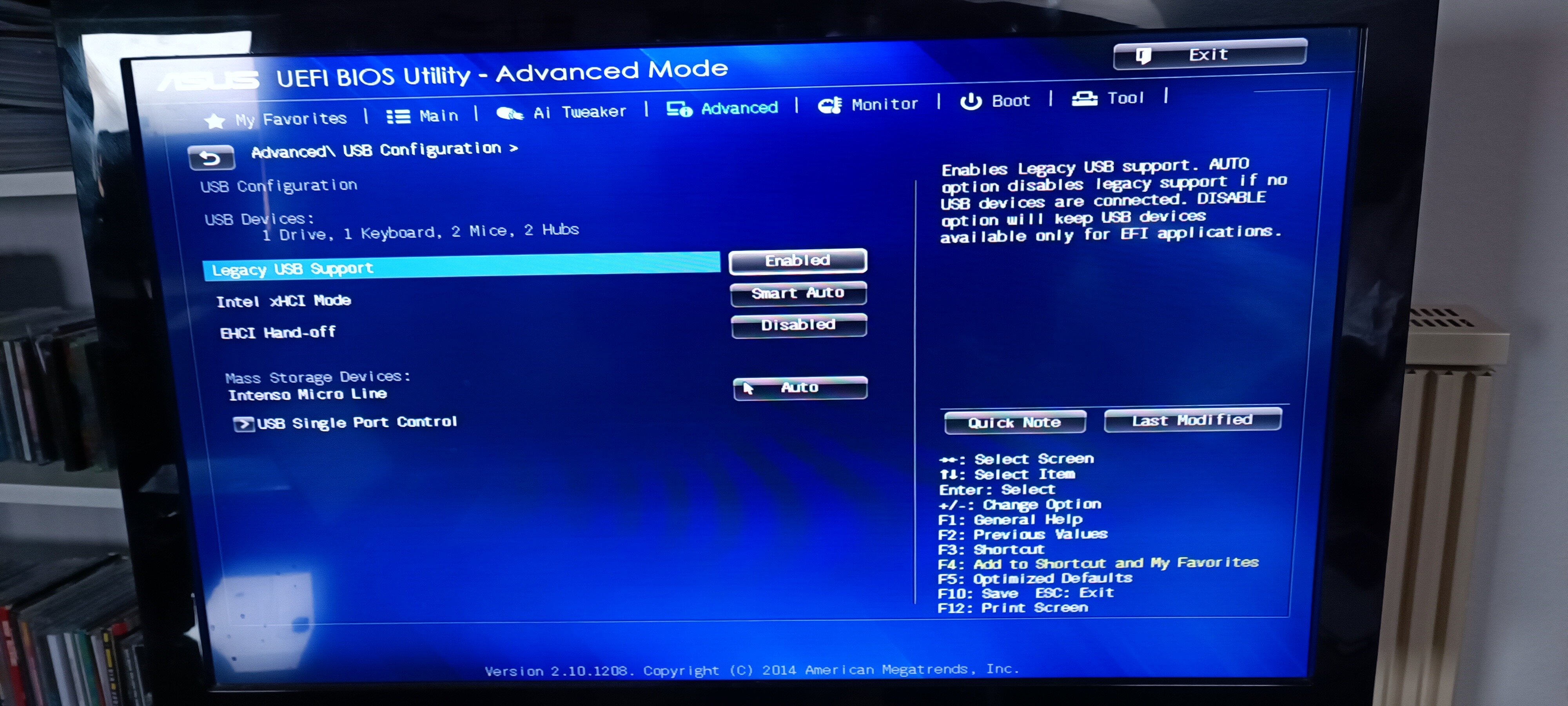

If the flash drive is correctly created and an EFI folder exists, one of the boot options should be "UEFI: Intenso Micro Line", look for a BIOS update in case it's broken, or try booting legacy.

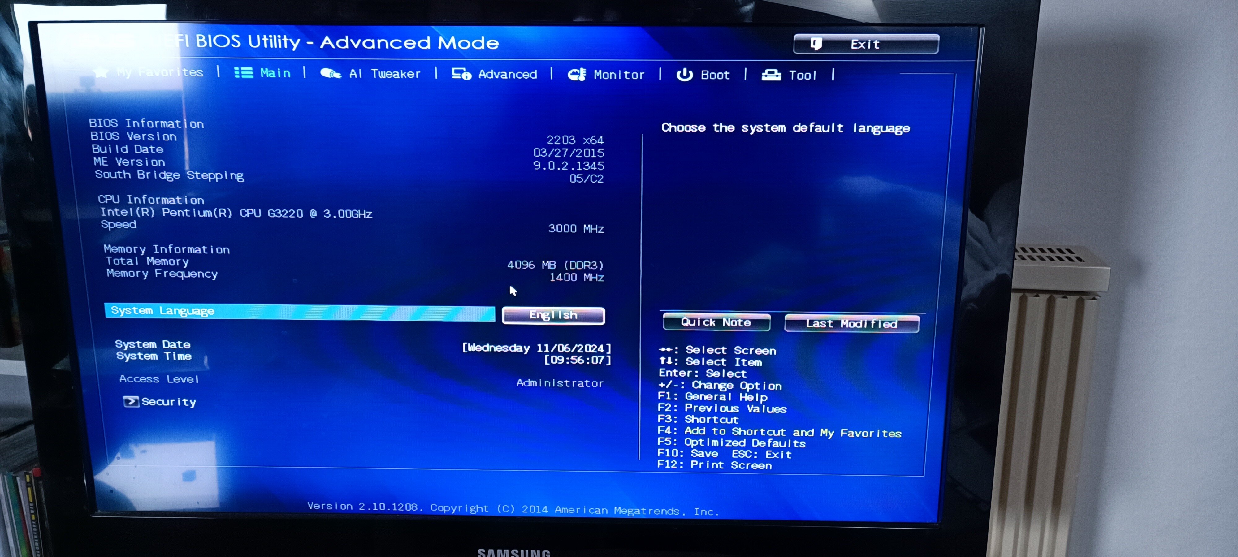

Finally found a solution, while reinstalling the bios I realized that the stick I used for the new bios file showed me the uefi option. I installed unraid on this usb 3 stick and finally was able to boot it from there.
