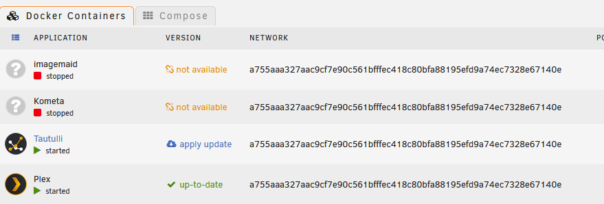

G'day all,
I've had this issue every since I tried out Portainer a few years back.
For some reason ever since then my network interface name for all of my dockers shows has the UID instead of the name that's set in the docker-compose file which is 'eth1.2'
I remember deep diving into the docker config files on /boot/ back when it happened but could never find the fix.
I think this also might be causing my dockers to not auto start after a reboot/dirty shutdown due to the UID changing. I have to compose down them all then bring them back up for them to all work.
