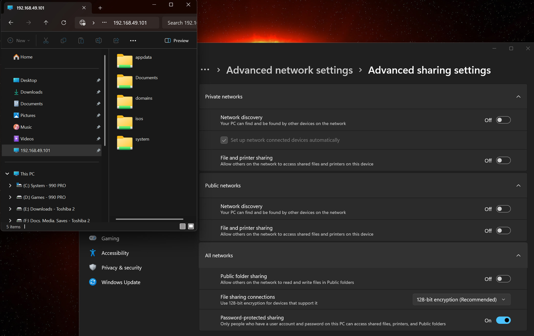

Well I've managed to get the shares visible now. I still get the banner when on the explorer > network location, but if I click on the desktop shortcut or the pinned quick access item I can see the shares.
In case it helps anybody:
To get it to work I had to:
-Enable all file and printer sharing rules in my firewall (MWB windows firewall control) - some of them were disabled
-Set network properties to private under settings > network & internet > properties
-Start unraid array
-Create the user in unraid and set password
-Add the IP address of the server, and set the username and password the same as the unraid user (in credential manager > windows credentials > add new credential)
-Right click on desktop > new shortcut > \\IP of server > name: tower
-Right click on tower desktop icon > pin to quick access (some reason it shows it as the IP rather than tower, but that'll do)
I didn't need to:
-Turn on network discovery or file & printer sharing under settings > network & internet > advanced network settings > advanced sharing settings
-Change any windows services
-Add SMB 1.0/CIFS under turn windows features on/off
-Change any registry or group policy items
If I start my array, I can now see the shares via one of the links, even though network discovery / file & printer settings are off. Not sure if this is expected behavior but it's working.
