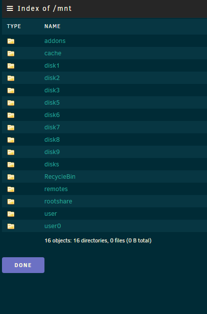

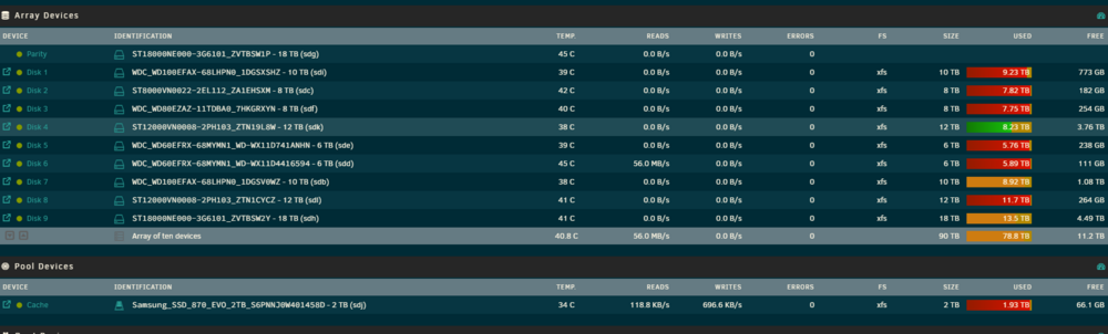

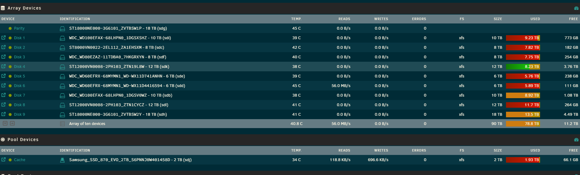

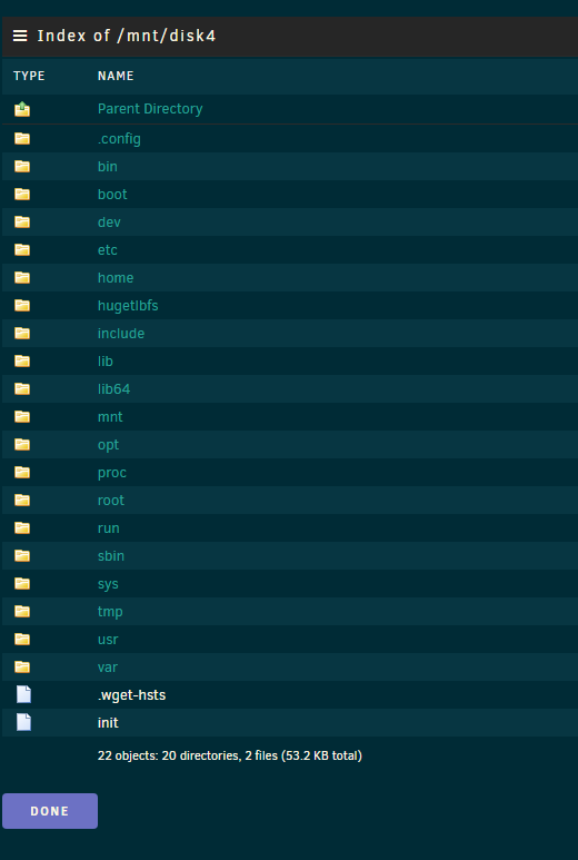

Hello,
I noticed some files going missing on my shares and also on plex, i looked into the system and say that disk4 is mounted however i am unable to access any of the files and it seems mover has not moved anything to the disk in a while as it has a lot more space then the other drives. Mover also isnt working now and things are only being added to the cache but not off it, i run a parity check with 400errors that were corrected but i have a feeling that isnt what is going on, i have tried to restart the system with no change. i run a xfs_repair -n /dev/sdk1 and got a bunch of error read out was able to fix the errors with xfs_repair /dev/sdk1

There appears to still be issues with that filesystem, check filesystem on disk4 using the GUI, run it without -n

thanks i tried that and it didnt work so i went through cli, i did it a couple times then ran after with -n. i ran a extended smart test took around 16hours+ just finished this morning, after running that test I run xfs repair and currently it seems to be working, i also removed everything from the lost and found, thinking maybe there was a weird file or something not even sure if that makes sense, however as of right now its been working for maybe 2 hours - currently mover is moving stuff on that drive, after mover is done, i will run another parity check.
