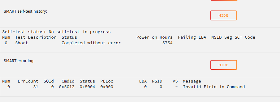

I've run SMART self-test on the cache drive and no issues found, although I noticed error count of 31, but no further information... image.png.dcb4c91697a3a1e986b95fc8e476827a.png
Run a correcting scrub on the pool and post the results.

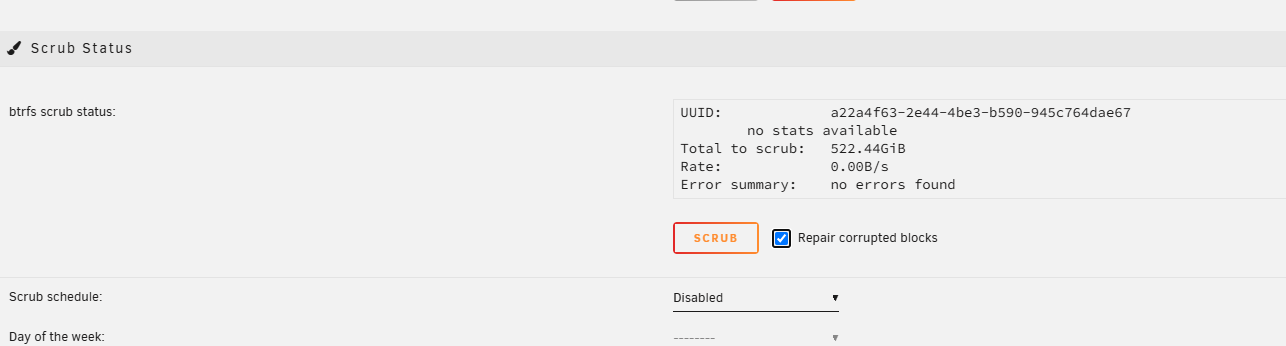

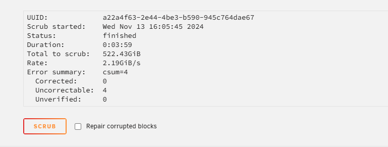

I just want to check before running... is this right? Just click scrub with 'repair corrupted blocks' selected?image.thumb.png.f9f9127e098458e304dbef58263c37fd.png
Yep

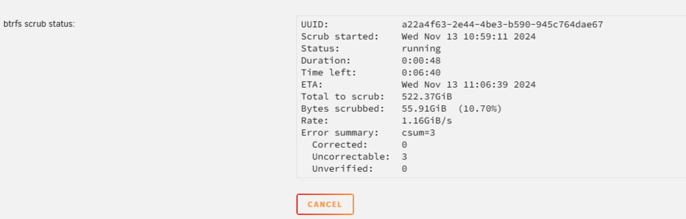

I've started the process 3 times now. First time it stopped after 600MB, I left it overnight in case it's a super long running process, but it didn't progress. Had to hard reboot the server as unraid wasn't responsive. Just run it again and it stopped at 10% with the following... image.thumb.png.d0ab7b94299ea8d2922e53e353f4f03e.png

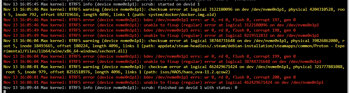

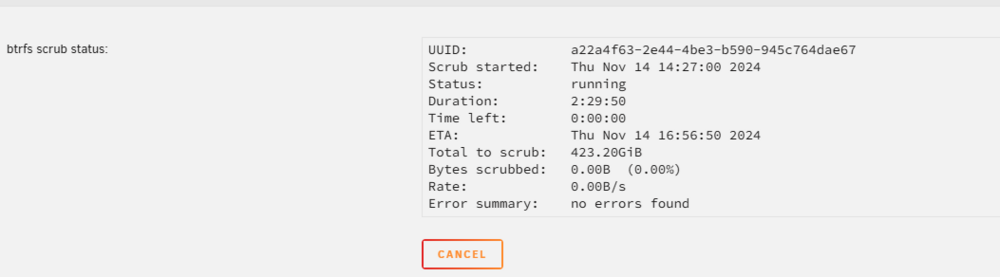

Retried several times and it finally finished.
I think there was an issue with docker or VMs flooding the network. After starting the array I was noticing network issues (other devices losing network/internet). Unplugging the unraid server from the switch solved it instantly. It only happened after the array so I assume it was docker or a VM. So I suspect the scrub may have been finishing in the background but the network issues were causing the UI and ssh to become unresponsive. The above was after I disabled docker and VMs and ran it again. Seems stable with the array started but no dockers/VMs for now.

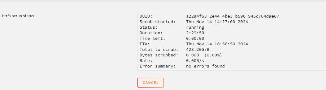

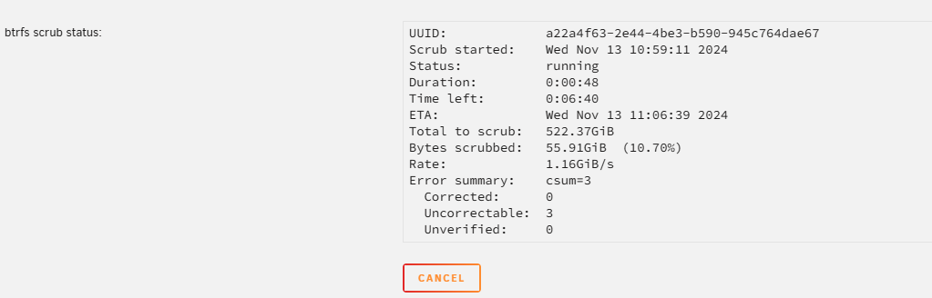

Ok, I've deleted all the mentioned files. Rerunning the scrub, it seems to be stuck doing nothing... image.thumb.png.bbb745c5078954324ddefc52dfbe0099.png
I've hit cancel, shows up in logs but doesn't seem to cancel.

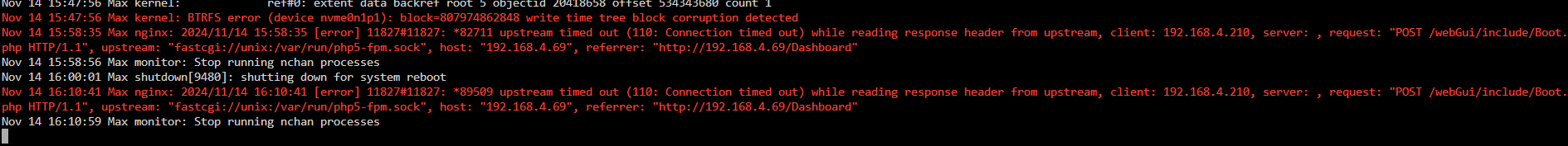

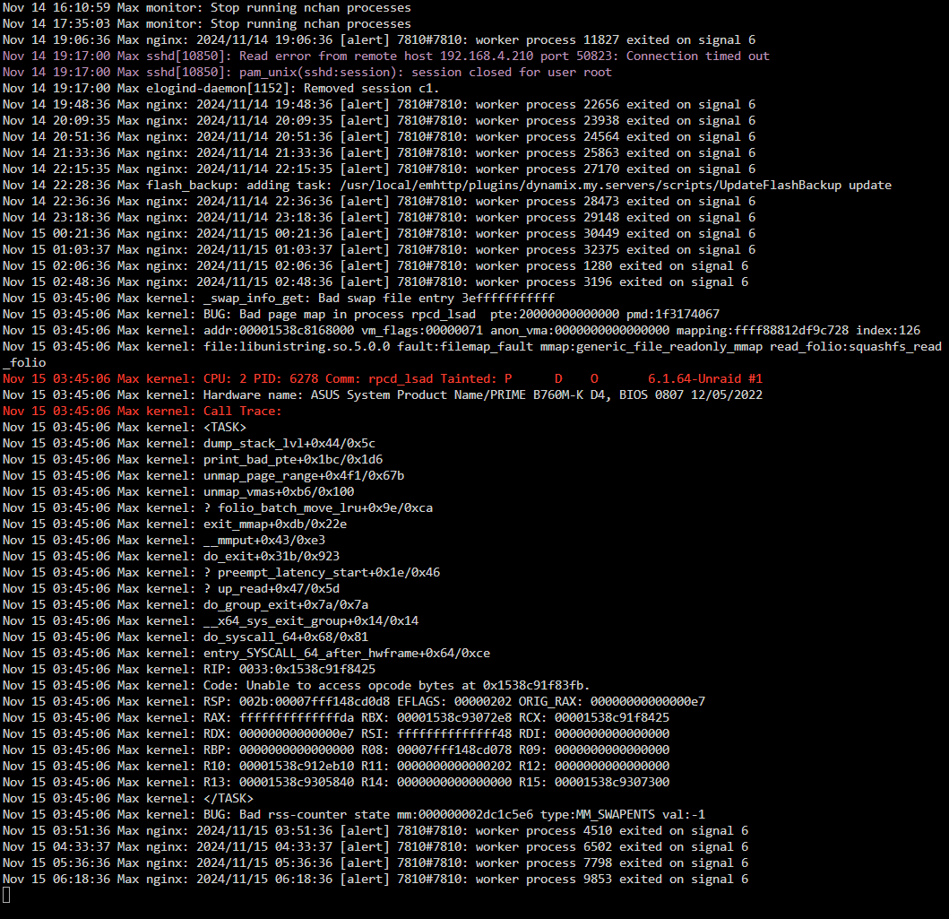

I left it running overnight and got this in the logs, if it helps... image.thumb.png.ff4229370a61df90bb69d7d19020c25f.png
