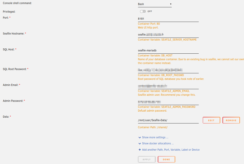

I have a seafile (cloud solution like nextcloud) docker running a my server, with this configuration :
Problem is, the "Data" folder is an all-in-one solution that doesn't separate configs files and logs from the actual data.

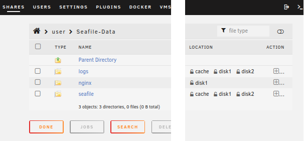

This is how the folders are inside the share :

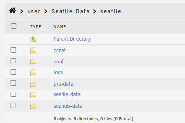

Most of the config and log files are written in the "seafile" folder
How should I proceed?
I just have to create a new path route for /shared/logs & /shared/nginx & /shared/seafile/conf & /shared/seafile/logs to a new cache only share like appdata? And the same for the other folder? It seems to be a lot of work just to split paths...
