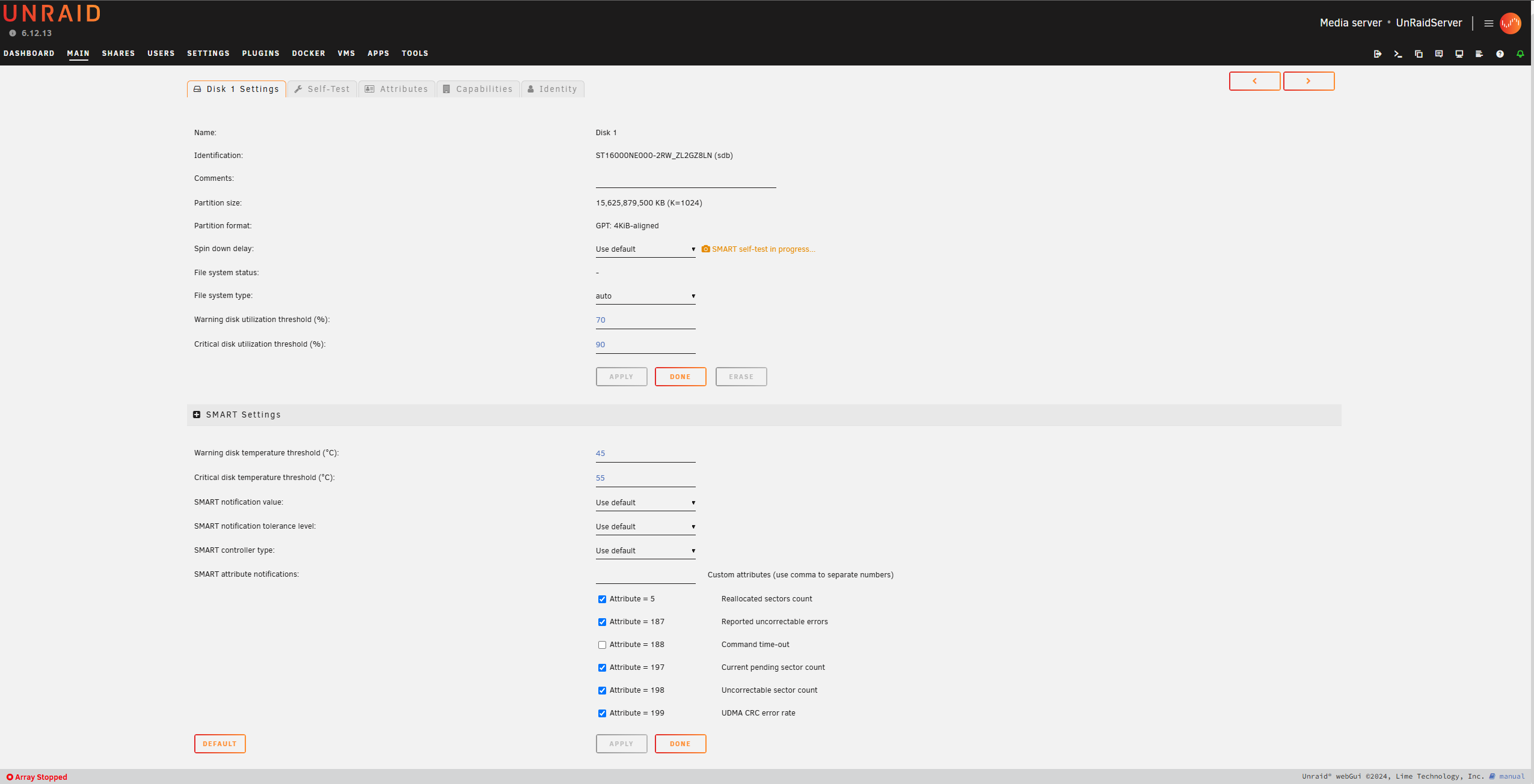

Step 4.) is where I can't do what is described. I can't check for a file system status, and it appears that UnRaid doesn't know what filesystem was being used. I've followed these steps with the Array stopped, started normally, and started in Maintenance Mode. I'm unsure if this is because I don't have a parity drive, since my Array consists of just one drive.

For the sake of troubleshooting, I started UnRaid baremetal. And I get the same results, where I can't do what the manual tells me to do:
What I see when I go to Main -> Disk1: https://i.gyazo.com/621f647772e118c5fb852dc396bf4cd3.png
I don't see anything about checking the filesystem status (again, no difference if array is not started, started normally, or started in Maintenance Mode. Not sure if that's supposed to make a difference here already).
