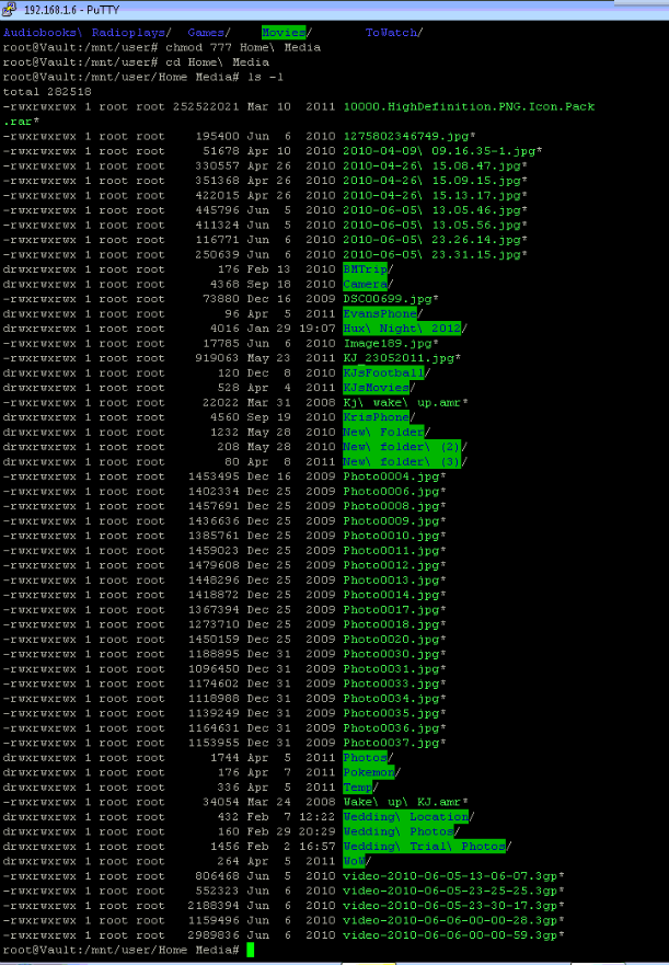

Doing just chmod will do the file or folder in question. to do all files in a directory you have to do chmod -R
if you post the output of ls -l on some of the files in question it would shed some light on what's going on as well
Thanks for the help Influencer, sorry i forgot to mention that i looked up the command for doing a recursive chmod and found that i needed to add -R so i have already done that.
I have attached a screenshot of my telnet session with all the files for the directory using ls -l as you asked.

Hey guys thanks for all your help! I have fixed the problem.
The link dgaschk posted showing how permissions fully worked helped, it seemed the problem was that I had somehow made the files hidden, and when i did chmod -R 777 it hadnt fixed the issue because the hidden property was still active.
Once i did a chmod 770 the problem was fixed.
