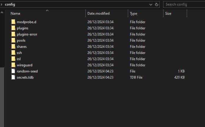

Looking in the usb drive, it does not seem like the usb creator tool has properly setup the drive?
its missing all the plugins from backup and none of the .cfg files has been copied over?
Flash drive is missing files, including the go file, create a stock install then restore the config  folder with the files you have, will likely still need to reconfigure some stuff
