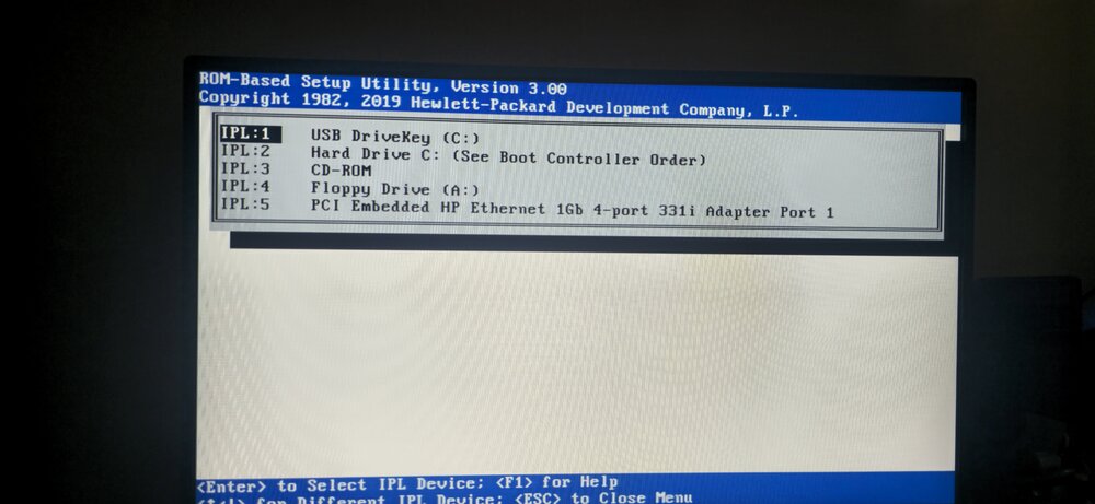

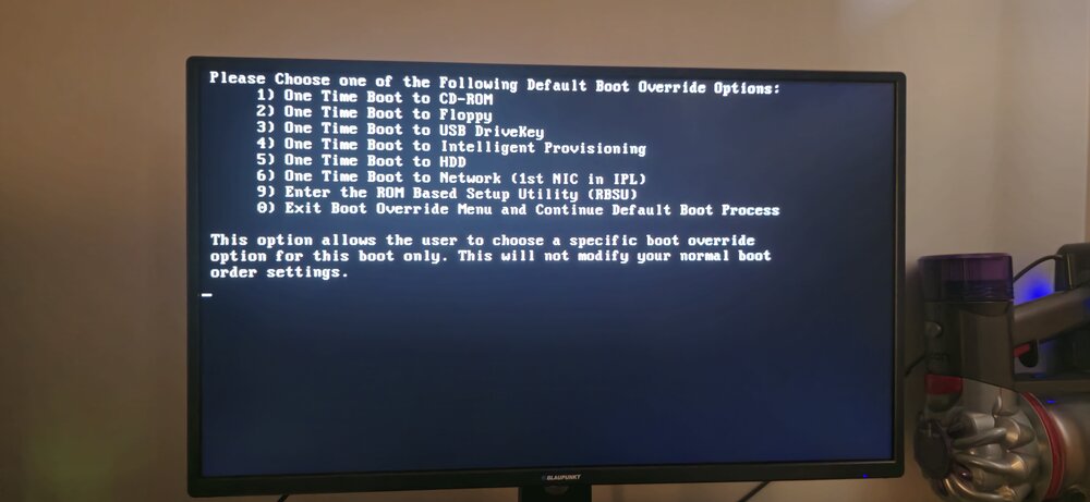

Post a photo showing the boot menu options.

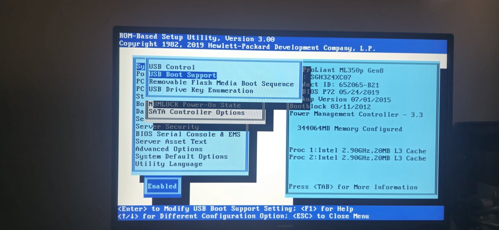

PSA below. It all looks right to me, I'm really not sure. I have seen secure boot needs to be off however I cannot find that option.
Edited by BooM141
Looks like there's no UEFI support yet, try booting that flash drive in a different PC to confirm it's booting, and make sure you are booting legacy, it may boot UEFI and not legacy.

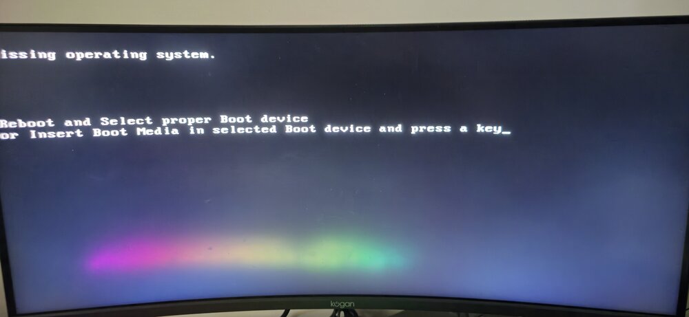

I attempted to boot from the USB on my main rig and this is the error I get. I re ran make bootable.bat and the issue persists

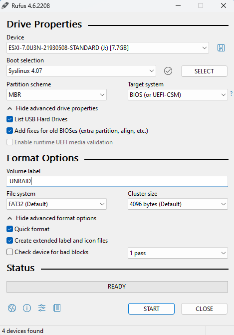

Solved, use manual method. Created a bootable USB using rufus. PSA below for the options used
