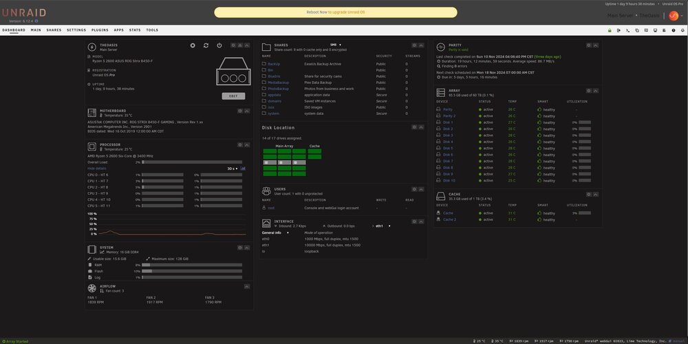

November 11, 20241 yr So I ran into a weird problem. My Unraid OS is 6.12.4 with 12 disks (2 parity and 10 data). When I rebooted after upgrading to 6.12.13 more than half my drives were not recognized and my array was offline. I shutdown the server and restarted it with no change. So I rolled the OS back to 6.12.4 and all drives were working, show healthy/green with the array working fine. I did do the Upgrade Assistant prior to upgrading and that was good. Lastly, before downgrading I did the diagnostic download for Unraid to look at but thought I'd post here to see if anyone has ideas.

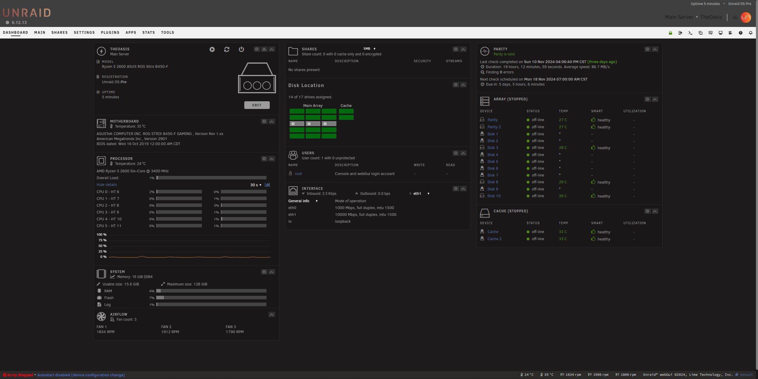

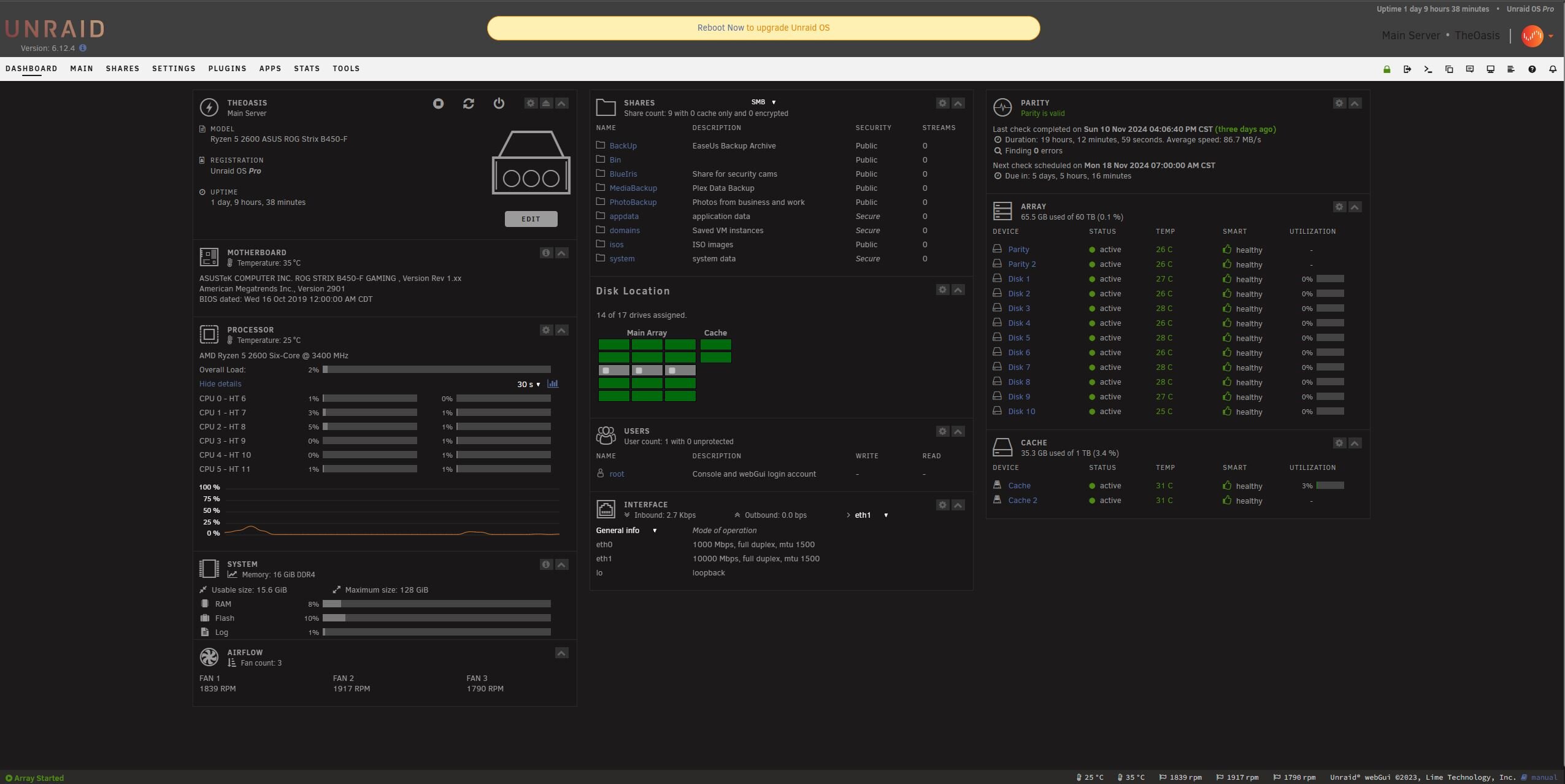

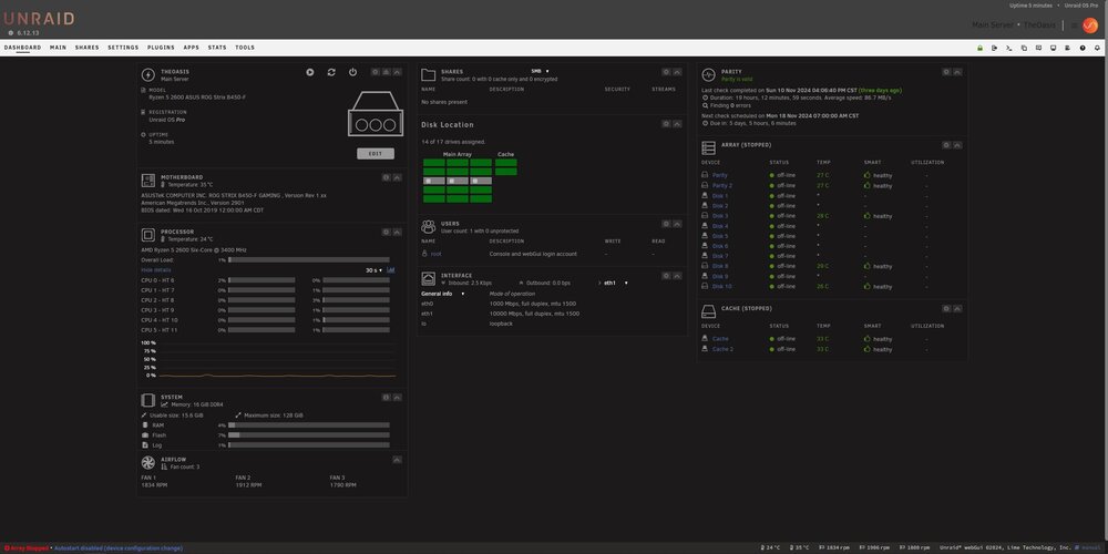

November 13, 20241 yr Author Ok, did the upgrade and same result. Attaching the diagnostics and I did screenshot of my dashboard on both. theoasis-diagnostics-20241113-0154.zip
