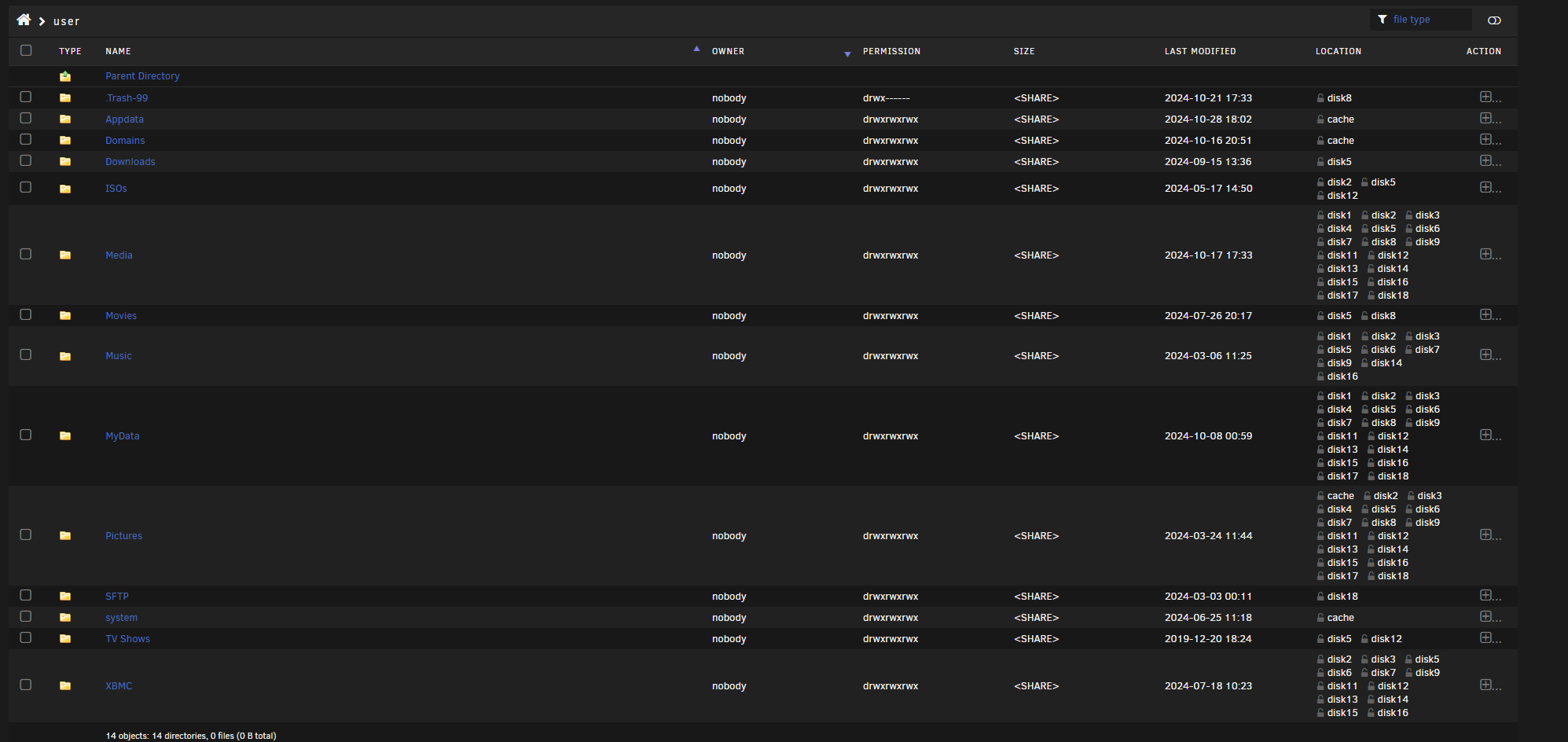

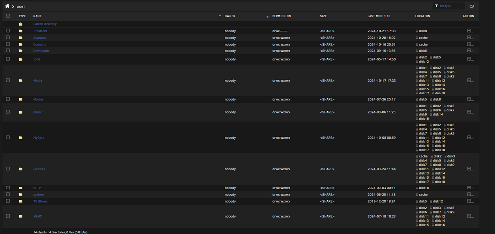

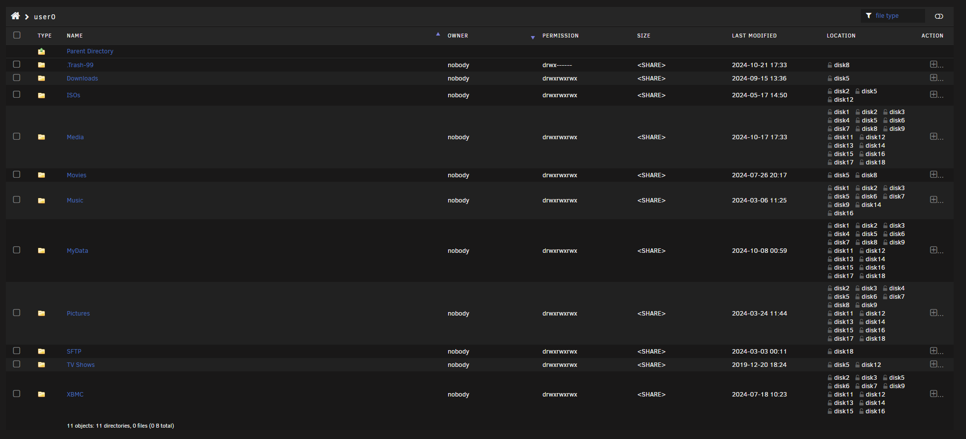

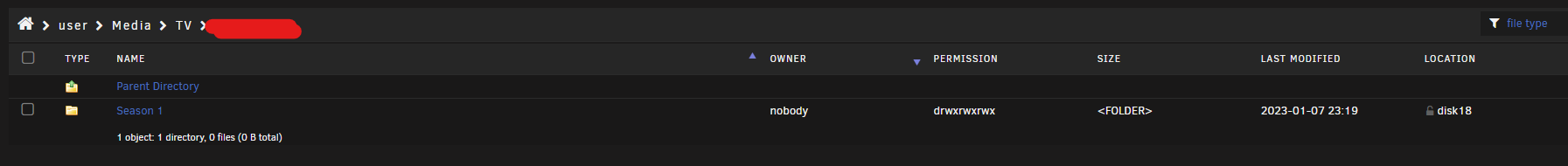

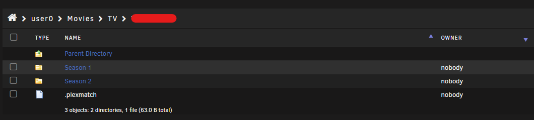

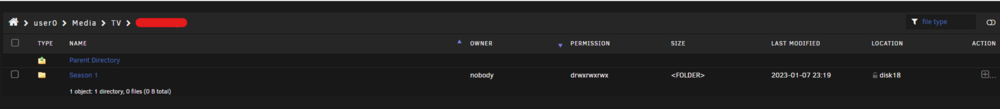

All that looks correct to me. If you browse the media share in that view, do the missing files show up?

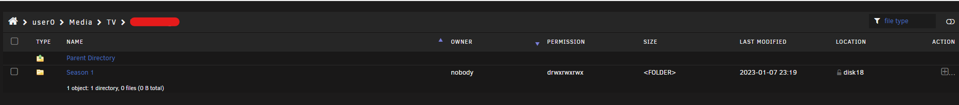

more weirdness.. i have a media share and a Movies share

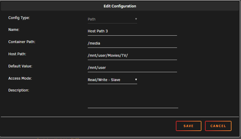

image.png.9d2471950291d4ef2c0ed790e9b45c6f.pngimage.png.a8e80d60b24c405ad7c033e637f1b521.png
dockers are mapped to the movies mapping  /mnt/user/Movies/TV/
now same show sonarr is only seeing season2
this stuff be working for years, and only a few days ago i realize the disconnect from back like Juneish  2024
any ideas?

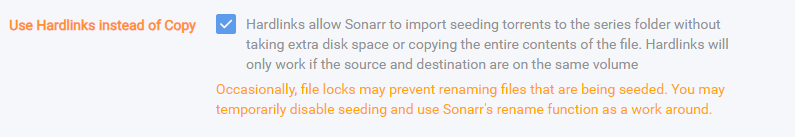

Is "Use Hardlinks instead of Copy" enabled? Mine was and causing completed files to move to user0 instead of their correct pool.
looks so on sonarr and radarr

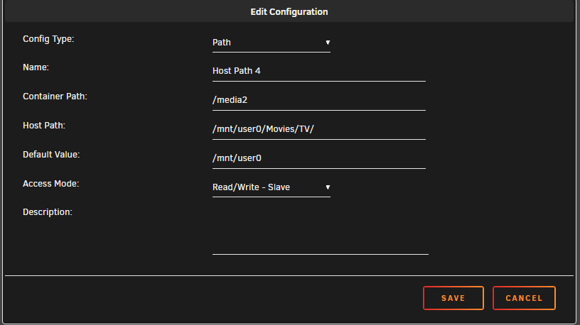

decided to try and throw in the 2nd path "host path 4" but sonarr is saying its all existing and wont let it import
 image.png.e1a5e4300bb8582c9fb93d575888f31b.pngimage.png.afe0a4651057433a5dd5a00158806040.png
is there a way i can reset shares or something?

I’m gonna be honest here, you need to do a thorough analysis of your docker container path mappings.
I think you have your dockers mapped to wrong locations and are putting the blame on Unraid.
for example, you said you have a “Media” share and a “Movies” share. That alone tells me you messed up mapping movies in one of your dockers and it created a Movie share. You should have mapped your “Movies” to /mnt/user/Media/Movies but instead you probably have /mnt/user/Movies.
this has nothing to do with “user” and “user0” which I think you’re wrongly putting blame on.
also the screenshots up a few posts of your host paths edits you’re putting /mnt/user to /mnt/user/Movies/TV. You’d never do this instead you’re supposed to map /TV on the container side to /mnt/user/Media/TV
TL;DR you need to check every docker path map to make sure they’re properly mapped to the host locations. Also make sure you’re properly using capitalization because it matters (Movies and movies would be two separate locations)
you also need to move any files that are outside the Media share back into the media share under the respective directories or you won’t see all your files. you can use the unbalanced plugin to move them.

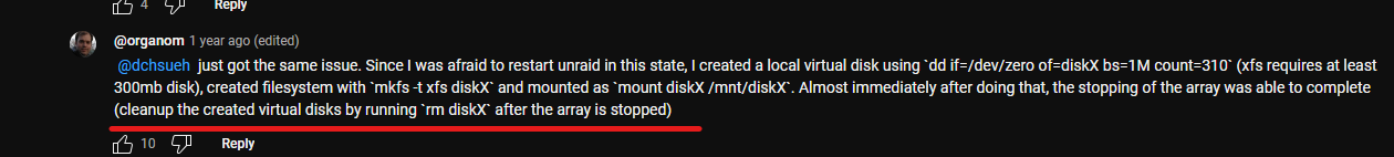

the last big change was following this guide to shrink away two 1tb drives using unbalance so i can upgrade my dual cache drives.. it may be related to this
shit.. this may be the issue.. the script was older and the array wasnt stopping. so i found this users comment in that video to create a virtual disk and that helped my blocker but i dont know if i ran the clean up after the array stopped.
