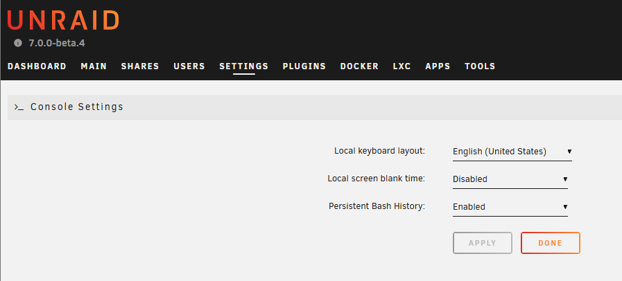

in terms of the console that due to new implementations. Setting > console Setting local screen blank time...
I'm not seeting any other panic or issues in the logs that would cause this outside of a web service docker breaking ports using host.
I will change those settings, and continue to monitor for any additional problems. If I find anything else that appears to be related I'll head back here with my findings, thanks for the assistance!
