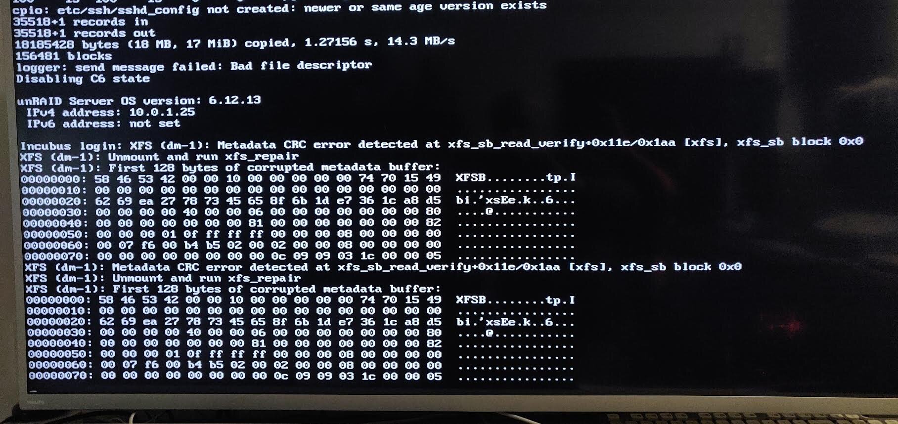

So, today i found this surprise (with zero SMART warings):
On the console i read:
Stopping / Starting the array makes no difference.

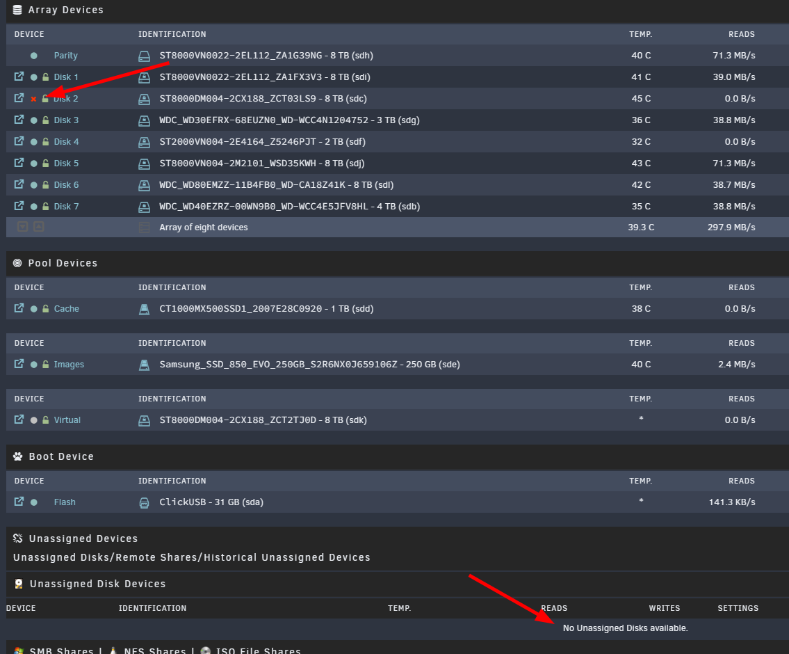

>First use the Unassigned Devices plugin to see if the old disk mounts and contents look better.
The plugin atm shows "No Unassigned Disks available".

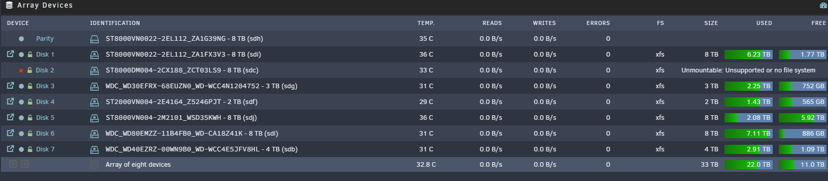

The disks situation is the following:
I guess i have to make the disk avaiable to the plugin un-assigning it from the array, correct?
Also, if Smart comes up with no errors and i want to have again the drive on the array (so, not being emulated anymore) and resync the parity (well, in case the files that aren't anymore in the emulated are actually on the drive, seen with UD)?
You have to unassign the disk first, stop array unassign the disk and mount it.
