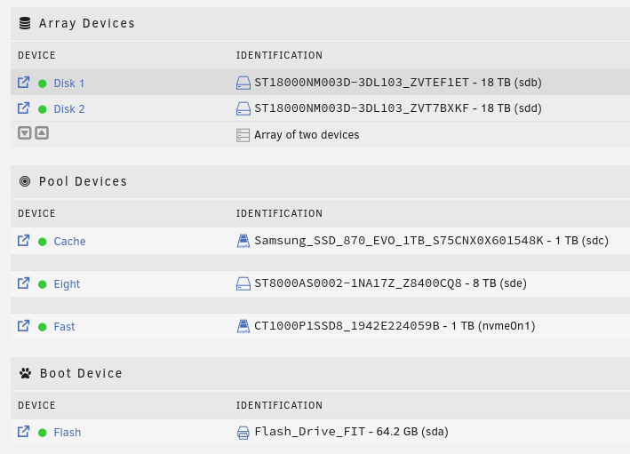

I set up my disks like this, I have yet to get some parity disks, the plan is that the next one is a parity disk.
The problem here is that the cache gets filled, and I have told it to send the info over to the array, but it still won't move the files, I have also tried to move the 8tb files to the array, so that I can take out that disk from the computer, but I don't get it to work. I must have set it up wrong, how do I fix it?

Remove the mover tuning plugin and run the mover, if the data is still not moved, enable mover logging, run the mover, post new diags and the name of the share(s) you expect to be moved
