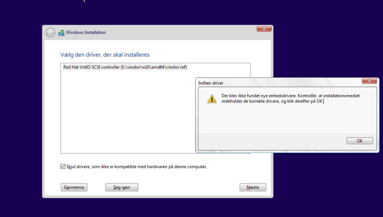

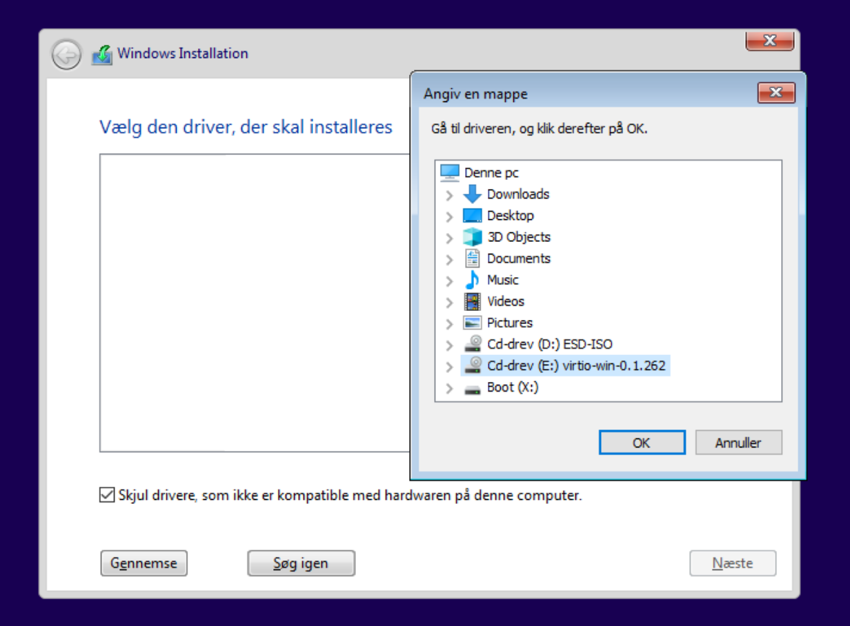

I came to this (image) i found this driver as I saw in a video, but i got an error. No new driver found, make sure it is the right driver.
The driver should be in the virtio ISO, alternatively choose SATA instead of virtio.

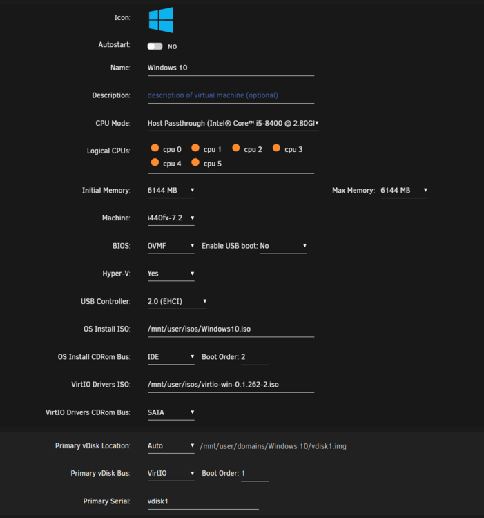

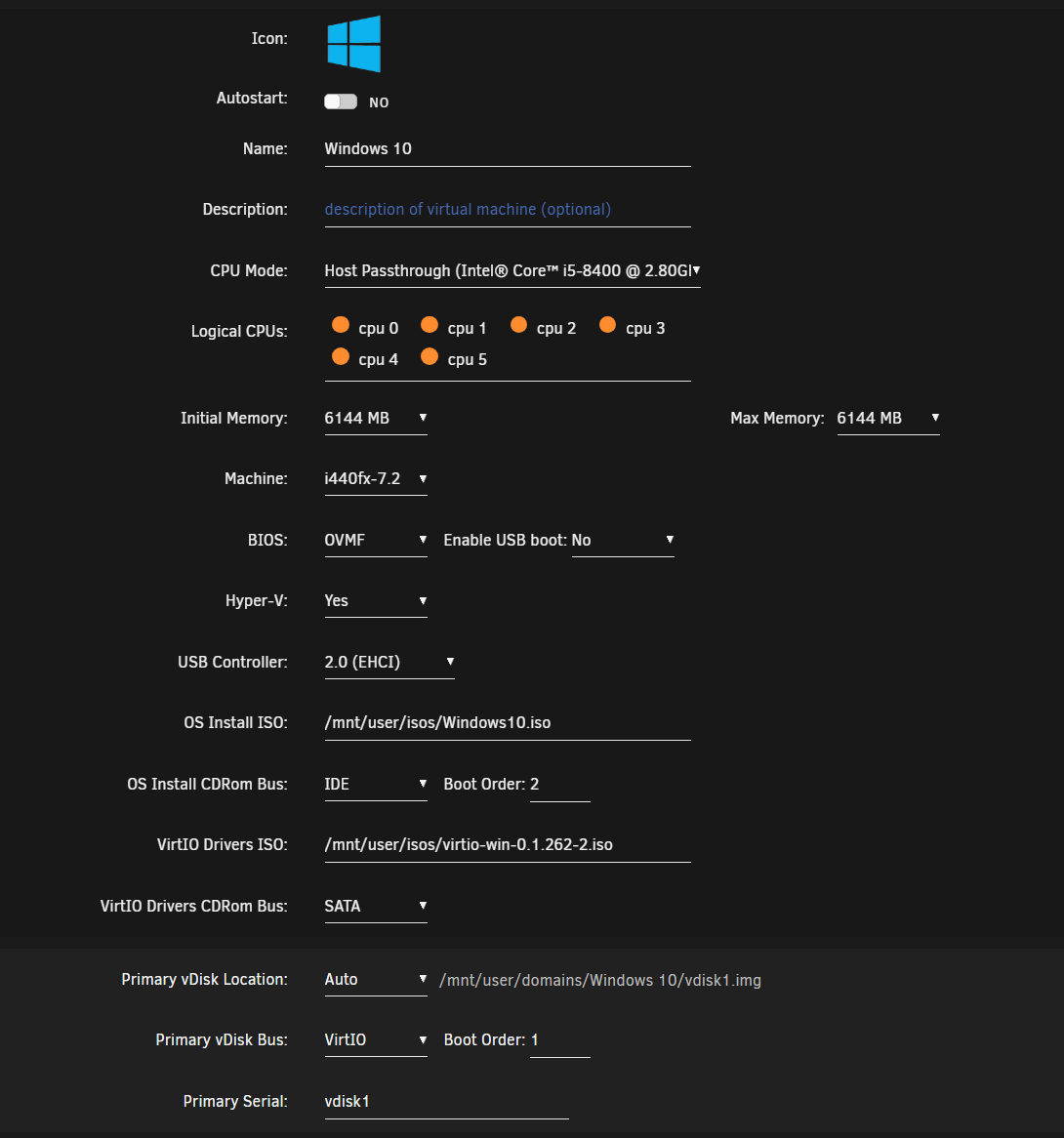

Is this right?

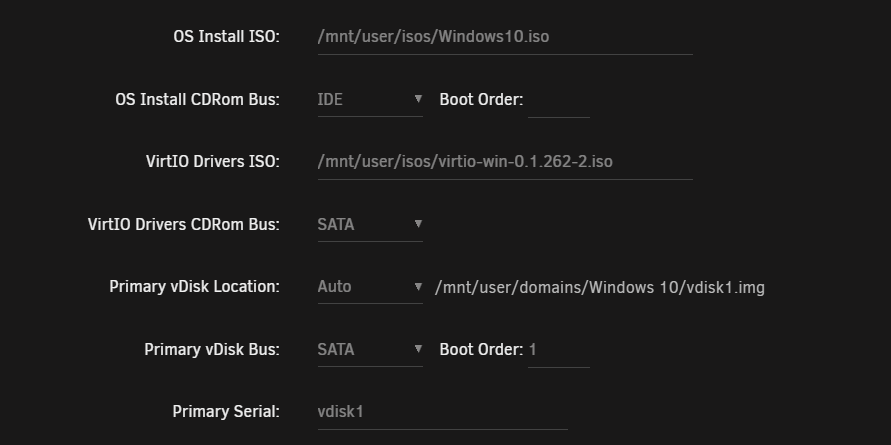

Use SATA for the vdisk, here:
I can not get the driver working, with this setup too
I am supposed to get the driver from the selected drive, right?
You don't need a driver with SATA, something else is wrong.
