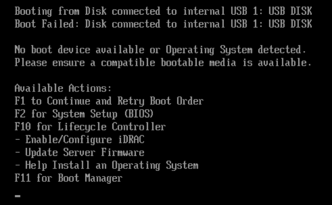

I have a dell R640, normal configuration, allowed usb access, set USB that UNRAID is on to the first boot option. I have tried both BIOS and UEFI to no avail. In UEFI I get the following error: Boot Failed: Please ensure a compatible bootable media is available. I have used several usb sticks as well as the usb maker and manual install. I have had zero luck, has anyone had issues with installing/running unraid on a Dell PowerEdge R640?

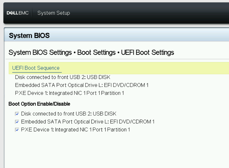

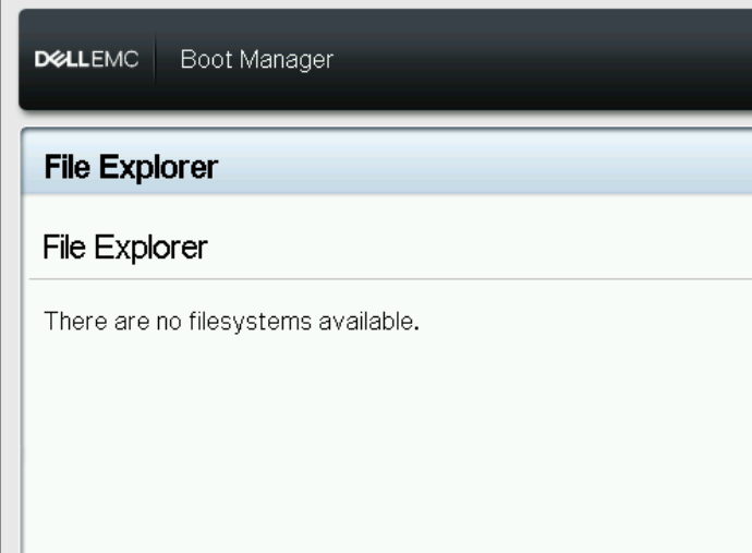

I have not in another computer. But I believed that it was USB related as well. But not sure how it could configure incorrectly if I am using the tool. Here attached is a screen shot of the boot settings. I reached out to a coleauge of mine who says that you should see UNRAID in the BIOS. Just curious if that truly is the case.
