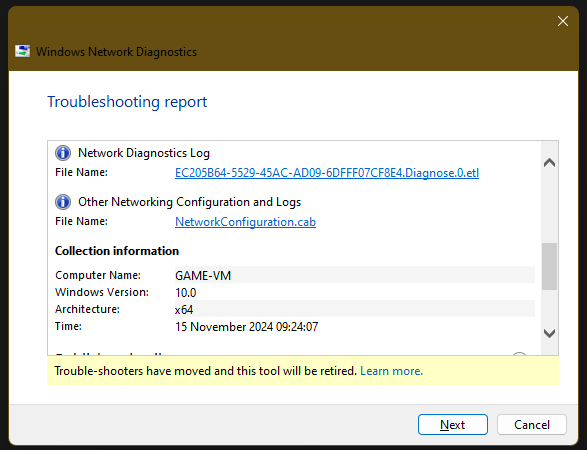

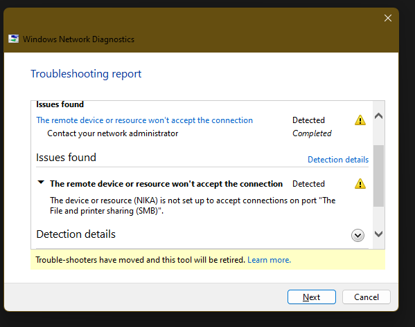

When I diagnose it it looks like this.

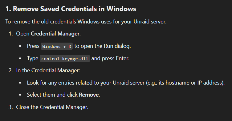

I thought it would be a credentials thing, so I went along with the ChatGPT response and tried this.
Removing the old credentials did not help at all. Next is to try and reset the network I suppose. "/
Oh, yeah, the details states this btw.
This has to be an unRAID problem, because it was working flawlessly for me from day one of using it up until today.
