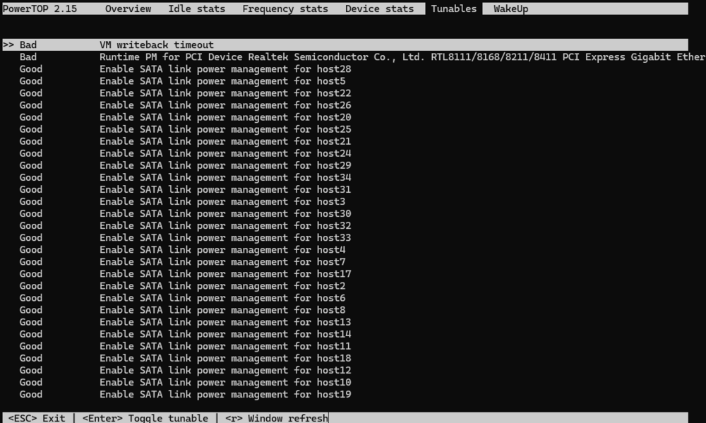

In powertop, it looks like this on the tunables:

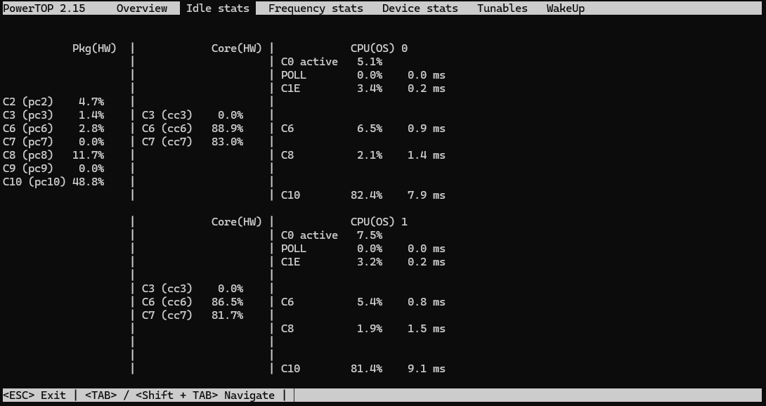

And like this for the c-states under idle stats (which I think is quite alright)
