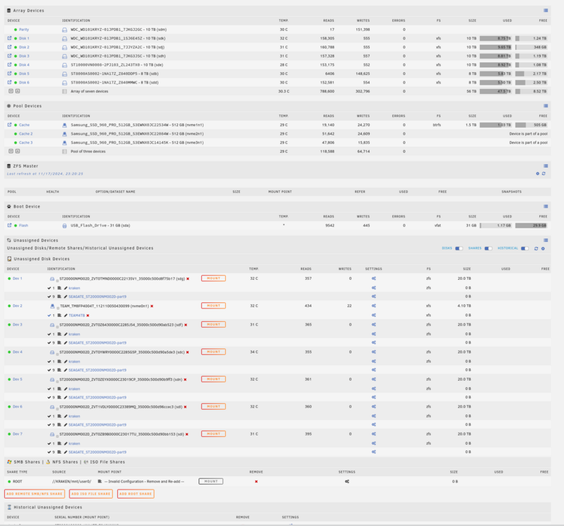

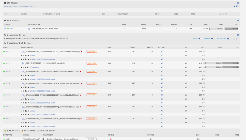

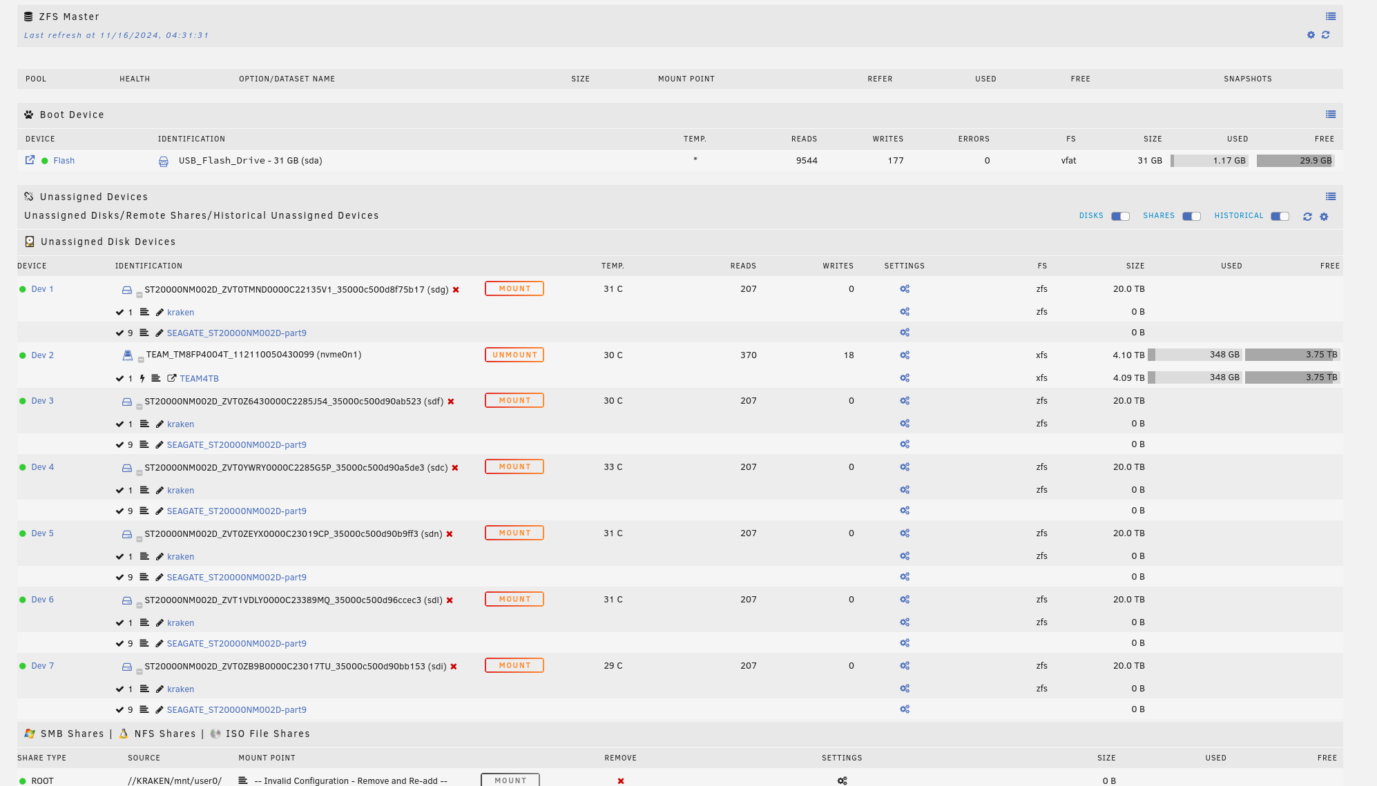

Hello, I have just done unraid update cause my computer was off for 1 year, unrade 6.12.13. after the update to the new OS from the older one the ZFS is no longer showing my drives and i cant connect or see my data.  I am not sure what do do to fix this. I even downgraded to Version 6.11.5 2022-11-20 and the ZFS MASTER ICON showed up but when I started the array it went away and I dont see my drives of the info in the display page.  How do I get my zpool back and to show up?

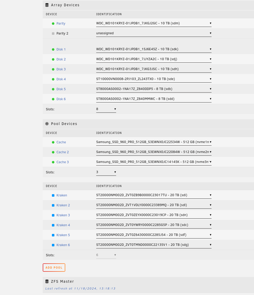

1 hour ago, JorgeB said:
This order.

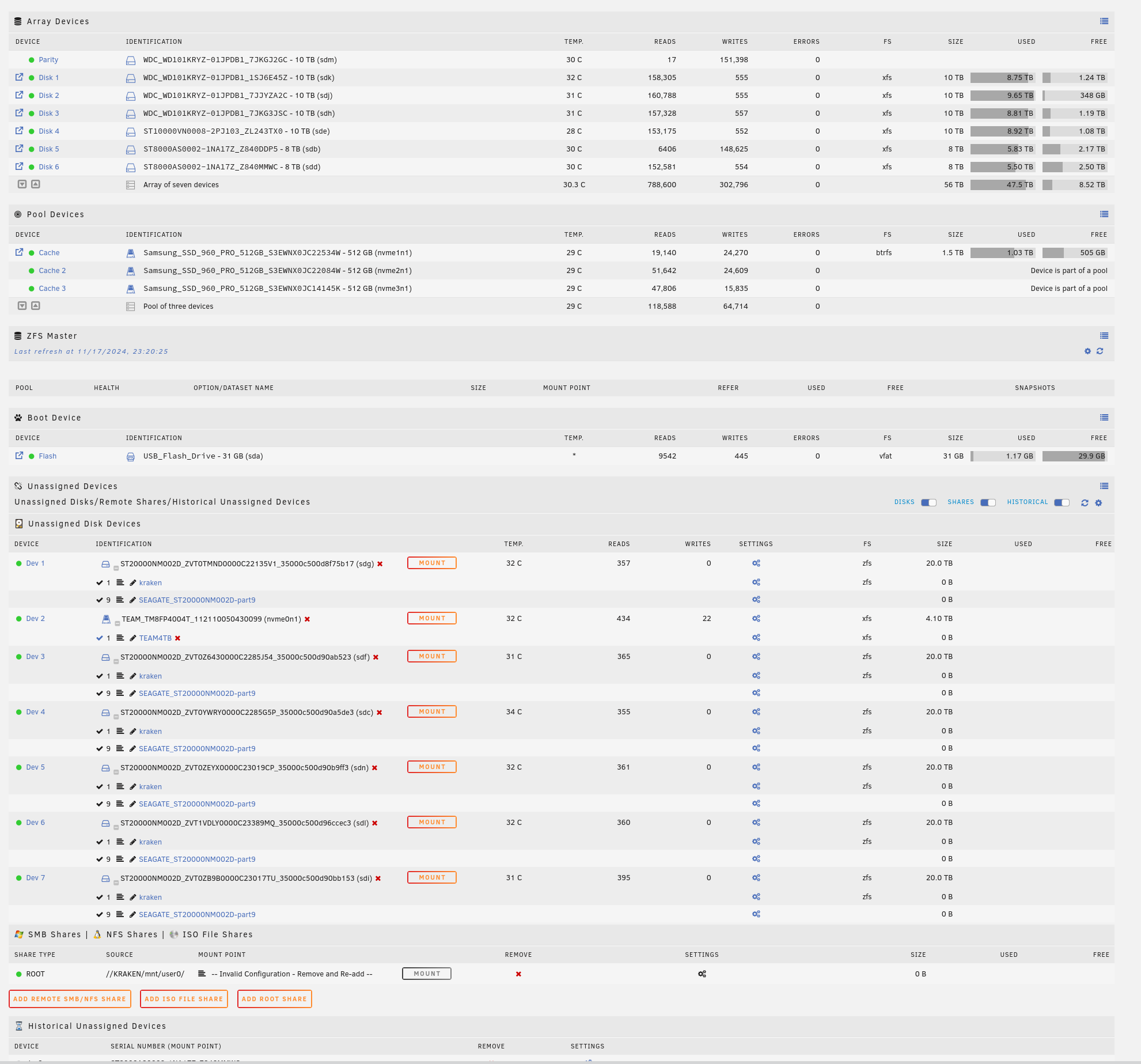

How do I do that order when all i see are the disk?
or is this the correct order?

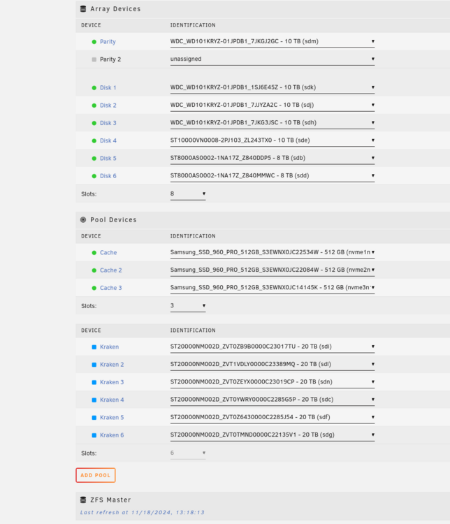

based on this:
And yes, it looks correct.

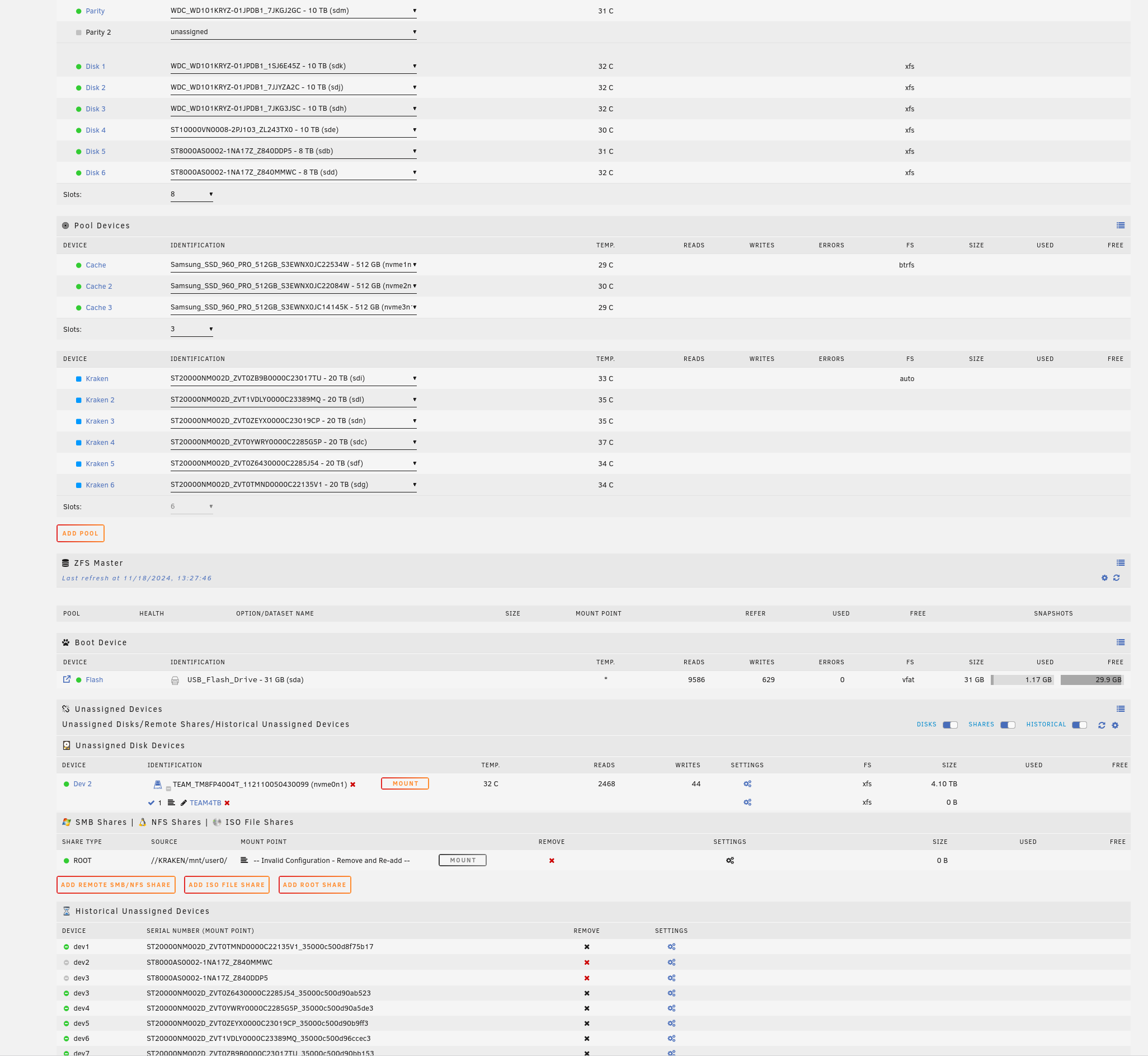

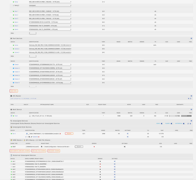

ok, well they removed the drives from unassign.
all I do it start the array and the zfs mirros that I had should show up?
the add pool button was not under zfs manager but will add my zfs mirrors and i wont lose my data?
before and after let me know if this is correct and I should start the array to get my zfs pool going?
Just start the array with the new pool assigned.
