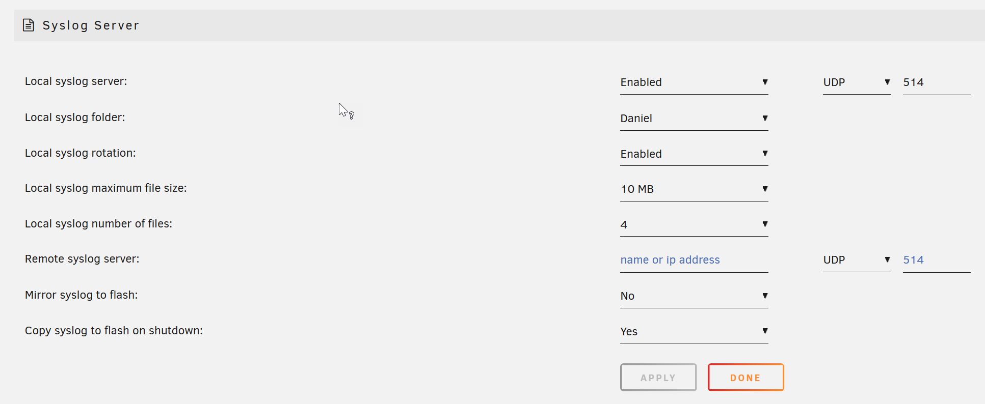

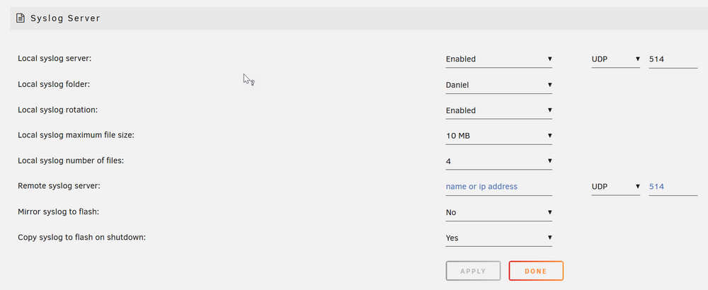

Are you sure you have it configured correctly?    It might be worth posting a screenshot of the settings you have.
These are the settings. I just tried a new share (public instead of "daniel beeing private) but still empty
You need to set the Remote Syslog Server files to the local server IP address.
Ok did that and now there is a file 😄
Edited by Saarlaender
