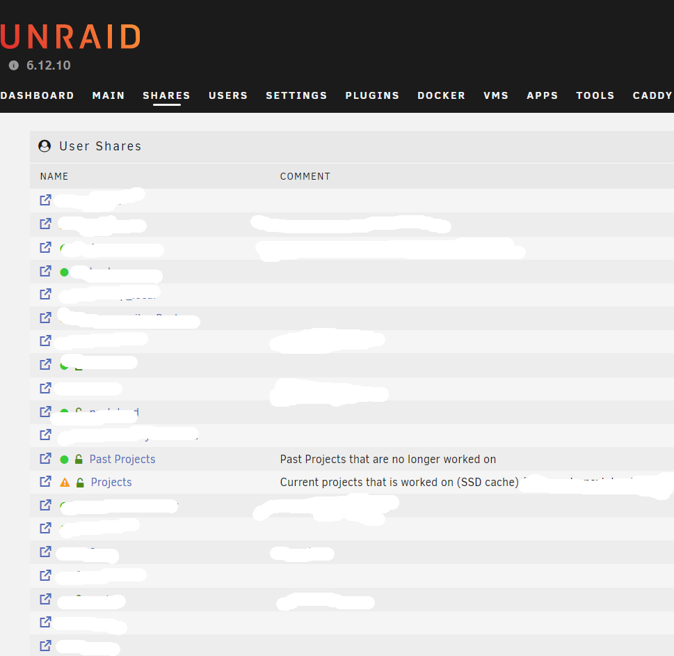

Trying to move some files using midnight commander from /mnt/user/Projects/02 POST DESIGN to /mnt/user/Past Projects/03 PAST PROJECTS.
/mnt/user/Projects/02 POST DESIGN is on a cache disk
while /mnt/user/Past Projects/03 PAST PROJECTS is on the array.
I was fully expecting that the move will be atomic, and that it will only be moved from the cache to the array after mover is scheduled to run, as both directories share the same root directory /mnt/user.
Am I missing something obvious or is this correct behavior? Sorry if this has been asked before but couldn't quite find the info searching for atomic move in the General Support forum.

is the user share setup with 2 disk storage for mover to inteact with
main storage cahce
second disk array
shown as cahce > array ?
if not mover will not touch or move this automagicaly you must scirpt somthing to copy/move....
I understand where you are coming from, where this behavior needs to be set within the share itself.
That is not the question though 😅
The move is across shares.
if mc fialed you idk then ?out of space?
I was actul working with another user regradign simlar info:
i would probley use rsync comand with user script. but that cop not a move... hmmm i need to think on this one
