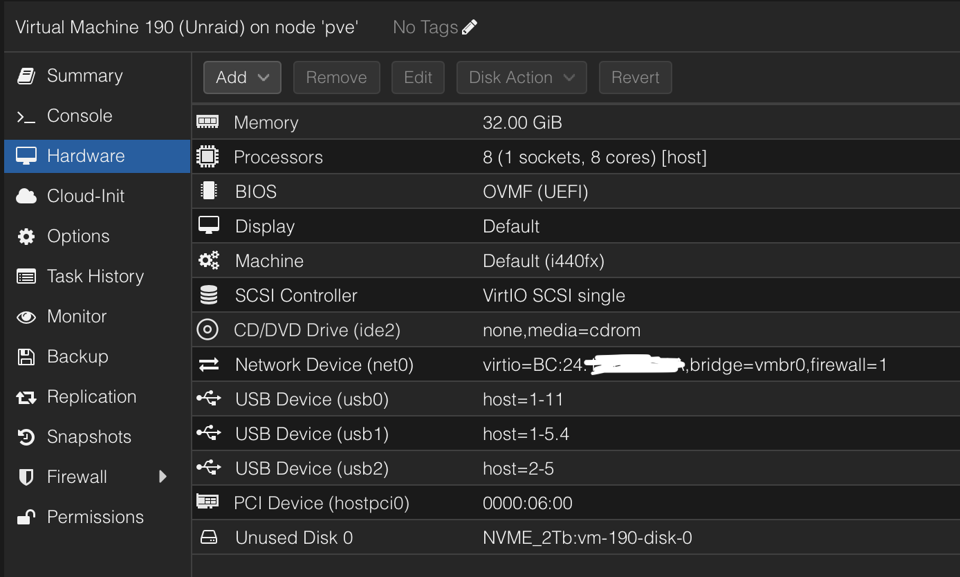

I run Unraid in a Proxmox VM for about 8 months in this rig (passing through a HBA with my 5 HDD and 1 SSD drives) and was working extremely reliably. About 3 weeks ago, I installed a GPU in my system (a RTX 3060) which coincided with the start of the Unraid VM crashes. I thought it could be a hardware issue, but my power supply has enough Wattage for the system with GPU (750W), I am not using the GPU in the Unraid VM (it's used in another Linux VM) and all other LXC/VM in Proxmox are running solid with Zero crashes. The system has been pulling 250W maximum and the crashes have been happening with the GPU in idle (with the whole computer pulling only ~90W).
When I initially installed the GPU, my motherboard (MSI Z790-P) changed the PCI IDs of the HBA and the onboard NIC. I updated the NIC ID in Proxmox and  corrected the HBA ID for passthrough in the Unraid VM. With that, the Unraid VM was up and running and worked perfectly for a couple days when it started crashing.

- No hardware changes to Unraid (the HBA and a couple USB ports are the only hw passthrough I have in Unraid) - see VM config attached

Hello @JorgeB. It seems the problem was completely unrelated to Unraid or the hardware itself. By going through the Proxmox logs, I noticed the Unraid VM was being shutdown due to an Out of Memory (OOH) issue. I reduced the amount of RAM I allocated to other VMs and remove the ballooning option from the Unraid one.
The problem seems to have gone away and Unraid has been running well so far.
