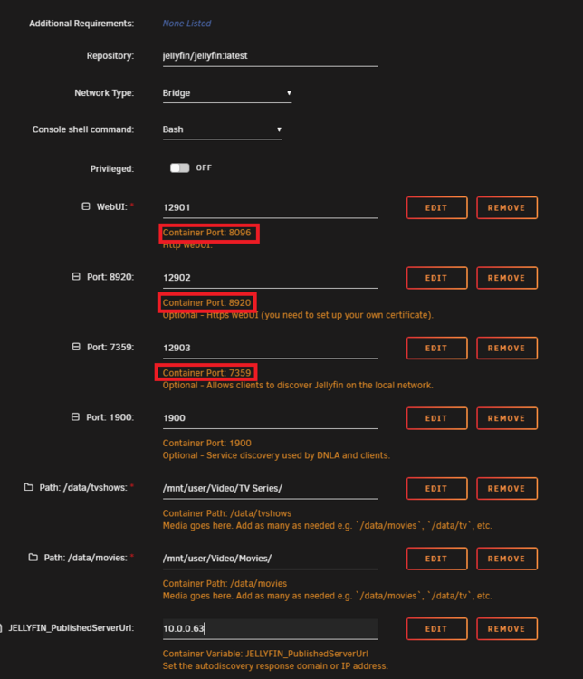

The template is more or less broken because youre running in host mode.
Changed exposed ports in host network mode doesnt work. (you need to modify the container itself to work with it)
You need to swap the container ports (jellyfin-docker.png.4b78ee29fa6a2045134bfc8f5761da55.jpg.1d693d900099225d99f6f9168df3af9a.jpg)
back to what theyre supposed to be and then change the network at least to bridge

25 minutes ago, Torlew said:
-> Why is it not possible to properly change the Docker Settings?

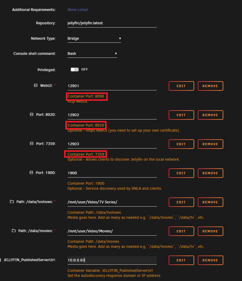

It is, as long as the template didnt get broken by choosing host mode, because it rewrites the port mappings.
its important that the container ports stay the default while you can change the textbox freely, in bridge mode.
