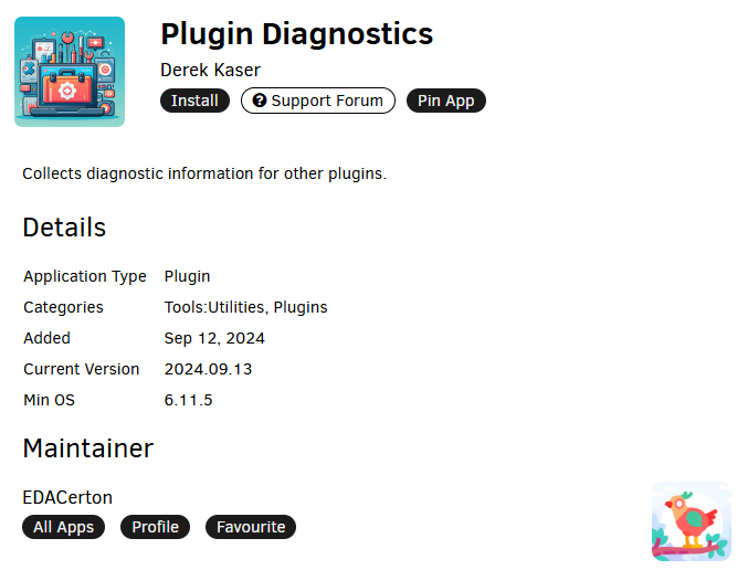

Just a fyi if web ui is down but you at the console either ssh or screen you can type diagnostic, and it will run and save a diag file on the flash drive for logging and troubleshooting.
see in docs: https://docs.unraid.net/unraid-os/troubleshooting/diagnostics-information/
Even a boot into safe made and using tools daig will sometimes capture the previous syslog and get some data to help troubleshooting. No judgment there's alot that goes in a diag file and it's only part of the picture.
Currently There is a community dev plugin that helps logs and capture other plugins.
I'm not aware of any sandboxing but this may help get more logging and changelog info from current plugins:
