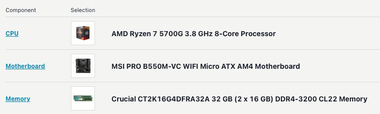

Attached hardware for reference. All of the memory is detected, and I'm not seeing any resource usage spikes.

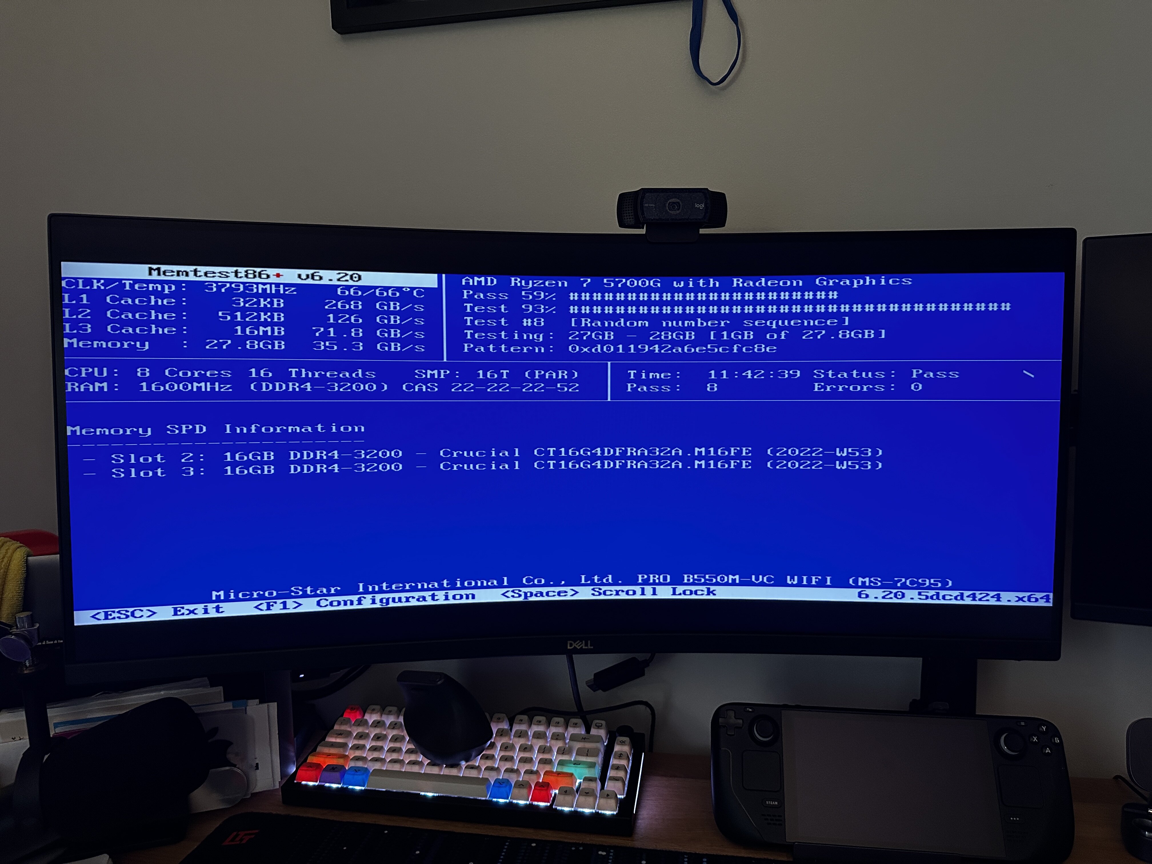

Memory tests run for ~12 hours, passing

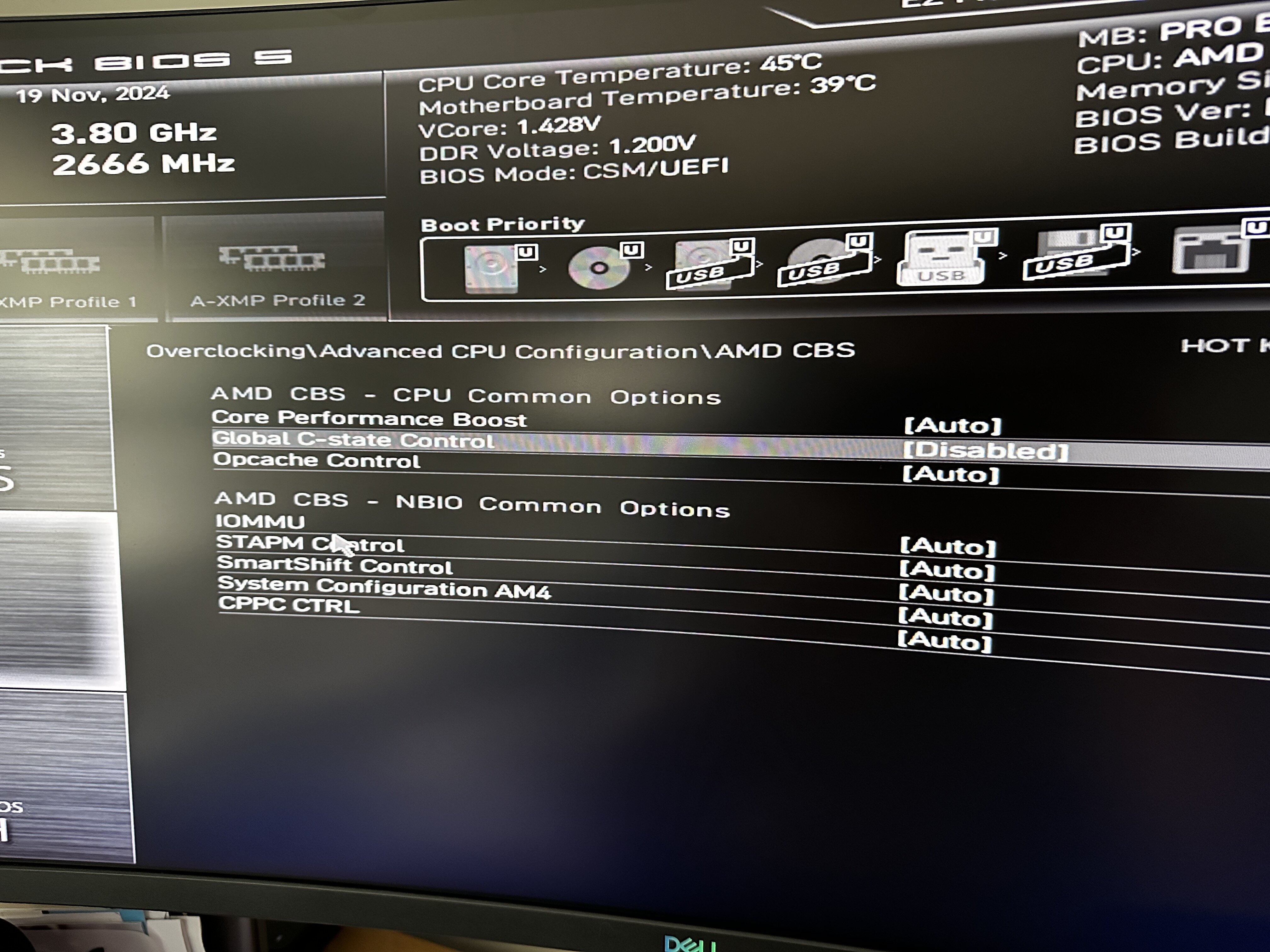

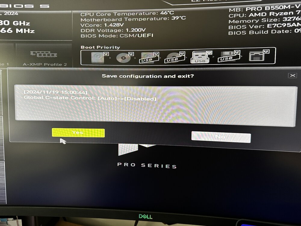

Done. (Assuming this is the right setting, deep in OC settings)
System is up following BIOS c state change, waiting for it to come down again. I'll upload diagnostics again if that happens.

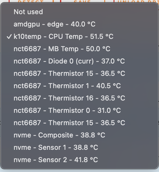

I'd just like to add this as a note, I'm very hesitant to re-paste and re-seat the CPU, in part due to the fact that it's been working for nearly a year without issue; But also because temps in the case are pretty chilly by my standard and not suggesting any kind of over heating
Using the power supply idle control setting is usually preferable than completely disabling C-states, but for testing purposes it should do the same.
We've topped 24h of uptime, I'm going to go ahead and say it was the C-states stuff causing the issue out of nowhere. Confusing considering the machine has been running for the better part of a year without this happening, but I'll take it!
