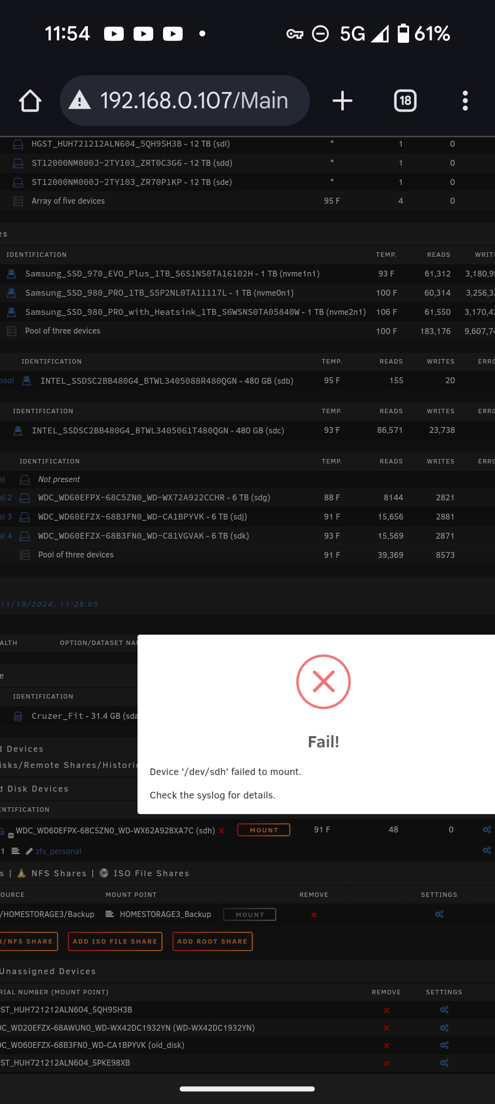

Had to shut down my server to move it for some electric work.  When I went to reboot I am missing a drive in my zfs pool.  Not sure how to resolve. The log log states:
omeStorage nginx: 2024/11/19 07:38:13 [alert] 24519#24519: aborting Nov 19 07:38:16 HomeStorage unassigned.devices: Error: Device '/dev/sdh1' mount point 'zfs_personal' - name is reserved, used in the array or a pool, or by an unassigned device. Nov 19 07:38:16 HomeStorage unassigned.devices: Disk with serial 'WDC_WD60EFPX-68C5ZN0_WD-WX62A928XA7C', mountpoint 'zfs_personal' cannot be mounted. Nov 19 07:38:17 HomeStorage unassigned.devices: Mounting Remote Share '//HOMESTORAGE3/Backup'... Nov 19 07:38:17 HomeStorage unassigned.devices: Remote Server 'HOMESTORAGE3' is offline and remote share 'Backup' cannot be mounted. Nov 19 07:38:17 HomeStorage unassigned.devices: Waiting 5 secs before retry mounting Remote Shares... Nov 19 07:38:22 HomeStorage unassigned.devices: Mounting Remote Share '//HOMESTORAGE3/Backup'... Nov 19 07:38:22 HomeStorage unassigned.devices: Remote Server 'HOMESTORAGE3' is offline and remote share 'Backup' cannot be mounted

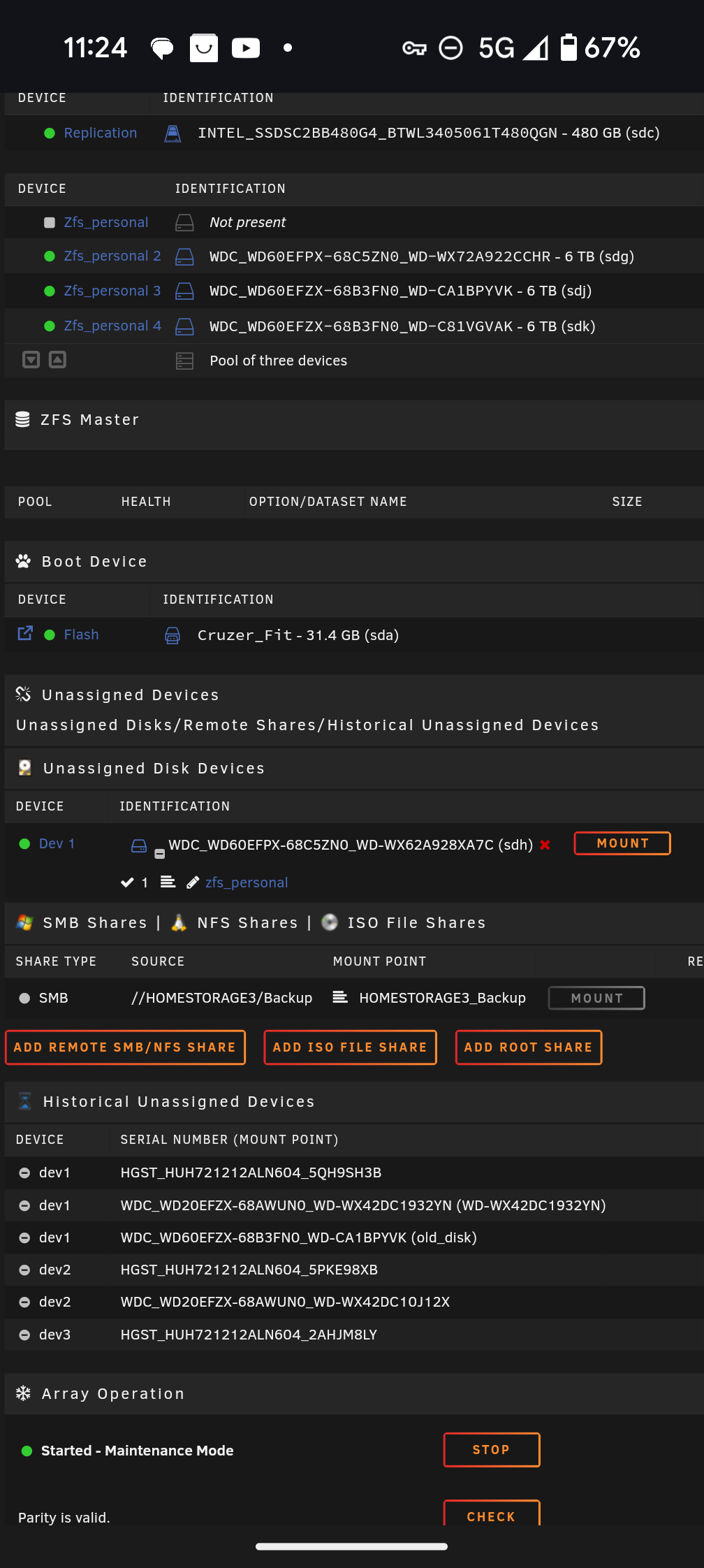

Where do you see Unmountable?
Sorry maybe wrong terminology.  Screenshot_20241119-115434.thumb.png.49f080e9d28ed7e36e5fc3ee0f3e963f.png
You are trying to mount the disk that dropped from the pool, that won't work, but the pool itself is mounting if you start the array.
SMART for that disk looks OK, but there are a lot of UDMA CRC errors, replace the SATA cable and add it back to the pool to resilver.
