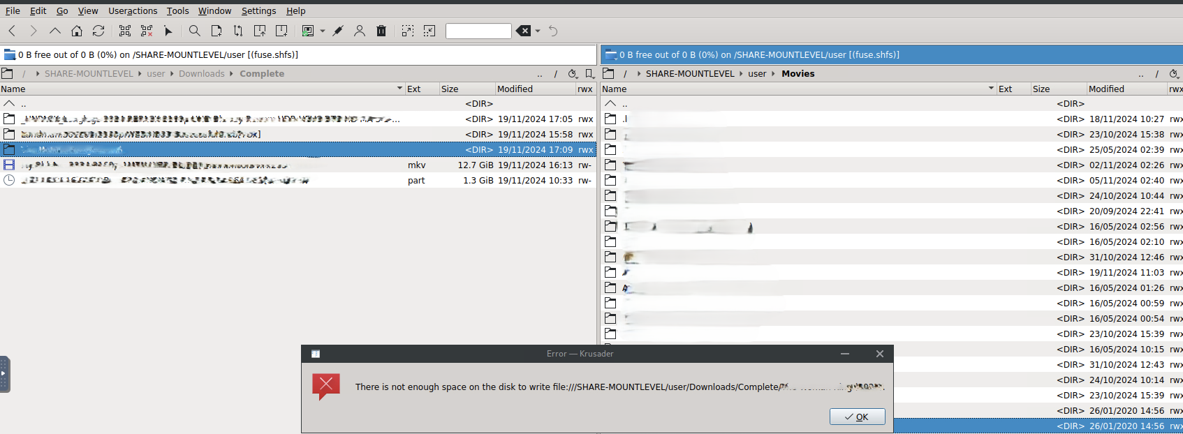

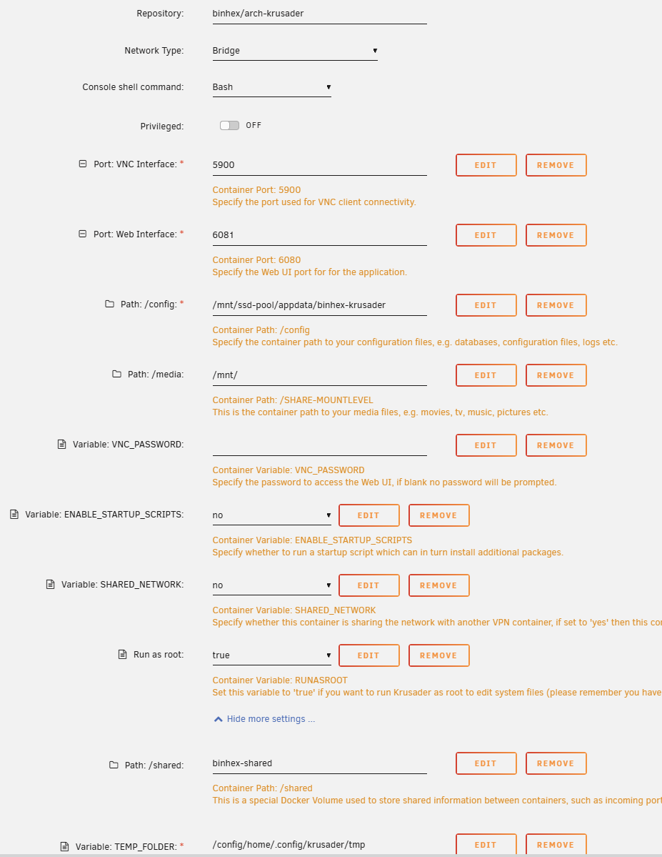

I am starting to get desperate now. When I do a fresh install of Krusader, everything works fine. After a couple of times copying and moving files, it just does NOT work anymore.
I'm trying to move a movie from my Downloads share on my SSD-pool to my mainpool. This gives the error of insufficient space.
Also copying/moving files on the SAME pool does not work anymore.

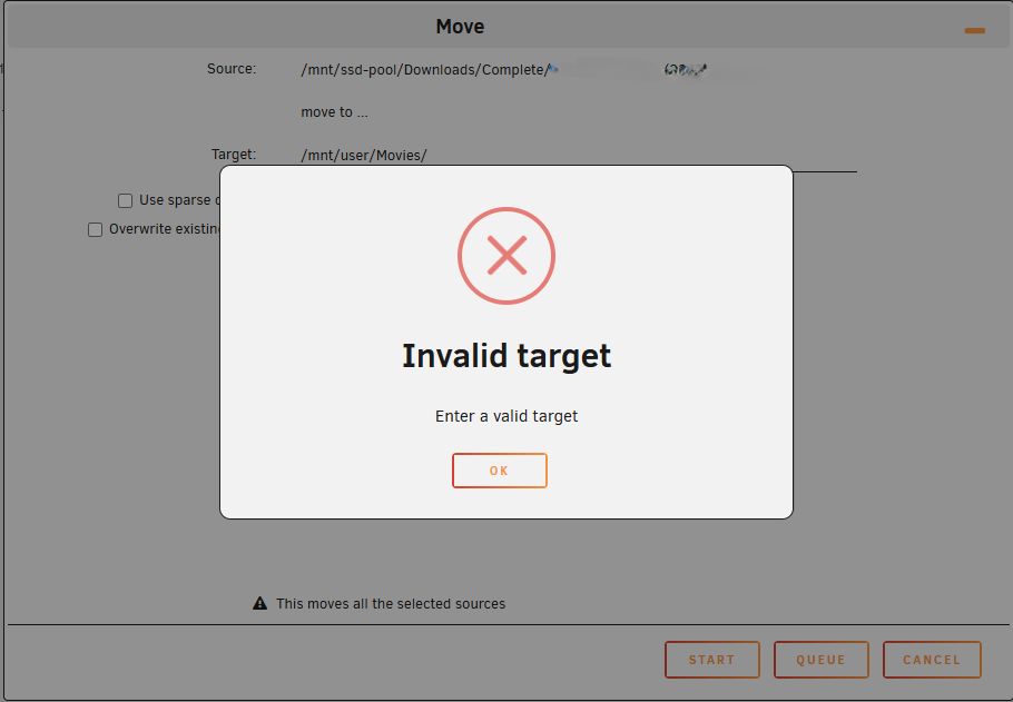

Using UnRAID's file manager, I get the choose a valid path error.

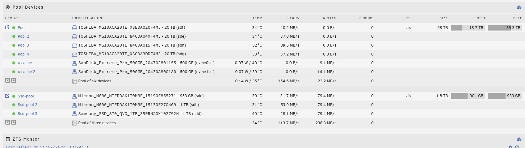

Running UnRAID 7 beta 4 with 2 ZFS pools, NO array drives.

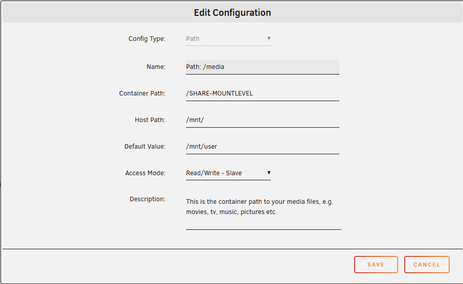

4 minutes ago, TallMan206 said:
Because it is not only Krusader, but also the file manager, I decided to put it in General support.
the filebrowser, if its limited to your screenshot of it, actively hinders you to copy/move from disk to fuse mount point and vice versa, you need to copy/move the data between the disks themselves

Not an expert, but you seem to have two "Movies" shares, one on "pool" and one on "ssd-pool" so when you use the fuser mnt of "user", it's probably confused which you want to write too.
Overall you have 141 shares, which seems excessive but don't know your use case....
No, it's the movies inside of my Movies share. I only have a couple of shares. Like 11 or so.
Movies share only exist in main pool. I move the movies I downloaded from 'Downloads' to 'Movies'
Edited by TallMan206
Alright, I see most of them marked "does not exist".
Still, the Movies share exists on the pool and the ssd-pool, but is set to cache only (ssd-pool), so if the file is being moved and is already on the pool, seems like that is the issue.  You need to set it to use the array or move all the files off.
M----s                            shareUseCache="only"    # Share exists on pool, ssd-pool
Ah I see what you mean. Radarr/Sonarr make this dataset all the time on the ssd-pool, but there is actually nothing in there.
