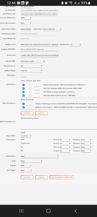

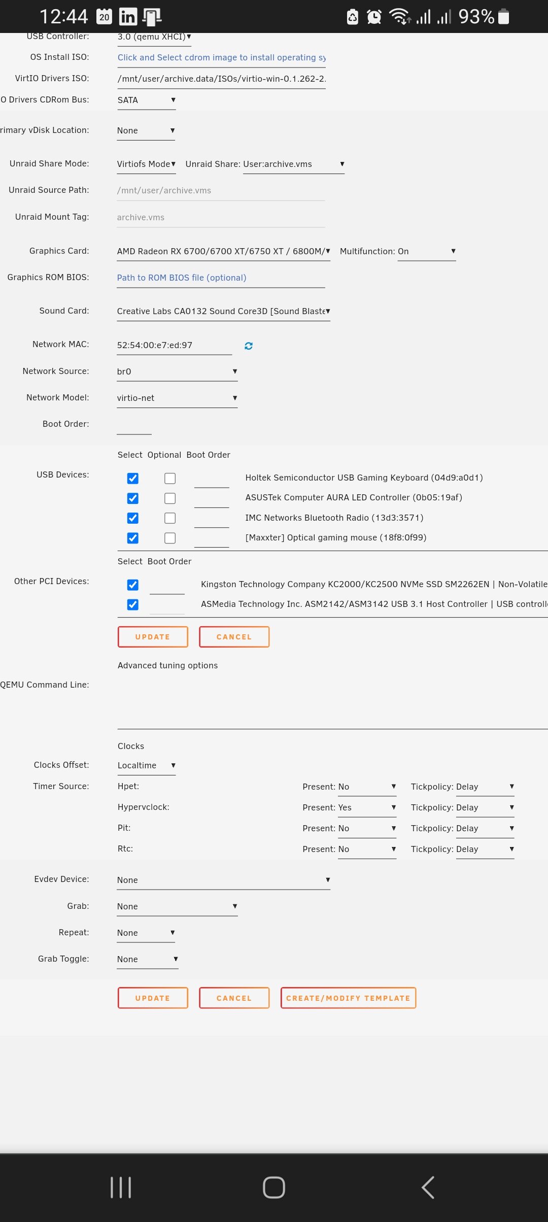

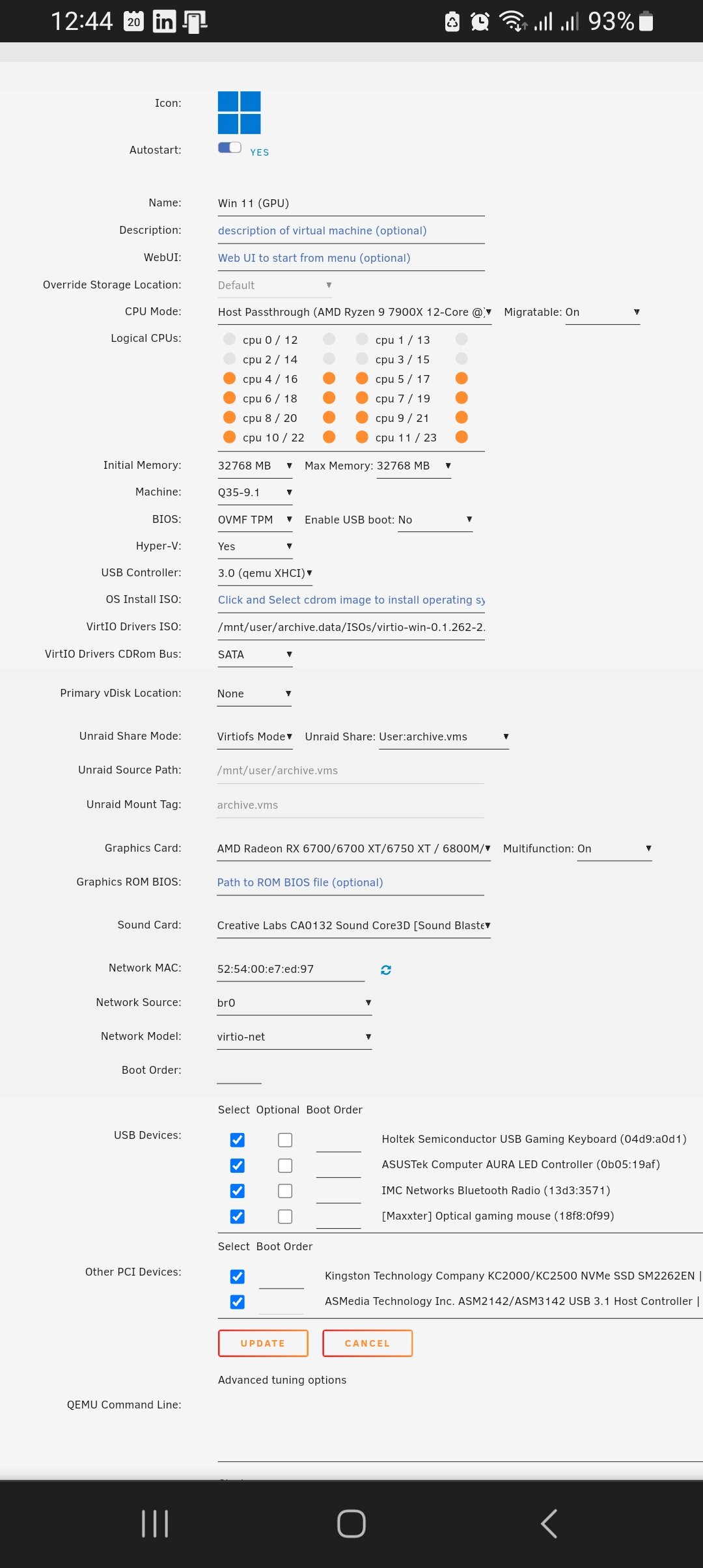

This is the settings I want it to be.
Screenshot_20241120_124442_Brave.thumb.jpg.87e02e419ed59267c2de23b814a830cd.jpgScreenshot_20241120_124451_Brave.thumb.jpg.4991fe68f94443aa9725d72266f02b2c.jpg

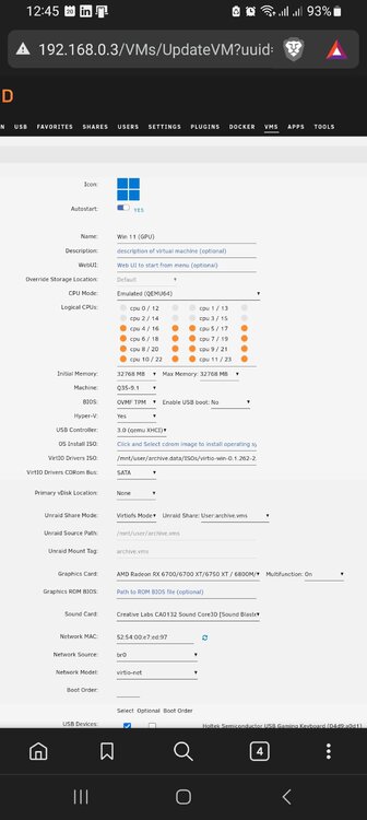

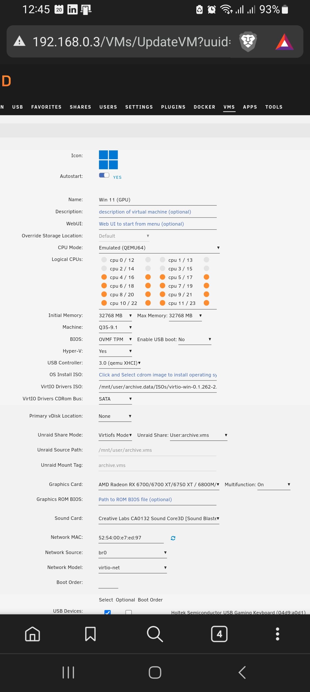

and I got so tired of trying to fix this some months back, that I changed the CPU to Emulated like this.
That was NOT the right answer to this problem, While I can use the VM, (Proven by me writing this in that one VM), but I can't start games, if I do Steam crashes, and I can't install extensions to Visual Studio, which makes it unbearable to use Windows in it's current state, since I have to reboot into the m.2 stick, reset the pin, login on multiple platforms, then start VS and install the extensions, and then reboot into unRAID again.
