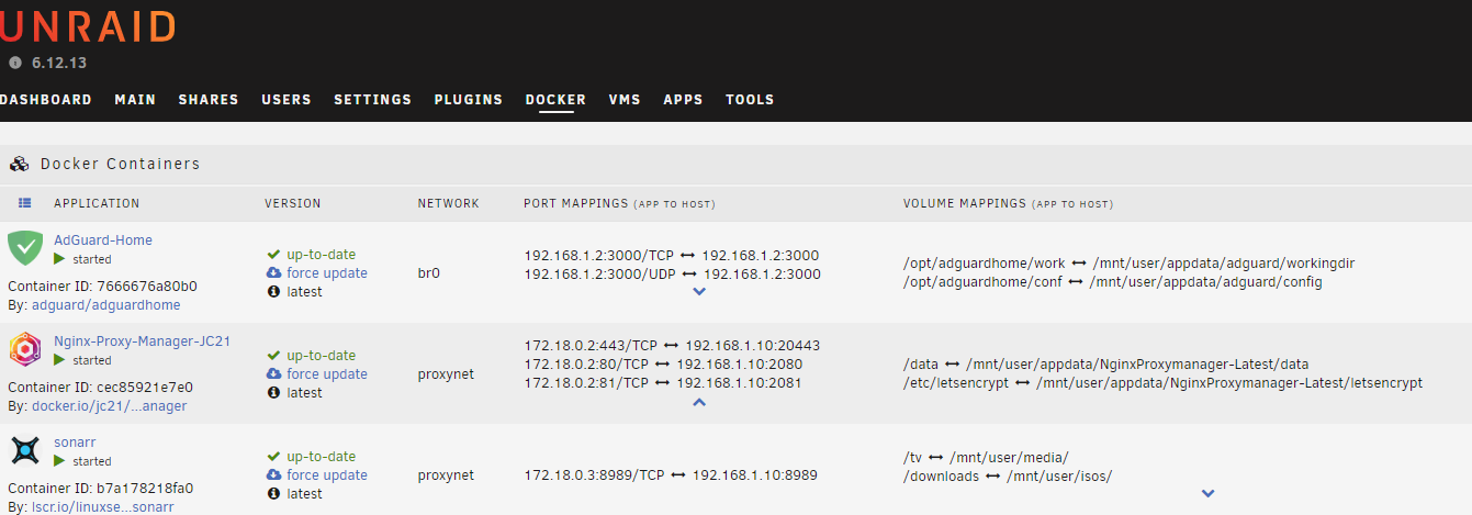

Hi.  I need some help getting all to work together.  My unraid is at 192.168.1.10.  I installed Adguard home, and gave it a permanent IP 192.168.1.2.  Then I created a custom bridge named proxynet (from instructions of Spaceinvader One).  I installed Nginx Proxy Manager, assigned proxynet.  I also installed Sonarr, used proxynet as well.
I can access NPM via nas ip:2081 (192.168.1.2081).  I can access Adguard home at 192.168.1.2.  In Adguard home, I went to filter, dns rewrites, and added sonarr.home.local, and used ip address 192.168.1.10.  It doesn't work.
When I access 192.168.1.10:2080, I get Congratulations.  When I access https://192.168.1.10:20443, site cannot be reached.
If NPM is using same address as NAS, I need to change ports to 2080, 20443.  In adguard home, it doesn't support ip_address:port_number.  Am I right that NPM should have it's own IP, so that once adguard home points to that IP, it hits NPM?  If so, how do I assign permanent IP to NPM?  What network should I use?
