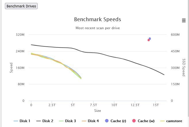

Don't overlook access speed when comparing large vs small capacity drives.  Here is a benchmark from my backup server, which has several HGST Ultrastar 6TB drives and one Ultrastar 16TB drive.  Access times are significantly faster for the 16TB, as much as 2x faster when at the 6TB mark.
