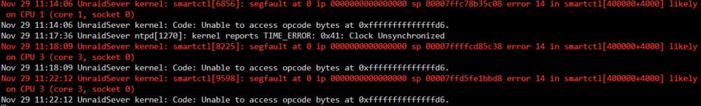

I consistently get smartctl segfaults no matter what I try, they can be every few minutes, or an hour or more apart. Eventually the server becomes unresponsive via webui, and any docker that might be running stops. Typically within 12-24hrs. Was a struggle to get the parity check done for 8tb, without going down.

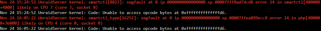

This is an example of the error I see in the logs:
It's taken from the server right now, whilst running in safe mode.

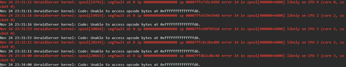

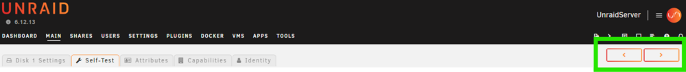

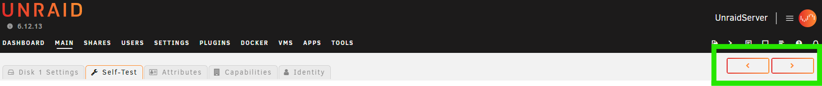

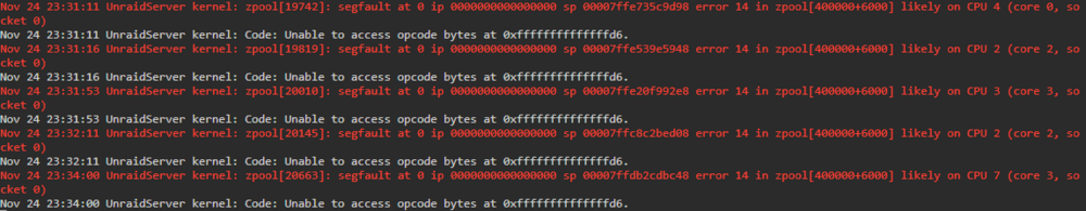

I did notice a zpool segfault error every time I switched between drives on the self testing tab.
Never been able to induce an error before now. But it's different to the one in my OP.
