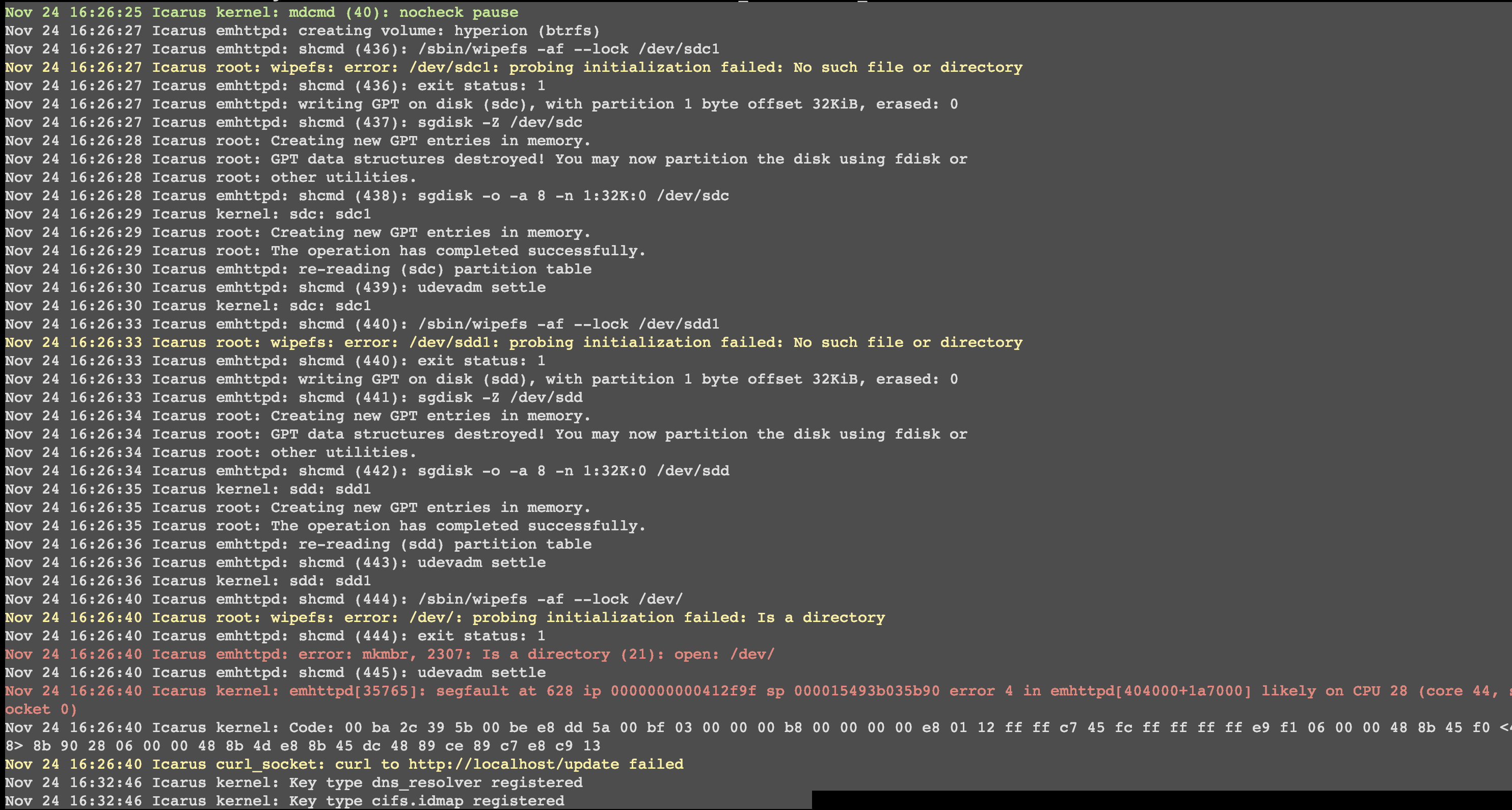

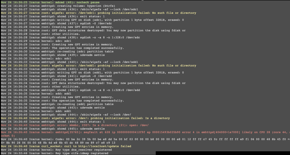

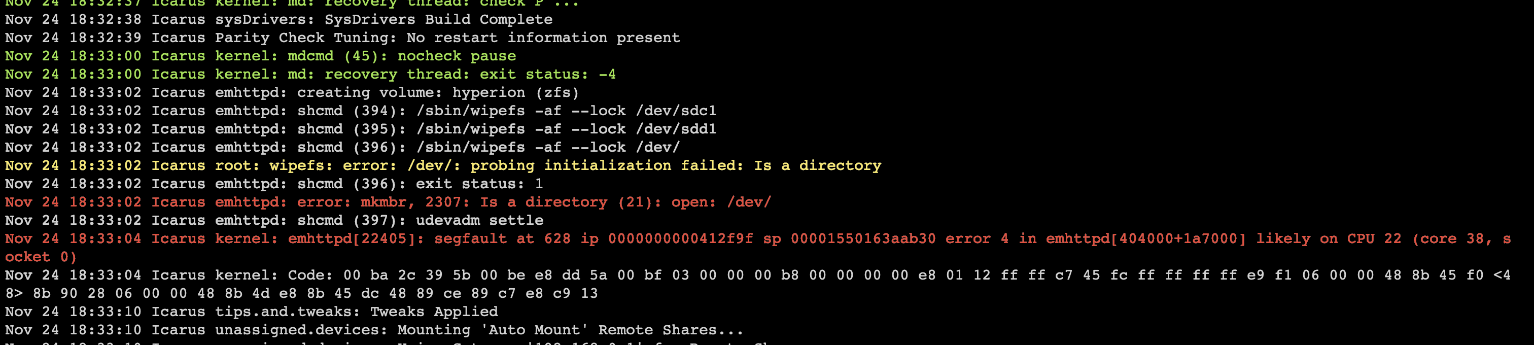

The process is either stuck at formatting or mounting, depending on if I format & create the filesystem via console (stuck at mounting) or inside the Unraid GUI (formatting). The attached part of the syslog shows the error "emhttpd: error: mkmbr, 2307: Is a directory (21): open: /dev/" and "kernel: emhttpd[22405]: segfault at 628" consistently when I try to format either btrfs or zfs on my 2x20TB Exos.

Any ideas what I am doing wrong or if this is a bug ? I was able to mount the formatted filesystem via console ... so my guess is this should work flawlessly inside the GUI ?

Ok you never guessed what it was .... silly me thought the pools work like the array in terms of layout. Apparently you can not have empty slots in a pool ... 🤦‍♂️
Well I knew it was nothing complicated because I was able to mount and use the disks via console, which made them invisible from the UI.
After only using 2 slots it worked like a charm. I don't like that fact the the error message is very abitrary and I couldnt find the fact very easily but now I do undertand :P
