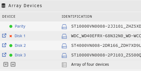

Hi! I have this issue in my array and I have tried every possible fix that I could find on the site. I have version 6.12.13.
Here is the list of things that I have already tried:
1) Shutdown and boot again
2) Replace the SATA cable and connect to a different SATA port on the motherboard
3) Parity check
4) Stop the array, leave the disk unassigned, start the array; then stop, assign the disk to the array and let it rebuild from parity
5) Unassign the disk again, format it, ple-clear, assign it to the array and let it rebuild from parity. On this ocassion it seemed to be fine at first, but about 15 minutes later it showed again "disk is disabled, contents emulated"
The ple-clear report in step 5 showed 0 errors. SMART report shows no errors.
What else can I try if everything tells me the disk is fine??

OK... I did the parity rebuild again, 0 errors again, all green, all fine for a few minutes. Then I started the VM (windows 10, with the disk running from an unassigned NVDME drive) and suddenly read errors started to pile up, this time in the parity disk! The disk that was wrong/disabled previously now is fine, so I have no idea about what's going on, but definitely has nothing to do with the physical drives.
I could not capture the diagnostics at the time of the failure, as both the VM went unusable and the server page freeze no matter what I tried. I had to forze shutdown and boot again, but here attached are the diagnostics from the fresh server start.
impvault-diagnostics-20241126-1930.zip
