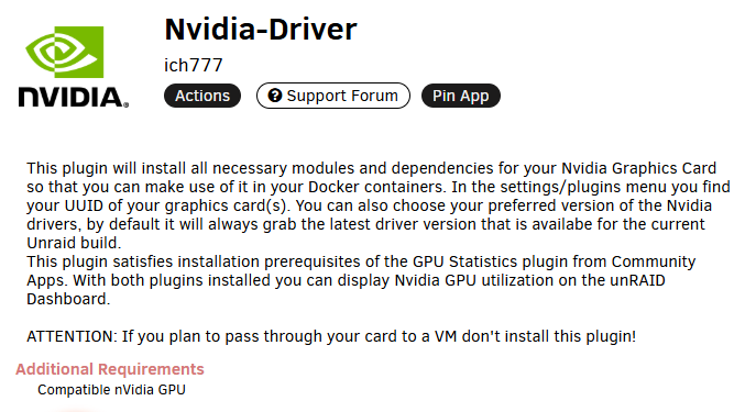

? to use g cards sometimes a driver is needed and 3rd party applications installed for its use. installed from the Community app store in the web ui on latest stable OS.
Due to teh G-cards age, for nvidia you may need to install the older driver:
select v470 update and downlaod and then reboot unraid.
