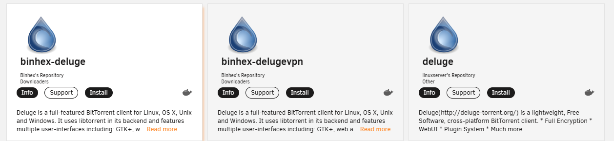

which docker image did your run for deluge?
*ask on their support form...
As I'm not sure if you did a true uninstall and reinstall. as their are quite a few steps.
1 delete docker (with checkmark to delete image!)
2. add container, hit the x to remove the template.
3. Web terminal cd /mnt/user/appdata and remove the deluge folder and any other docker folders configurations...
4. CA store and install...
