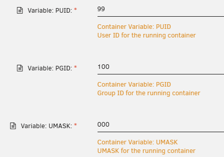

Check Plex Container Permissions
Docker containers operate in isolated environments, and Plex's ability to interact with your file system depends on the PUID (user ID) and PGID (group ID) set for the container.
Go to the Docker tab in the Unraid web UI.
Click Edit on your Plex container.
Locate the fields for PUID and PGID.
Match these values to a user on your Unraid server who has write permissions for your media shares:
Default Unraid root user: PUID=0 and PGID=0 (not recommended for security reasons).
For better practice, create a dedicated user with appropriate permissions for managing Plex and media.
add theses or update them to use these docker variable:

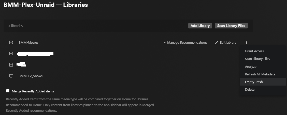

To force Plex to re-scan:
In the Plex Web UI, go to the relevant library.
Select Manage → Advanced → Empty Trash.
Run a full library scan.

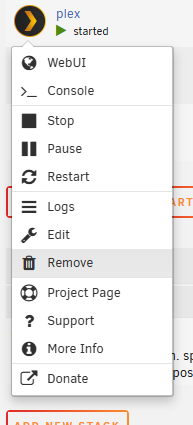

Web UI >  Dockers:
click add container:
template drop down:
hit the x:
this removes unraid side stuff... now
we need to delete the appdata folder to reinstall and start over:

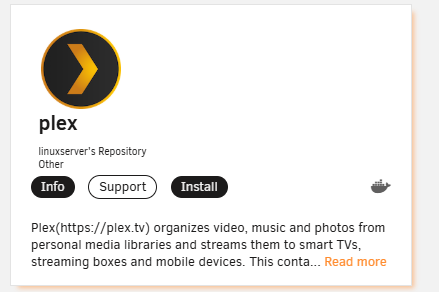

with this gone we are ready for a default install:
install: unraid template:

if you show more setting you wil see that linux IO has already addded the puid/pguid/umask:

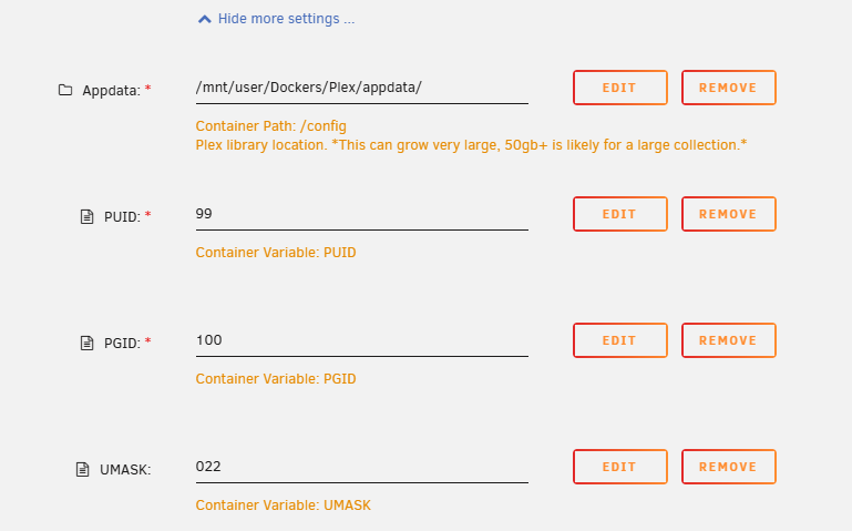

IMO with unraid, you really don't have to worry about much linux stuff unless you want to really get into it for some super custom stuff. Linux is really optional when in comes to setting up and using Unraid.
With that said, try this: Go to the "Tools" page on your unraid dashboard, there should be an option called "Docker Safe New Perms," click on it, click the checkbox, and run it.
This will set the correct permissions for all files and directories. Hopefully this fixes your plex media deletion issue. You should be able to delete the media off your NAS through the plex docker. Im honestly surprised it isn't deleting.
The only other thing I can think of is the mountpoint for your media is set to "read only" instead of "read/write." To check this, click on plex docker, hit the edit button to open the docker configuration page and make sure the Access Mode is set to read/write
