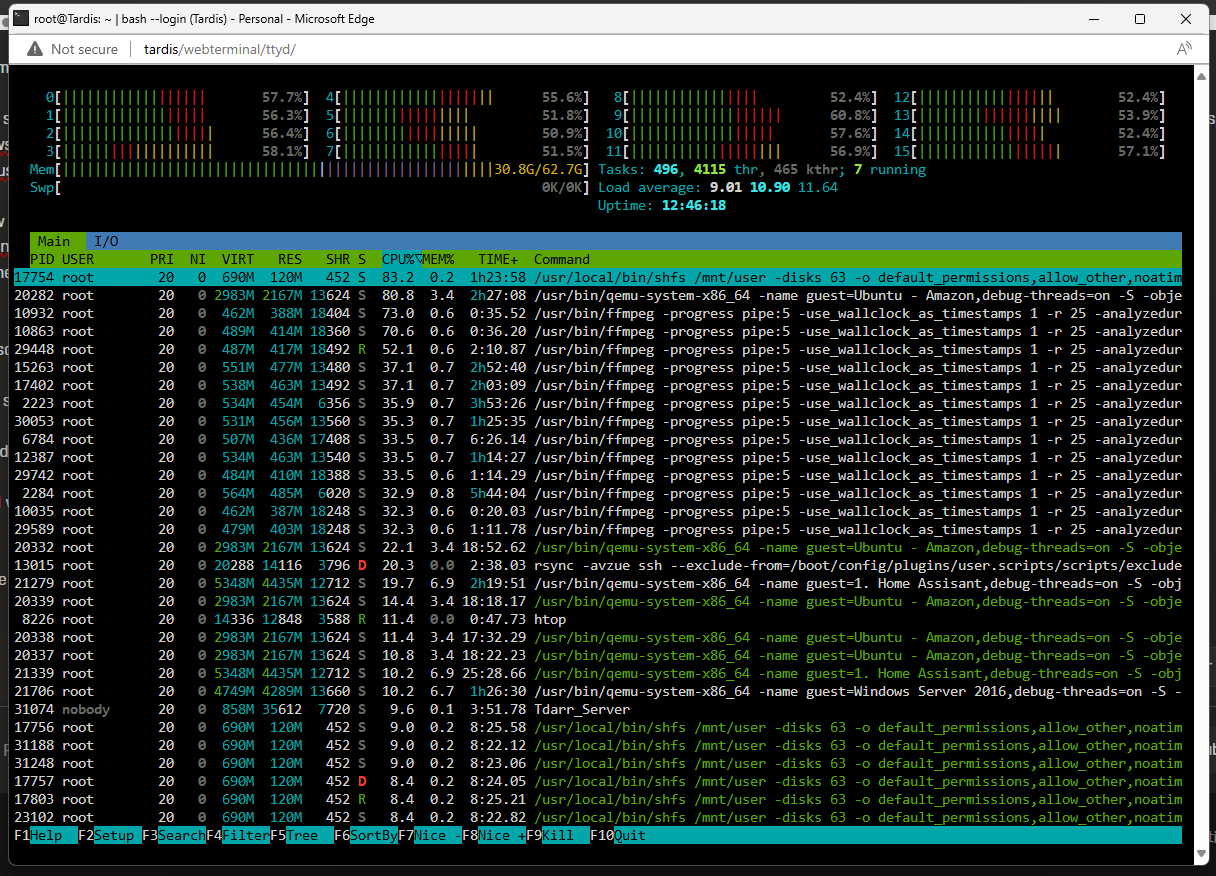

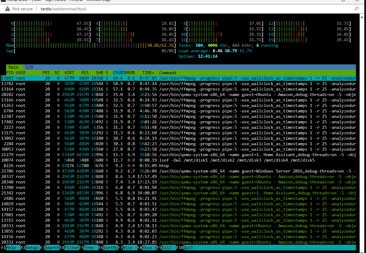

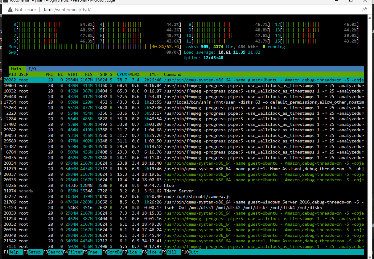

here is a screen capture currently  as i rysnc
i took 3 screen shots of the htop
does it show anything it doesnt help me see  i wish it showed like  Windows Task manager  but i guess its the best

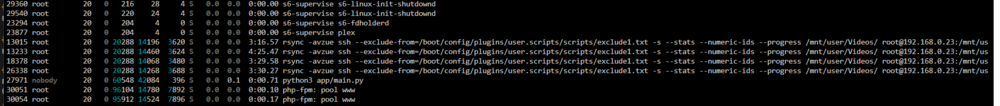

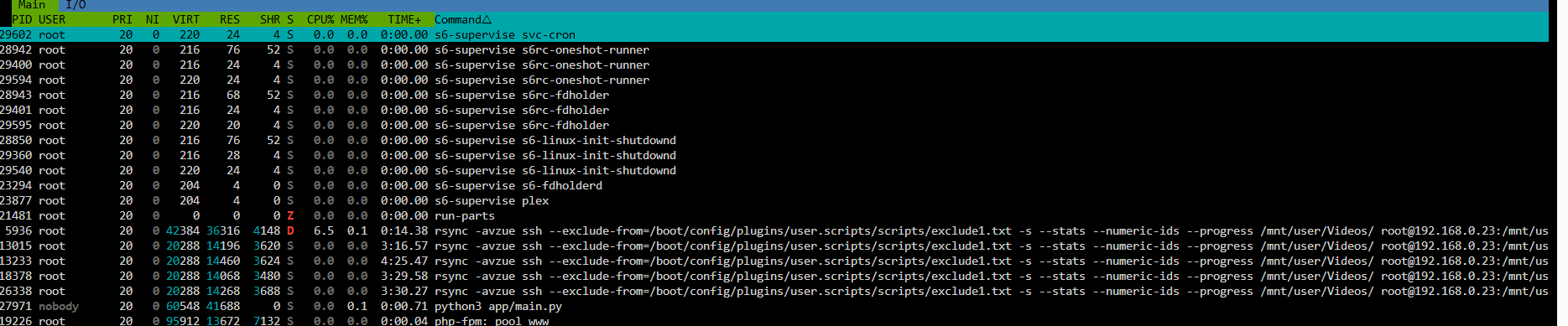

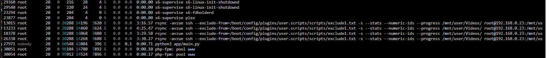

so rsync shut down paused whatever you wanna call it. i have the htop running
i was able to sort and scroll it looks like rsync is inthere multiple times   i guess each time it crashes and i re run
and they go idle
here is screen shot
somestimes the red D turns to a green R  whatever D and R mean
Edited by comet424

WOW! more then 80% of your ram is in use wow... This could be a reason why the kils and failures as rsync is ram intensive like unraid the data is sent to ram for processing...
Your htop done't help much as there to much variable... when i last looked it was more networking failure and remote rsync that was the problem... untill you fix the networking issue this is going to keep happening...

htop is essential window task manger... you can see the performance at the top the details of application listed and use the search/and other items to edit stuff...
