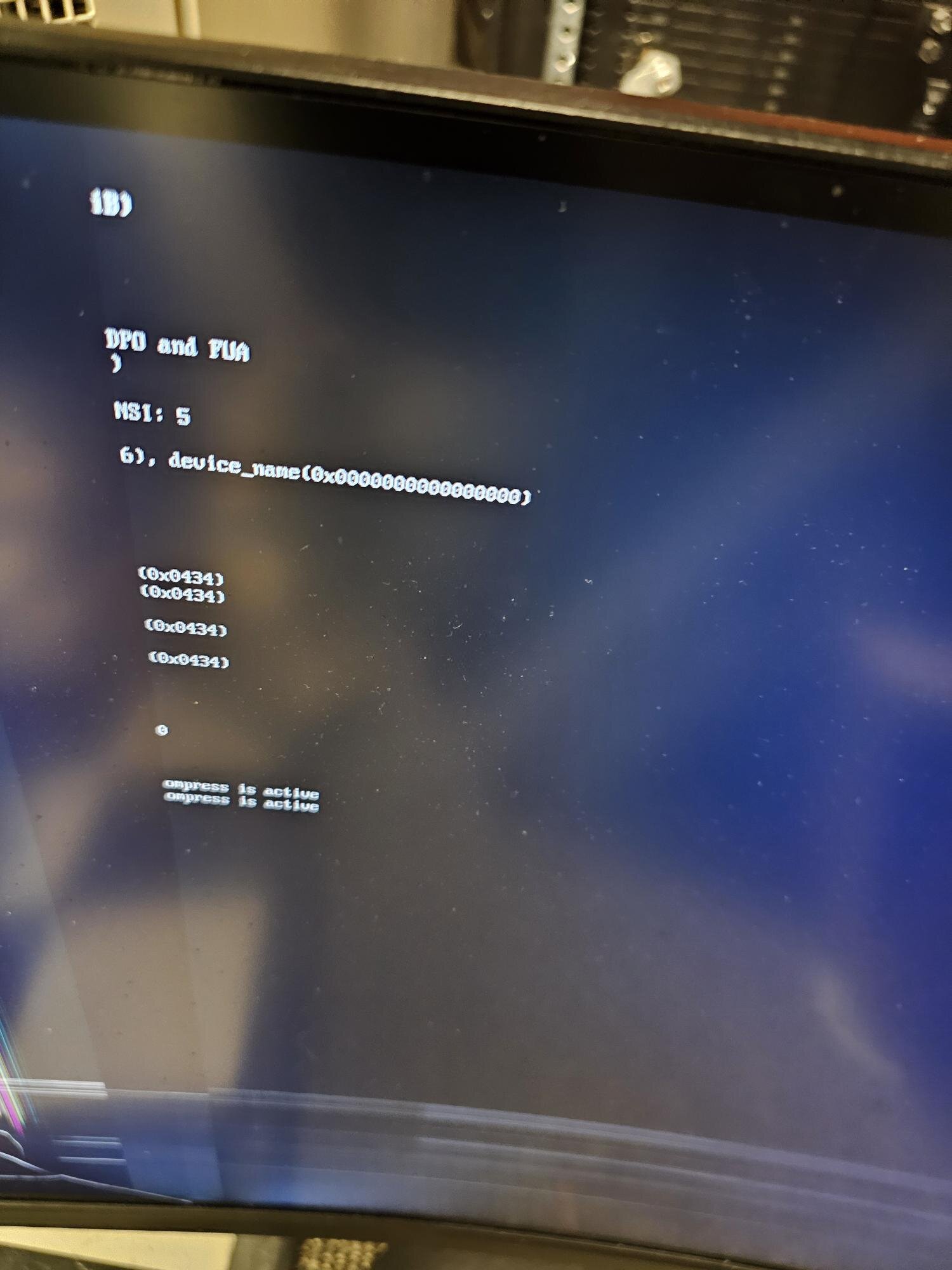

Hopefully you can assist with this problem. We shutdown our docker and vm manager and made a network change.
We added Ip address to another interface and applied change but the server locked up when we did this.
We were running for current beta. When we plug a monitor in this is what we see. We tried to reboot and same effect.
Would anyone have any suggestions on how to fix
