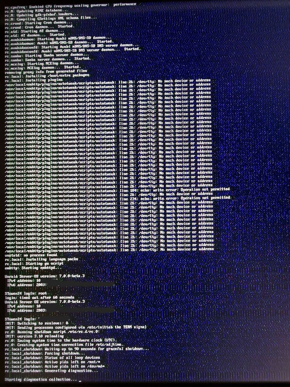

I've been hard resetting the system. One time, however, I checked in via HDMI and saw the console was still up and blinking. While I couldn't log in, it would show that it was trying to shut down when I pressed the power button correctly. That one time I left it to shut down on its own. It was stuck on `Generating diagnostics` and then later on `Starting diagnostics collection...` for multiple hours until finally having turned off sometime in the night.
Diagnostics and screenshot of that time are attached (the image errors on the screenshot are due to my monitor, not the server).

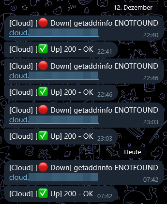

This points at some Docker container using up too many resources or potentially causing I/O wait, which, depending on the severity, would lock up the system for minutes or hours before. Now, three days by no means indicate that I am in the clear, but it definitely is a milestone. Especially considering that my monitoring tools (Uptime Kuma) reported fewer lockups than before and all of them shorter than 60 seconds where before they would be 10-20 minutes long (or longer, but if by that point the server got locked up, monitoring would stop too which has not happened again so far).
These are sub-60s timeouts on my Nextcloud server. These usually aren't noticeable, as they quickly resolve themselves without the user encountering a 504 error.

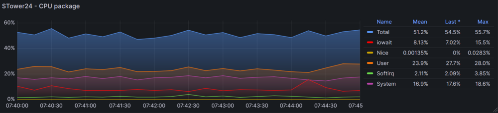

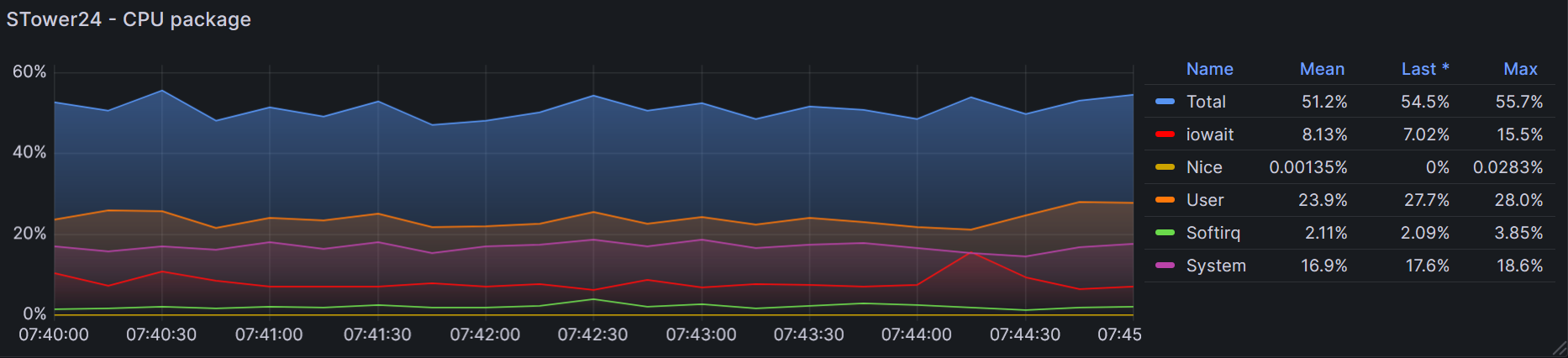

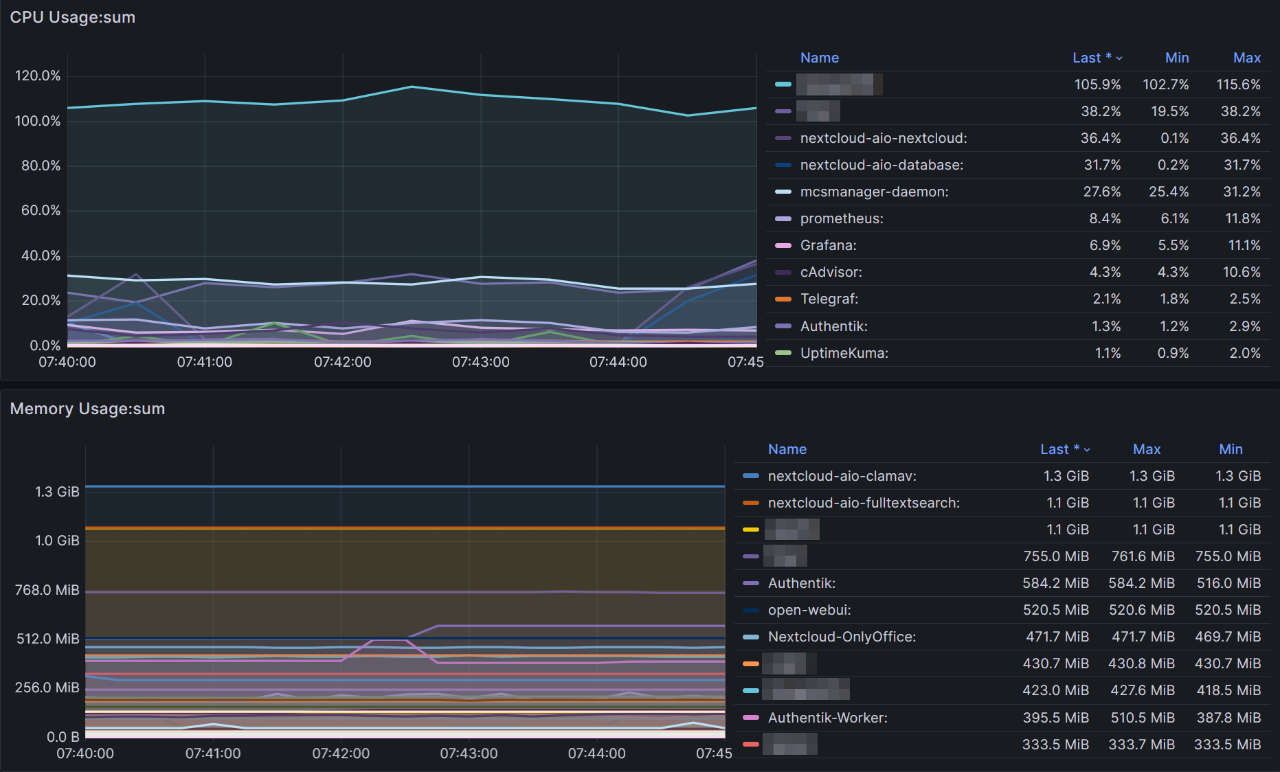

Looking at the time around 7:42 today that had such a lockup, I am not able to see anything out of the ordinary in Grafana, hinting at Nextcloud being the issue; however, this wouldn't explain why other services sometimes are impacted too.
I/O wait is not especially high. Overall, the highest I've seen is 24% over the past three days.

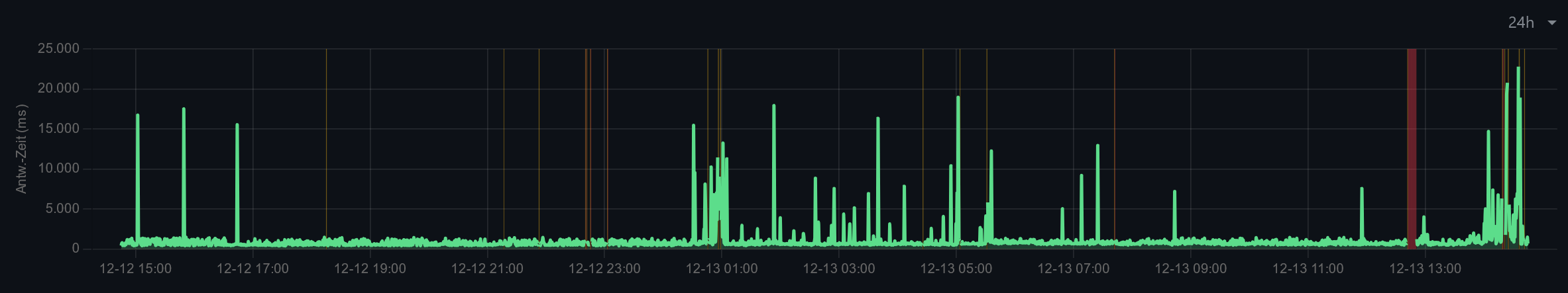

Uptime Kuma, running on a secondary system now, reports numerous timeouts but ultimately only rare 60s-downtimes. Again, my main instance that only warns after downtimes of 300 seconds did not respond a single time the past days, where before it would regularly report timeouts across almost all of my services.

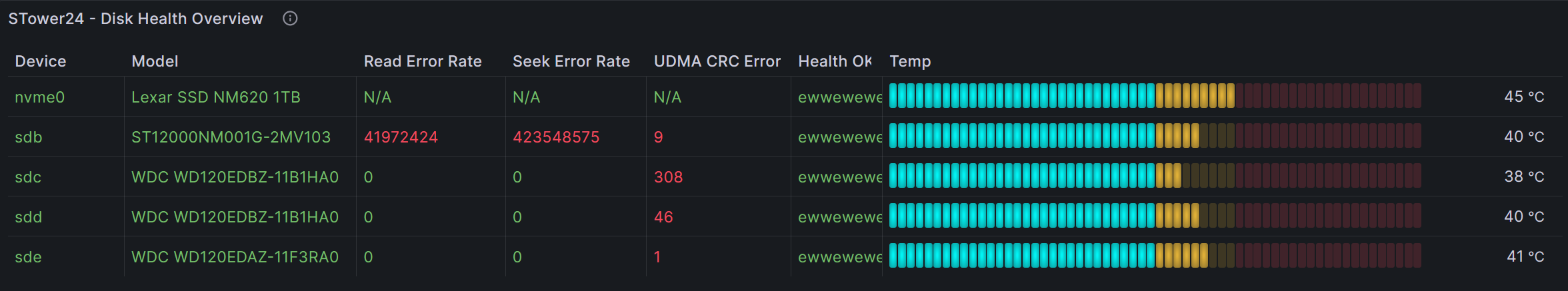

A hardware issue definetely isn't out of the question. I'll leave the server running like this for a little longer to potentially find out whether it is some container or other service causing CPU usage or I/O wait. Next step would be swapping out the mainboard. After that, potentially the parity drive, as it has a read and write error rate in the millions. `sdc`, which previously threw a lot of UDMA CRC errors seems to have calmed down now with me having reseated all cables again. SMART tests pass. I'm monitoring it. In theory, it's the youngest drive in my server at 3 years power-on-time.
Had a lockup shortly after making this post. I've removed my parity disk since then and have had no issues for four days (let's see if that holds). For now, I'm keeping most frequently served data on the former parity HDD which I've added as a second cache pool and back that up using the Mover Tuning plugin, as well as Borgbackup for things such as Nextcloud.
