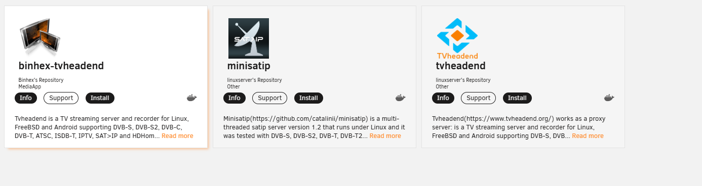

it can be worked around. Usually with something like tv head end to see and grab the channel and then re-add it via xml playlist via xtevia or another application to stream the antenna channel into plex...
Its a big undertaking to atempt and go through. Plex really isn't the best place for that...
It also comes down to what your trying to do with the antenna. Do you just need a player? are you trying to use an over-the-air antenna to watch?
Like why intergrate into plex at all? Many side solution exsit..
