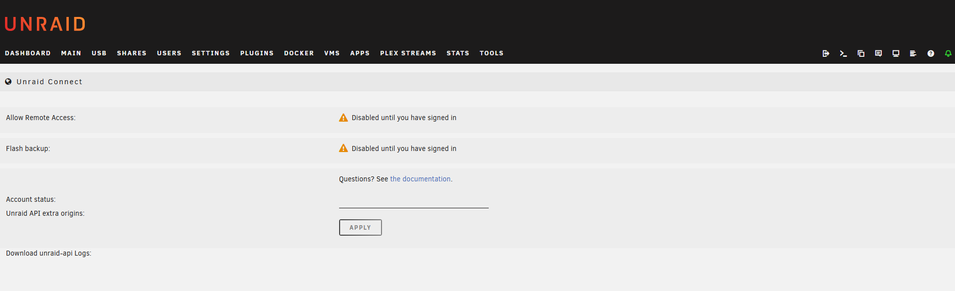

Basically, I am missing the unraid connect plugin dropdown menu. Cant do anything with the plugin. Any idea?

I can access the plugin but I have no way of logging in.

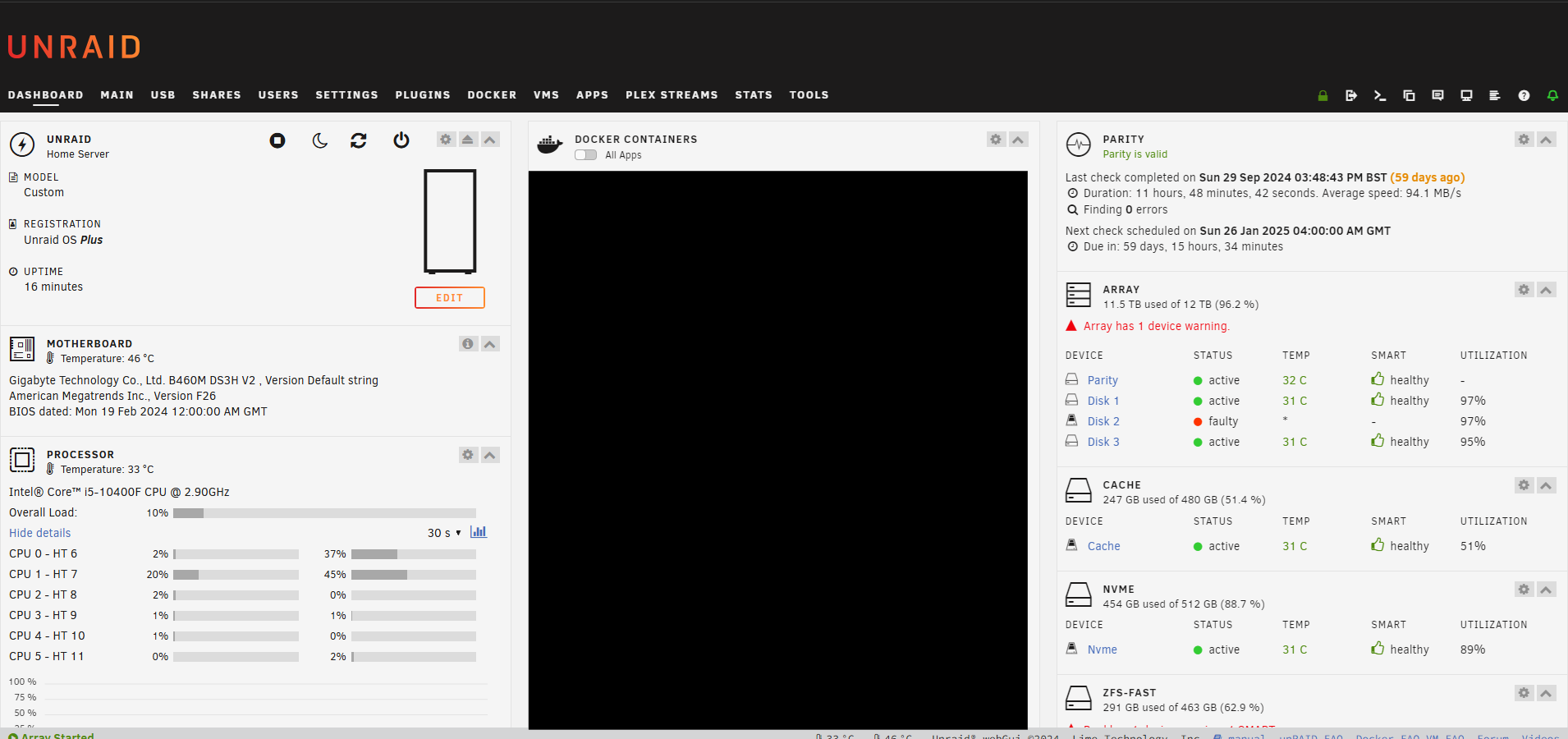

You're missing the whole top right section, try rebooting in safe mode and see if it comes back. If so remove plugins that affect the UI like Plex Streams, one may be buggy.

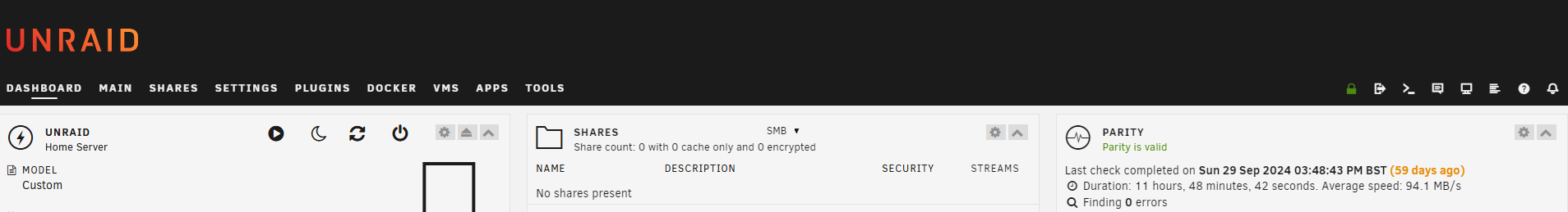

God damn it. Its working fine on other browsers.
It is something related to my chrome account. Some plugin maybe. I did format my computer and the issue is still present on chrome. Even on a different computer, using my chrome account makes the connect menu go away.

Yeah most likely a Chrome extension, once you log in it'll reinstall all those you had. If there's any ad/script blocker disable them for unraid pages.
