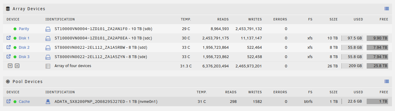

My array is as follows:
Should be plenty of space on each individual disk, the array, and the cache pool.

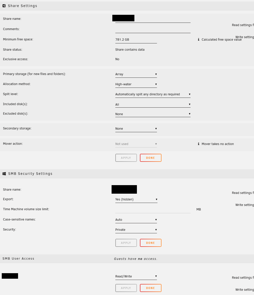

My share settings (on the only share I've made myself) are like so:

So it'd seem like it's being treated as a roughly ~125GB space.
All the other threads I saw about this seemed to either be much closer to full, or had the minimum free space set to a teeny tiny value, but neither of these is true here. There should be plenty of space everywhere, and the minimum free space is around 6x the data being transferred, let alone the individual files (largest I can see is 26GB).

Reduce that on each share to something more reasonable like twice the size of the biggest file you expect to transfer to the share, 100GB probably a good starting point.
Went with 146GB, about 2x the size of the biggest file I have on the old device I'm trying to evacuate. Set that, hit apply, still getting the same error when I try to transfer.
Try it without the share being 'hidden'.   (I seem to recall that there have been other users with issues when using hidden shares.)
What's the share name?
Gave it a bash, set to just Yes and hit apply, no change.

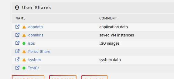

The one that's acting up is Perus-Share. I did actually make a new share called Test01, which has the exact same settings, and that one seems to be working just fine... WEIRD.
EDIT: Interestingly the first share that's acting up is also not showing up as protected in the shares view, but the newer one is...

Pesus-Share has files on cache, that should not make a different for this issue, but move them to the array and retest.
